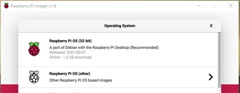

  1. We're going to install Raspbian OS Lite
  2. Configure CUPS and install a printer
  3. Configure SAMBA
Each step is easy and the configurations are very straightforward and fast.
Raspberry PI
First, let's install the Raspberry PI Zero W.

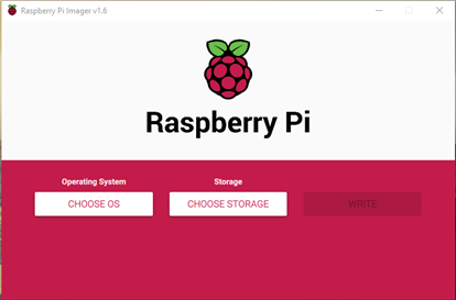

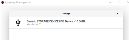

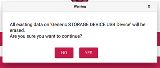

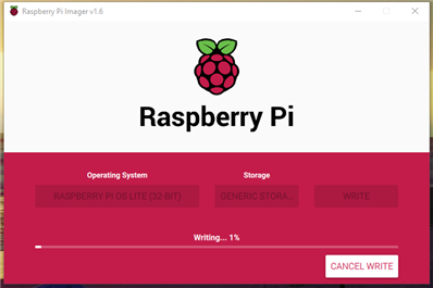

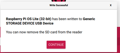

A 8GB SD CARD is enough. I use the Raspberry PI Imager. It's fast and there's no need to download the img file. Also, it downloads the latest version available.

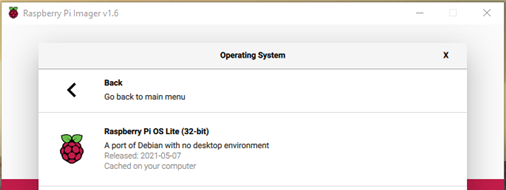

For this, the Raspberry PI OS Lite is enough.  Let's choose it - Second option (Other) - Raspberry PI OS Lite
Next, you should insert the SD Card in the reader and choose it.
REMEMBER: All that it's inside, will be destroyed !
And next, press WRITE and wait
and done.

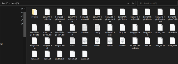

Headless setup
We can now perform a what's called a headless setup. We don't need a mouse, keyboard or monitor to be able to remotely access the Raspberry PI .
Using Windows, Mac or Linux, you now have a new partition (or drive letter) in your file manager - remove the SD card and insert it again if nothing shows up - it's the boot partition.
This is it on Windows

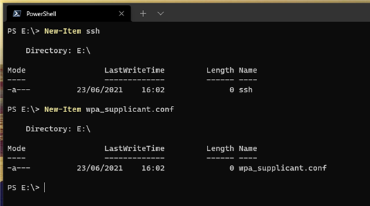

We will now create two files here: ssh and wpa_supplicant.conf .
If you are in Windows, with Powershell just execute New-Item .
With Linux or Mac, just use the touch command (assuming your current location is the boot partition)
touch ssh
touch wpa_supplicant.conf
The ssh file can stay with 0 bytes - when booting, the Raspberry PI OS will, if the file is present, enable the ssh service
For the wpa_supplicant, we need to create some configuration. Just edit the file with your favorite editor and put the following lines in it:
vi wpa_supplicant.conf

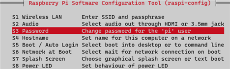

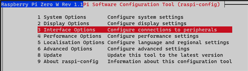

The default password is raspberry. You SHOULD CHANGE IT :
passwd
or
sudo raspi-config
Options 1 and S3

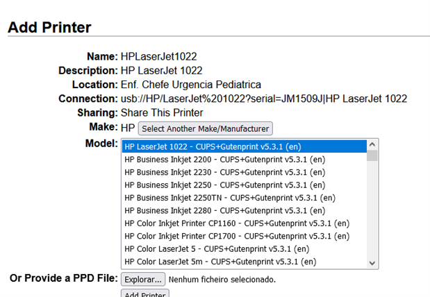

Add a printer to cups
This is the normal procedure - add a printer to cups on any Linux, using the CUPS Web Interface.

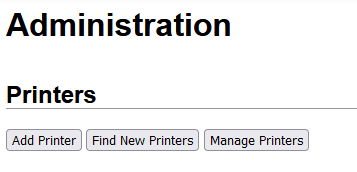

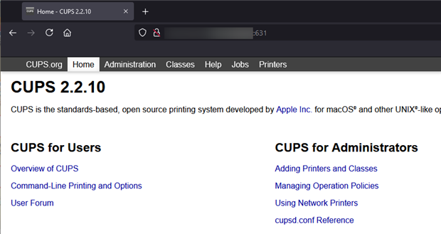

Open your browser of choice and head to:
https://<your_pi_address/name>:631 and you will land at CUPS web

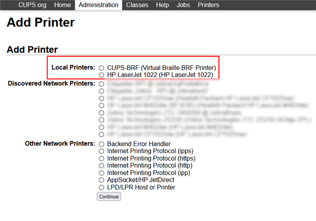

On CUPS Administration, press the "Add Printer" button

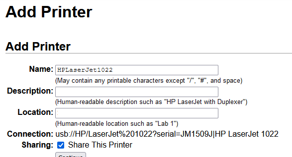

On the Printers list, we want the Local Printers - connected to USB. Choose the one you're connecting. In my case, a HP LajserJet 1022 - old, I know.
Fill in all the details. The name is specially important, since it's by it we will reach the printer. My advice is DO NOT USE SPACES.
Don't forget to tick the "Share This Printer" box.

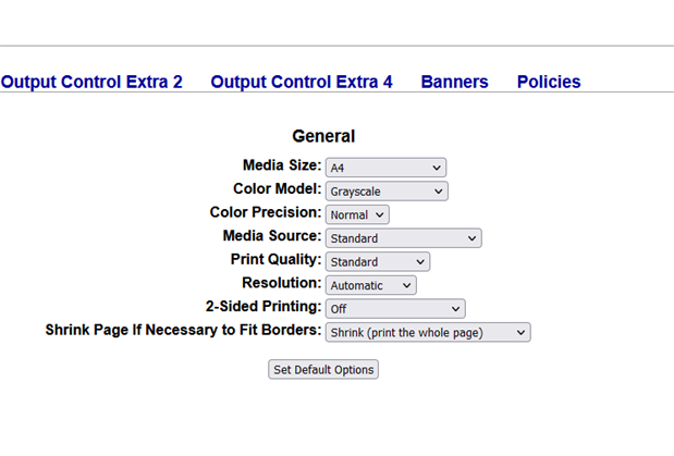

On the next screen, choose the drivers
To terminate, just set the default options for the printer and you are ready. Options may vary according to printers and drivers.

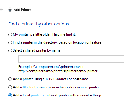

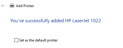

Let's add the printer to Windows

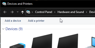

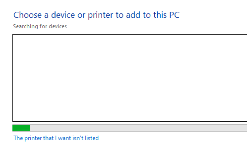

Go to Control Panel -> Devices and Printers and press the "Add a printer" button.
In the next screen you'll see some printers available. Just press "The printer that I want isn't listed".
In the next screen, we have two options to add the printer connected to the Raspberry PI.
We can use the third option - "Select a shared printer by name" or the last one - "Add a local printer or network printer with manual settings".
Both will be using the same parameters and the same printer path, the former with less steps. The main difference between them is that, using the third option - Select a shared printer by name - will not allow you to change the printer's name.
When using the third option, on the final screen - you can't change the printer's name.

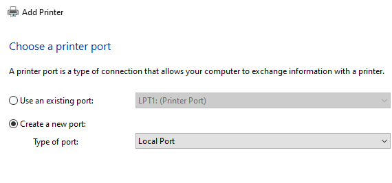

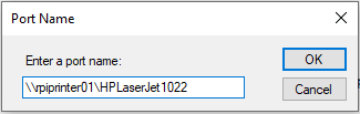

Let's continue by choosing the last option.  Create a new port with Local Port as the type of port
Now, enter the path to the printer.
The path is: \\<raspberry_pi_IP_OR_DNS>\<printer_name>

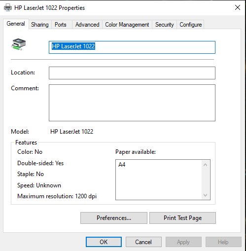

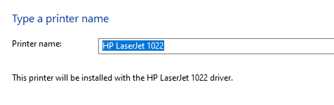

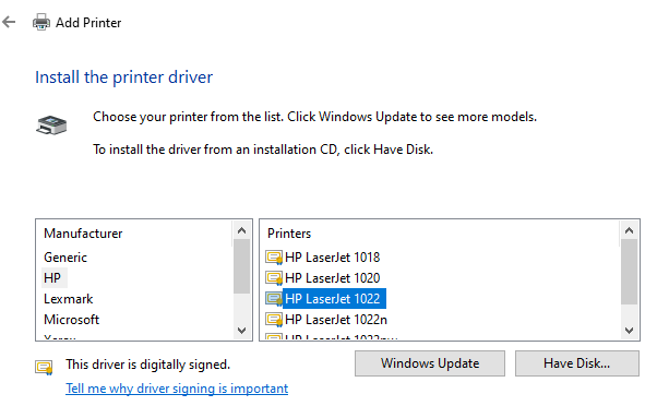

Next, Windows will ask you to select a driver for the printer.

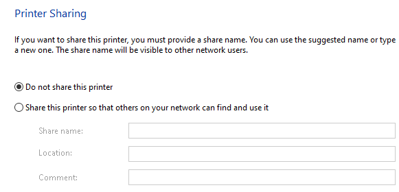

On the next screen, choose a name for the printer
Now you have the option to share the printer - you can shared it if you like or need.

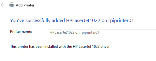

Final screen.
As you can see, all the options are the same as if a local printer is installed.
