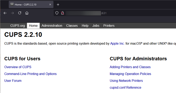

This is the normal procedure - add a printer to cups on any Linux, using the CUPS Web Interface.
Open your browser of choice and head to:
https://<your_pi_address/name>:631 and you will land at CUPS web

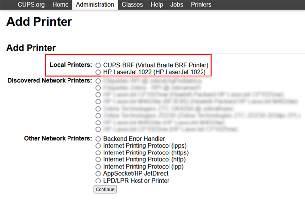

On CUPS Administration, press the "Add Printer" button
On the Printers list, we want the Local Printers - connected to USB. Choose the one you're connecting. In my case, a HP LajserJet 1022 - old, I know.
Fill in all the details. The name is specially important, since it's by it we will reach the printer. My advice is DO NOT USE SPACES.
Don't forget to tick the "Share This Printer" box.
