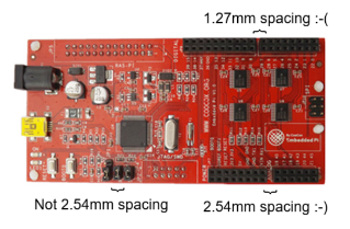

This CooCox board was OK, it had an STM32F103RBT6 MCU (ArmTm CortexTm M3 core) running at 72MHz, 128KB flash, 20KB SRAM (perhaps rather small for a 32-bit MCU), 12-bit ADCs, a JTAG/SWD debug port and 5V-tolerant inputs. It has (almost) standard Arduino headers, plus a set of parallel "EPI Extension Interface" headers that provide access to many of the other STM32F103 chip's pins.
Another [what I first thought was a] nice feature is that the header pins can be either 5V or 3.3V - jumper selectable, thanks to four TXS0108E bi-directional level shifters. But there's a problem with the 3.3V supply current, see The 3.3V Power Problem, so it can really only be used with 5V shields and modules. But that's OK - a 3.3V MCU running 5V shields is also nice.
It has up to 10 x 12-bit analogue inputs (rather low impedance though). Two or three UART ports. The USB can be run as a USB CDC port (looks like a serial port to Windows). The two I²C ports run happily at 1MHz. Two SPI ports are available. Plus a CAN bus which I have not messed with yet.
The board doesn't actually have an "Embedded Raspberry Pi", you have to buy that separately and connect it to the "Pi Connector" (JP5).

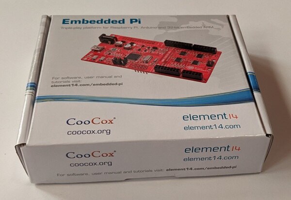

The innocent victim, still in his box.
<watch out! you may be misgendering this board - ed>
<sorry, but the last three letters of the board's name sound rather masculine to me - matt>

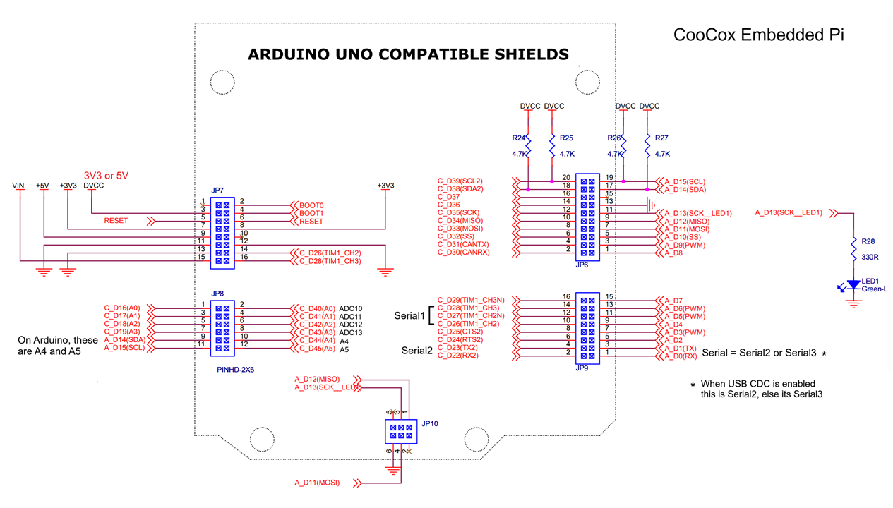

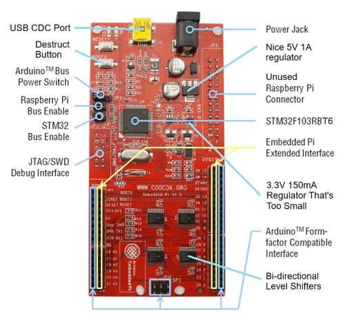

Pinouts
The outer pins (odd numbers) are the Arduino compatible pins.
<some numbers are 'odd'? isn't that discrimination? - ed>
The inner pins (even numbers) are the 'EPI Extended Interface' for connection to most of the remaining STM32 pins, so you have access to the additional serial ports, SPI, I²C, CAN, more analogue inputs and digital I/Os.
<i noticed that you didn't comment about 'even' numbers, that could be discrimination too - matt>
<ok, but i'm not going to define what a prime number is - ed>
The jumpers R (JP3) and S (JP4) select whether the Raspberry Pi or the STM32 controls the Arduino pins - but we will always use the "STM32 Standalone Mode" so the Raspberry Pi connector is not used, see Jumpers on the Embedded Pi board. This is a bit confusing, so for homework please study Sheet 3 of the schematic and the User Manual section 4 "Operation Modes" - there will be a written test on Monday morning.
I added some annotation for the serial ports - they change according to the USB configuration. The Arduino A4 and A5 analogue outputs are hard-wired to SDA and SCL (I2C1), but the standard Arduino A4 and A5 outputs are available on JP8 pins 10 and 12, and ADC10..13 are also on JP8. Note that D13 is either SCK or the on-board LED, so you can't use the LED if you're using SPI - but that's the same as the Arduino.
Note that the board has 4.7K pull-ups on the I²C SDA and SCL, so you don't need to fit them.
Here's the full schematic of the board
Embedded+Pi+Schematic.pdf

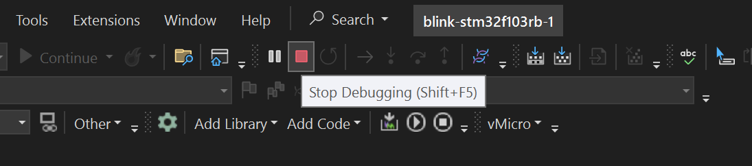

I've been using Microsoft Visual Studio (MSVS) for desktop application development almost since it was first released. And now you can use it for embedded development too. In truth, I only use about 20% of its features. Some may say that MSVS is even more complex than Cube or Code, but for me its user-interface is more intuitive. It's more like a Windows program than a ported Linux or Mac application. And the 'OK' and 'Cancel' buttons are in the right places!
<that's a bit controversial too - ed>
MSVS is available as a free version called "Visual Studio 2022 Community Edition".
<it's now 2025, why are they still calling it MSVS 2022? - ed>
<i'll ask bill, but he's still not talking to me after that crazy party... - matt>
I know some people (like me) have a dim view of Microsoft (and Bill, especially after that party), but despite that I still think MSVS is the best development environment. I can use the same IDE to develop an entire project - the MCU embedded code (in C++ and assembler), the Windows desktop application code (usually in C#), and even the code for an associated mobile phone app - all in the same 'Solution'.

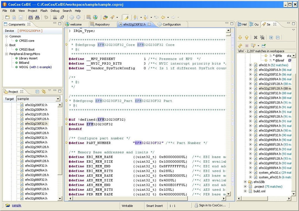

CooCox had their own Eclipse-based IDE for programming the Embedded Pi and other boards, called CoIDE. This looked quite nice, but you can't download it from the official website any more.
<phew! my hard drive is already nearly full - ed>

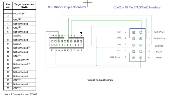

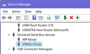

Using an ST-LINK/V2 programmer for downloading and debugging
I don't think the Embedded Pi had a bootloader or ISP support (In-System Programming) via USB. The USB port was not registered by Windows when I connected it to the PC, and the BOOT button didn't seem to do anything. I think it's geared up to get its program from the Raspberry Pi by ISP over the Pi connector's serial port or the ICSP (JP10). I have no idea what was running on the board when I received it.
The Embedded Pi has a nice 10-pin JTAG/SWD connector (JP4) with SWD (Serial Wire Debugger) enabled by default. JTAG can be selected via solder bridge SJ1, but I stuck with SWD which has great debugging support too.
In my garage <don't you mean that dusty cardboard box under your bed - ed> <how do you know about that!? - matt>, I found an old 'ST-LINK/V2 ISOL' programmer, but I could not find the cables that came with it so I had to make an adapter.
The ISOL version is nice because it is galvanically isolated from the PC, which is great for high-voltage projects. It's a shame that my brilliant Digilent Analog Discovery 2 oscilloscope was not isolated too. I once blew up the Discovery - and my laptop's USB port - when working on a 50'000V Jacob's Ladder project. Take care where you connect the probe's GND clips! (Luckily the Discovery had only blown a tiny SMD inductor on the USB port which I unsoldered and shorted out, then it worked again. But the USB port on the laptop is permanently dead.) A future project will, of course, be an isolation module for the Digilent Analog Discovery products. I've already done the design, and I have all the parts...
Here's the ST-LINK/SWD adapter circuit (I'll probably lose it and have to make another one) ...
There are many other cheaper ST-LINK/V2 adapters available which will also work, like this one which I will try out later.
<if you can find the cables - ed>

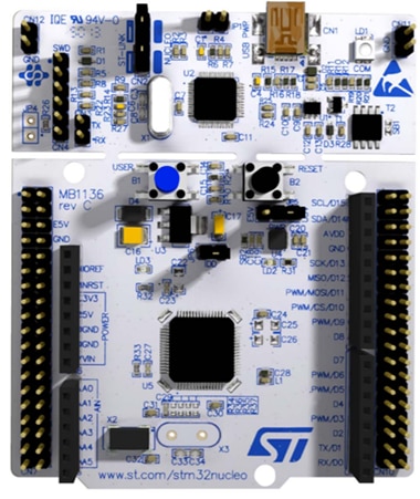

The Embedded Pi uses the same chip as the STMicroelectronics' "Nucleo-64 STM32F103RB" evaluation board, which you can pick up for less than 20 bucks! This has an integrated ST-LINK debugger/programmer, so you don't need a separate ST-LINK box. The ST-LINK part of the Nucleo can also be used stand-alone, via the SWD pin header, if you remove the jumpers on CN2 (see the User Manual PDF link below).
<maybe i should buy one of these just for the st-link bit - ed>
<yep, get 'em while you still can! - matt>
This board also has Arduino pinouts, plus all the rest of the pins too. It's very similar to the Embedded Pi board, and if you need the same chip then it's probably better to use this board - AND it has an offical STMicroelectronics "boards package" for the Arduino too, so it's very easy to use.
Another nice thing about this Nucleo board is that the Arduino pins on CN10 are evenly spaced (2.54mm), unlike the Arduino pins on CN5 - see the Infamous Arduino connector offset problem below.
https://www.st.com/resource/en/user_manual/um1724-stm32-nucleo64-boards-mb1136-stmicroelectronics.pdf
https://www.st.com/en/evaluation-tools/nucleo-f103rb.html

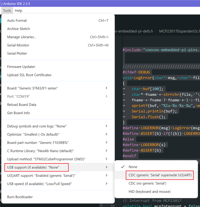

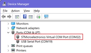

With Arduino programs it is common to send debug information to the 'Serial' output using Serial.print() etc, so it is displayed in the Arduino IDE's 'Cereal Monitor' window. If you configure the Embedded Pi to use USB CDC, see Serial and USB Ports, then you will see the USB port as a serial port in Window's 'Device Manager', 'Ports (COM and LPT)' group. You can then select this port in the Arduino IDE and you'll see the debug output in the 'Surreal Monitor'.
<i like it - this 'surreal monitor' idea could be a big hit! - ed>
If the USB is not configured, you will need a 'Serial to USB Converter' (3.3V version!) to convert the Embedded Pi's 3.3V serial output to USB. I use the FTDI 'TTL-232R-3V3', but there are many other similar products available.
https://ftdichip.com/products/ttl-232r-3v3/
Connect the RX pin of the adapter to the Arduino's TX pin on the Embedded Pi, JP9 pin 3. They use the right terminology - yeah!
<that could be controversial too - ed>
<huh? you connect an output (TX) to an input (RX), never RX to RX just because they have the same name, how many moonshots were lost just because of this simple error? - matt>
If using the USB to power the board, this is the only pin you need to connect - the GND goes via the USB. But if not using the USB, you will also need to connect the GND pin.
The example code in 'coocox-1.ino' uses 'Serial' for runtime logging and error messages, so you will need the 'Serial' port. Note that 'Serial' may be #defined as 'Serial1' or 'Serial2', using different pins, depending on your configuration. The example also contains the macros that I use for runtime testing, LOGERROR(), ASSERT() etc.
I usually use PuTTY to display serial data. It's much more versatile than Arduino's 'Serial Monitor', and the carriage return (\r) actually works. Arduino's 'Serial Monitor' treats carriage return as a line feed, which is VERY annoying. It means you cannot display changing data on one line because it scrolls up every time to write to it! That's something they should fix. And there's no 'clear screen' escape sequence either, but PuTTY has it.

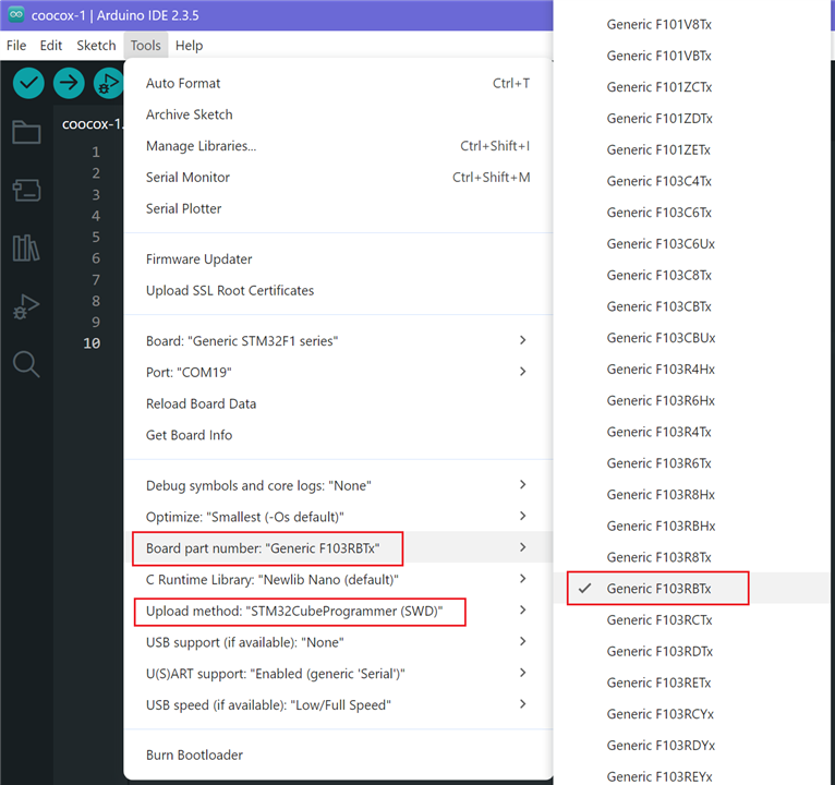

Steps to get the CooCox Embedded Pi board working with the Arduino IDE
Just follow these steps...

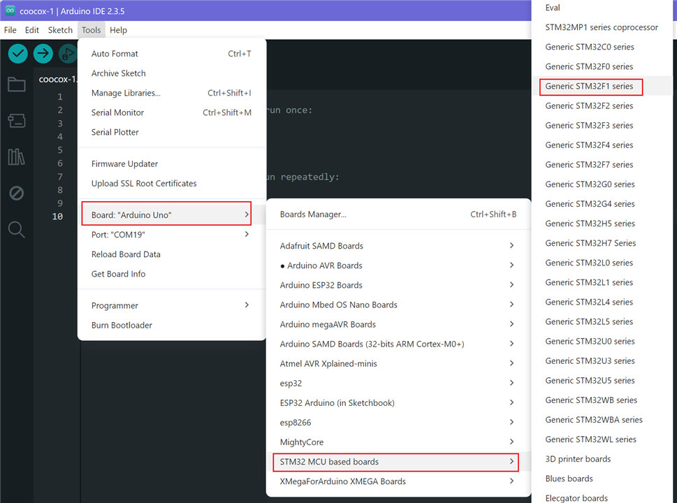

There is no Arduino "board package" available for the CooCox Embedded Pi. But STMicroelectronics has a board package that covers all their STM32 MCUs. This has a "Generic STM32F1 Series" board, with a whole set of variants which includes the "Generic F103RBTx" MCU variant. This variant is very close to what we need for the Embedded Pi.
However, the pinouts of this "Generic F103RBTx" variant are not the same as those of the Embedded Pi, so modifications are needed.
The right way to do this would be to create a new board for the Embedded Pi, based on a reference to the "Generic STM32F103 Series" board variant "Generic F103RBTx". But after a couple of days messing about with this I was unable to get it working properly, and it's not well documented. See https://arduino.github.io/arduino-cli/1.2/platform-specification/#referencing-another-core-variant-or-tool.
If anyone has managed to do this, please let me know how! (I didn't want to use STM Cube to generate the files, as they suggest, but maybe that's what I should have done.)
So I came up with a much easier way...

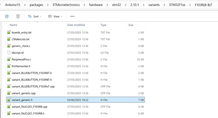

Once the STM32 board package has been installed (see Step 2 below), the library files for Arduino board variants can be found in the "variants" subdirectory of the board package. Hopefully you will find the build files for the STM32F103RBT6 MCU here (but you may have a different version number than 2.10.1)
 C:\Users\<your-user-name>\AppData\Local\Arduino15\packages\STMicroelectronics\hardware\stm32\2.10.1\variants\STM32F1xx\F103R(8-B)T\variant_generic.h
The folder also contains files for the NUCLEO_F103RB and BLUEBUTTON_F103 variants, but you can ignore those.
<that looks like a bit of a hack too - ed>

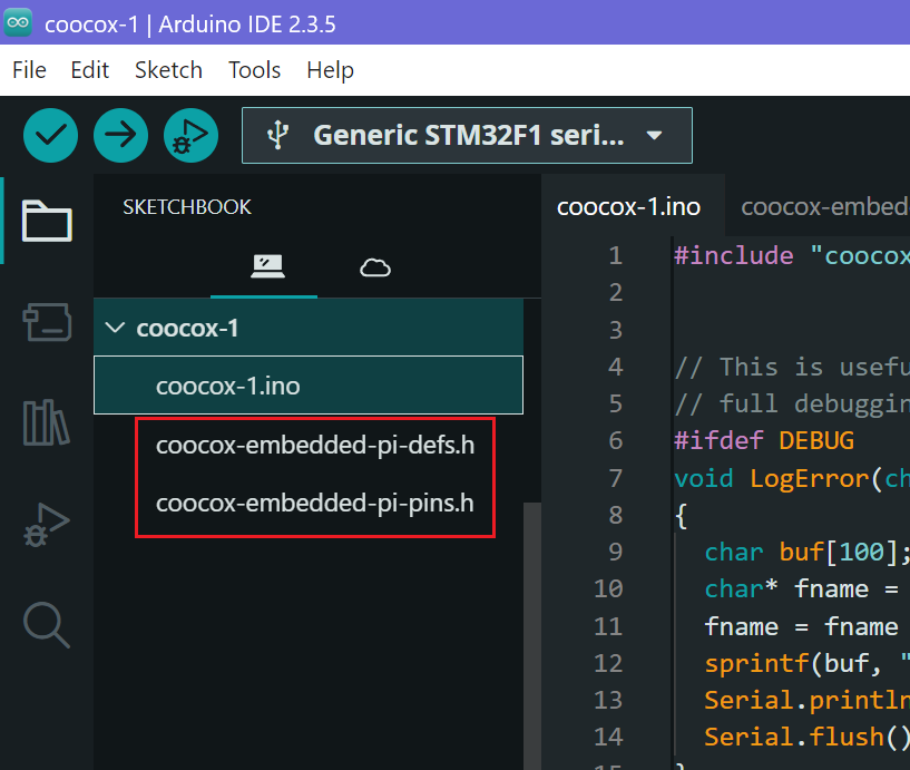

The file we need is "variant_generic.h", this contains the pin and port definitions. The relevant definitions are like this one for LED_BUILTIN, with #ifndef statements "if not defined":
  // On-board LED pin number
  #ifndef LED_BUILTIN
    #define LED_BUILTIN    PNUM_NOT_DEFINED
  #endif
This means we can pre-define them, which is exactly what we do in the coocox-embedded-pi-defs.h include file.

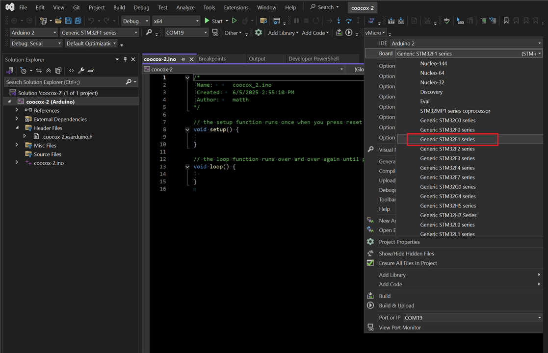

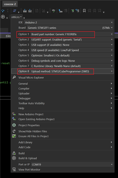

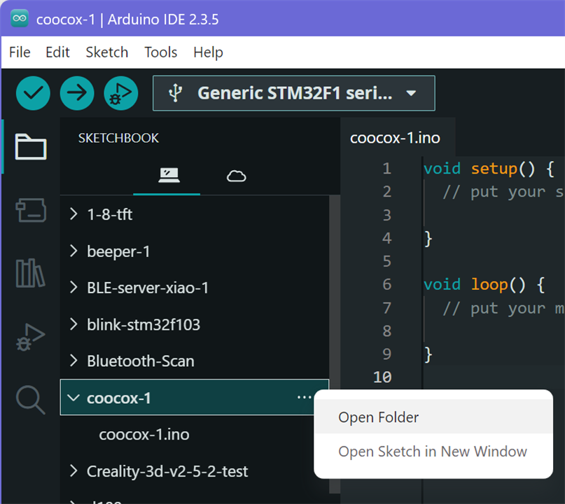

Using the Arduino IDE
If you're not familiar with the Arduino IDE, there are many excellent tutorials on the Arduino website: https://www.arduino.cc/en/Tutorial/HomePage/

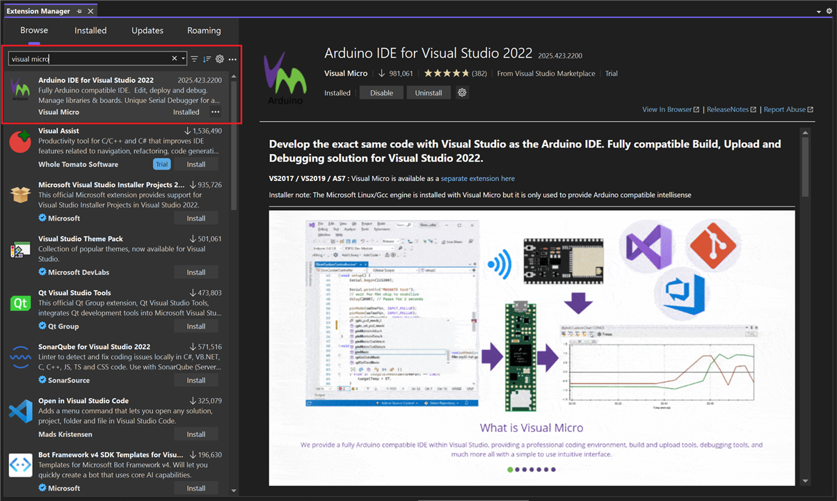

The steps are almost the same when using Microsoft Visual Studio with the Visual Micro extension, it's just the user interface that's different.
<that sounds rather suggestive, maybe tone it down a bit - ed>
1) Install the latest Arduino IDE (if you don't already have it)
https://www.arduino.cc/en/software/
2) Install the STMicroelectronics "STM32 MCU based boards" package
Each microcontroller or microcontroller (MCU) family needs different libraries to be Arduino-compatible. This is done by providing a "boards package" which contains the custom code and pin definitions for each family and each MCU.
To install a new boards package from the Arduino IDE, you need to tell it where to look. Do this by referencing the package's github json file. Add this path to the Arduino IDE's "File / Preferences... / Additional board manager URLs list"
 https://github.com/stm32duino/BoardManagerFiles/raw/main/package_stmicroelectronics_index.json
Now use the Arduino IDE's "BOARDS MANAGER" to install the "STM32 MCU based boards by STMicroelectronics" boards package.

3) Modify the "variant_generic.h" file to access the Embedded Pi include file
Once the STM32 boards package has been installed, you will find the file we must modify here (the 2.10.1 version may be different, and use your own user name):
Edit this file and add these lines at the top of the file, just after the '#pragma once' line:
  #if __has_include("coocox-embedded-pi-defs.h")
    #include "coocox-embedded-pi-defs.h"
  #endif
NOTE: You may have to re-do this if the STM32 boards package is updated or re-installed because it may overwrite the edited file. This is the only drawback with doing it this way. But you will discover this very quickly because the build will fail.
4) Connect all the hardware and check the ST-LINK/V2 adapter is working
BANG!
<isn't that a bit too much detail? - ed>
<you're right, i'll assume this step was successful to avoid possible legal complications - matt>
Connect the ST-LINK cable to JP4 and connect the ST-LINK box to the computer via USB.
With luck, you will see the ST-LINK/V2 device in the Device Manager:
Set the jumpers on the Embedded Pi - see Jumpers on the Embedded Pi board.

5) Create a new Sketch and select the board and variant
'File / New Sketch', this opens a new instance of the Arduino IDE with a default Sketch name. Do 'File / Save As...' and give it a name like 'CooCox-1'. You can close the other instances of the Arduino IDE.
Instead of using the 'Select another board and port..' option from the combobox on the title bar, I like to do this from the 'Tools' menu.
Select "STM32 MCU Boards" and choose "Generic STM32F1 Series:
Now select the variant "Generic F103RBTx", which is called the "Board part number" in the Tools menu (don't choose the F103R8Tx by mistake).
And select "STM32CubeProgrammer (SWD)" for the "Upload method".
6) Add the "coocox-embedded-pi-defs.h" and "coocox-embedded-pi-pins.h" files to the Sketch
Copy these two files into the Sketch folder. They will automatically appear in the Sketchbook's file list. You can use the "..." button and choose "Open Folder".
Right-click on the file and use 'Save link as...' to download and save each file.
NOTE! For some strange reason, if you view the text file with a left-click then you will lose your place on the page when you click the 'Back' button - it goes back to the top of the page.
<to be fixed when i have time, if i can remember the javascript - matt>
<i thought you wrote it all in coffeescript - ed>
Right-click and use 'Save link as...' to download each file: coocox-embedded-pi-defs.h coocox-embedded-pi-pins.h
Or if you just want to view the files...
Black large square   coocox-embedded-pi-defs.h   [Click to view/hide]
Black large square   coocox-embedded-pi-pins.h   [Click to view/hide]
Once the two files are added, you should see them in the IDE's Sketchbook tree...

Using the Visual Micro MSVS extension
Install the free "Microsoft Visual Studio 2022 Community Edition" from here
https://visualstudio.microsoft.com/vs/community/
To use MSVS with Arduino sketches and all the MCUs supported by the Arduino IDE, you must install the "Visual Micro" extension which gives you an environment with all the Arduino IDE features and all the MSVS features too. There is another (more expensive) extension called "Visual GDB" which you could try, but I haven't used it yet.
Visual Micro's website
https://www.visualmicro.com/
The Visual Micro extension is easily installed with the MSVS 'Extensions / Manage Extensions...' feature. Search for 'Visual Micro' and install it. After installation you will find a new 'vMicro' toolbar entry and a new 'Extensions / vMicro' menu. The menu has the same items you would see on the Arduino IDE's 'Tools' menu for the MCU, plus new entries for configuring the Visual Micro environment. I won't give a detailed description of Visual Micro because it has a great website that tells it all. So I'll mention just the bits that I find the most useful, or the most confusing.
The Visual Micro extension can be used for free for a short time (30 days?), but if you want to keep using it then you need to pay for it. It's not expensive - even I could afford it.
MSVC with Visual Micro provides a very powerful IDE, with many more features than the Arduino IDE...
Once the Visual Micro Extension has been installed using the Extension Manager
You can create a New Project and select 'Arduino Empty Project'. Call it something like 'coocox-2'.

Now select the MCU type: Open the 'vMicro' menu. You will see that the first section is the same as that on the Arduino IDE's 'Tools' menu.
Choose 'Board: Generic STM32F1 series' from the drop-down list.
Select the board and upload method, "Option 1: Board part number: Generic F103RBTx" and "Option 8: Upload method: STM32CubeProgrammer (SWD)"...

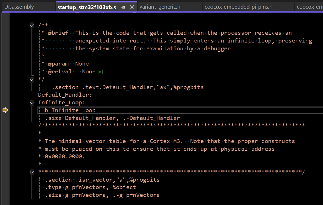

Configure the debugging from the combo-boxes, usually on the menu bars, top left. Select "Debug: Hardware", "STLINK v2 (External)" and "No optimisation" which is best for debugging. If you have your 'Serial to USB' cable connected, you can select its COM port too, so Visual Micro's Serial Monitor can be used.
Make sure the ST-LINK box is connected and the Embedded Pi has power either from the USB or the barrel jack.
Press the green triangle "Start" button to build and download the empty sketch, which should download and start running. (But it won't do anything yet.)
To stop the debug session so you can build and download again, you should always press the square 'Stop Debugging' button. If not, it will silently refuse to do the build.

The R and S jumpers (JP3 and JP4) select which signals drive the Arduino pins. There are three settings:
•R in, S out = Raspberry Pi Mode, the Arduino pins are driven by signals from the Raspberry Pi connector
•R in, S in = ST Adapter Mode,
•R out, S in = STM32 Stand Alone Mode, the STM32 drives the Arduino pins
We use "STM32 Standalone Mode", so the STM32 controls the Arduino pins directly:

The Embedded Pi has three serial ports plus the USB port which behaves like a serial port when in Communications Device Class (CDC) mode. For some reason which I have not figured out yet, if USB CDC mode is enabled, then you only have two serial ports. If not using USB CDC then there are three serial ports. I would expect it to be the other way round!
You don't have to write any code to use USB CDC, you can just enable it from the Arduino Tools menu or the MSVS vMicro menu, select "USB support > CDC (generic 'Serial' supersedes U(S)ART)".

You should see the Embedded Pi USB devices in the Windows Device Manager as "STMicroelectronics Virtual COM Port (COMxx)". You can now use this just like a standard serial port from your desktop application.
Each device has a fixed PID/VID (VID_0483 PID_5740 = STMicroelectronics Virtual COM Port, you can find this in devicehunt.com) but with a different serial number for each device (I hope). You can see this in Device Manager by right-clicking on the entry and viewing the "Properties / Details / Device Instance Path". In  our case the serial number is "6D7B539A5051".
USB\VID_0483&PID_5740\6D7B539A5051
The USB port will be 'Serial', and you also have Serial1, Serial2 and Serial3 - if you need them. You can enable/disable the ports with the definitions in 'coocox-embedded-pi-defs.h':

The Embedded Pi contains two I²C ports and two SPI ports. You can see which pins to use from the Pinouts diagram. To test these you'll need suitable modules or chips.
NOTE! If you want to use the chip's SPI2 port, then you CANNOT use the on-board LED, because LED_BUILTIN and SCK2 are on the same pin! (PB13).
<or you could use the board for target practice - ed>

Analogue inputs A0..A3 are on the usual Arduino pins.
But the Arduino A4 and A5 pins are used for the I²C port I2C1. A4 and A5 are available on the Extension Interface JP8, pins 10 and 12.
The other four analogue inputs ADC10/11/12/13 are on Extension Interface JP8, pins 2/4/6/8.

The 3.3V power problem, and non-standard use of the Arduino VIN pin
The data sheet says, "Compatible with both 5V and 3.3V ArduinoTm shields, selectable with jumpers", but this is not really true.
From the schematic diagram you can see that the 3.3V regulator is an LPC2985-33DBVR, which can supply max. 150mA.
But the STM32F103RBT6 chip itself needs up to 150mA.
This leaves nothing for 3.3V shields and peripherals!
If using 5V shields there's plenty of power from the 5V regulator, an NCP1117ST50T3G which can provide 5V at up to 1A.
So if you are using a 3.3V shield, 150mA is probably not be enough!
The board's power supply circuit is exactly the same as the Arduino Uno, even using the same two chips. But in the Uno, the 3V3 regulator only supplies the 3V3 pin and the comparator input, it was not designed to power the shields. The Uno documentation states, "the 3V3 pin can typically supply up to 50mA of current".
The original Uno schematic, the Embedded Pi's power circuit is the same

I think this is a design error.
If you need more than a few 10's of milliamps for a 3.3V shield then you will need a bigger 3.3V regulator!
The only solution is to unsolder the tiny 3.3V regulator and replace it with one that can supply up to 1A - but there's not enough space on the board for a bigger regulator.
If you're making your own Shield prototype (as I am), then you could put a new 3.3V regulator on the Shield board: Unsolder the LPC2985-33DBVR 3.3V regulator and leave the space empty. Provide a new 3.3V regulator, with its input from the +5V on JP7 pin 9 (you could also connect pins 9 and 10 together and use both), and its output connected to the two +3.3V pins 7 and 8 on JP7. But then the Embedded Pi won't work without the Shield connected.
Another way could be to connect your new 3.3V regulator to JP1. This has 5V for the regulator input and the 3.3V connection for the regulator output. You could make a small board that plugs onto JP1, with your regulator mounted on it and a new JP1 jumper... But where do you connect the GND? Damn, it won't work.

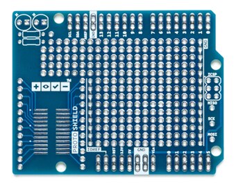

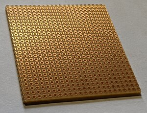

Prototype shields and the infamous Arduino connector offset problem
The most annoying thing about the Arduino is that the two larger pin-headers are not aligned on a 2.54mm (0.1 inch) grid. On the JP6 side of the Embedded Pi, pins D8..D13..SDA..SCL are on two headers which are spaced apart by 1.27mm instead of 2.54mm. The pins are therefore not aligned with the holes of a 2.5mm board, so you cannot solder pin headers onto a standard 2.54mm breadboard and plug it onto the Arduino! I presume they did this so you have to buy their proprietary Arduino prototyping boards instead of using any old 2.54mm board.
So, being Arduino compatible, the Embedded Pi has the same problem. And the jumper pins are also not aligned to 2.54mm, so you can't connect those to a 2.54mm board either.
This kind of 2.54mm drilled board cannot be used with the Arduino because the holes do not align with some of the Arduino's pins :-(
I needed a prototype board with access to all the pins, both the Arduino pins and the Embedded Pi's Extended Interface pins, and the ICSP connector too.

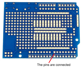

Luckily, I found that some of the Arduino shield prototype boards do have two rows of pins, and they plug perfectly onto the Embedded Pi :-)
Unfortunately, both rows of adjacent pins are connected together! :-(
All the boards I found have tracks connecting adjacent pins, but thin tracks can be cut with a knife or a Dremel rotary tool, or perhaps with a manually-controlled CNC3018 machine. The tracks are on the underside, so you won't see the cuts when it's fitted.
You should leave the 5V, 3V3 and GND pins connected, since they are also connected on the Embedded Pi board.
The official Arduino boards have thick soldered tracks, which cannot easily be cut. Do not use these!
There is another way to solve the problem. I often plug an Arduino upside-down onto pin headers on a prototype board. You can create the offset pin headers by soldering a 90º header to a standard pin header to move it by 1.27mm, as seen here...

Here's a stripped down version of what I did. It compiles without an error.
  bool func() { }
  void setup() { func(); }
  void loop { }
If you run this, it never returns from func(). The reason is that the compiler realized something was wrong and added the 'undefined' instruction udf #255 to the generated code. But why didn't it generate a build error?
I only managed to find this using MSVS's 'Disassembly' view, which shows the assembler code generated by the compiler.
<zzzz - ed>
When udf #255 executes, it ends up in the STM32's default interrupt handler, and nothing else works.
It would be hard to find this bug if you're only using Arduino Serial.print() statements. I wonder how many people have been stuck with this one?

But if I really wanted to use this [old] MCU, I'd probably go for a "Nucleo-64 STM32F103RB" evaluation board with built-in ST-LINK instead.

Microsoft Visual Studio 2022 Community Edition (MSVS)
Visual Micro Extension (download using MSVS "Extension Manager")
Visual GDB. I haven't tried it, but it looks good. Expensive though, I'll stick with Visual Micro.
