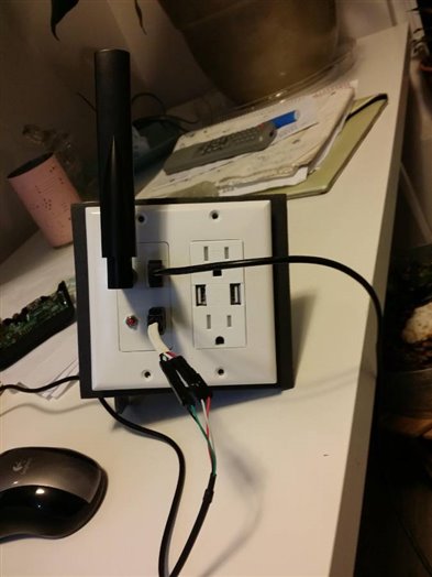

I needed to extend the wifi range of my router with a minimal footprint in my apt. I didn't want more peripherals plugged in all over my apt. I used a RPi0w for the wifi repeater and jammed it into a two gang receptacle box. Two usb ports (one is for console connection) and kill switch, or reset button in case the computer hangs. The console connection will also power the Pi in case the power goes out.
First i had to attach the antenna. I found tutorials online that looked easy enough at first but the pics were scaled about 1000% of the pi's actual size. When i looked at the board and the size of the components i had to re-solder on, i was quickly discouraged. It doesn't look the greatest, but it got it done and it works. That's what matters.

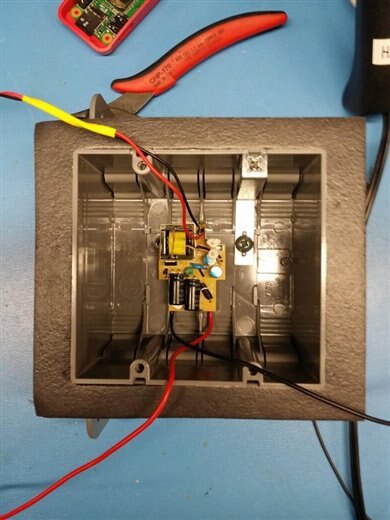

Next i cut all the cords to size then soldered on the usb, micro usb, and pinout thingy. I used shrink tube and hot glue so that no wires are exposed. I used the internal circuit from a standard 5v transformer/ regulator commonly used to recharge a cell phone to hardwire the pi to my apt. it will act the same as if i plugged it in.
I used Leviton Qickports for the wall plate. two ports i drilled holes in for both the external antenna and reset button. Got all my components together. Time to assemble.
The transformer/regulator fit in perfect. All of the pre soldering was done so at this point, it was pretty much plug and play. I taped the pi to the side, then connected all the components.
Got it all in there. Easy street!
I had to disable the bluetooth to use the uart console gpio pins. console, usb, antenna, and reset switch all work great. I'm now configuring the wifi repeater. I'm going to make sure everything works before i put it in the wall.
Other than a wifi repeater, this device doesn't have much purpose. I could connect a usb camera, or I could swap out the usb for hdmi to connect it to a tv.. i wanted to make it more than i knew what i would do with it. Does anyone have any suggestions for what else this can be used for?

    mcb1 over 8 years ago in reply to rctho
    if anything in the box fails i would have to open it up to service or repair it which I am trying to avoid but will be inevitable.
    I'm curious if there is a box that is half the size, and have two side by side.
    The other option could be to make an enclosure that slips inside which holds the electronics, or at least the Pi which leaves the power supply in with the 110v/220v.
    Don't be concerned about the 220v.
    Here in NZ we have three phase, and it's 400v between the phases.
    It's only an issue when you have two seperate lighting circuits (on different phases) arriving into the same switch outlet .....
    rctho
    It's a great concept and an interesting way to extend your Wifi.
    My only concern is the mixing of mains and low voltage equipment within the same housing.
    In some countries there is a physical speration required, and some additional protection to ensure the low voltage wiring is isolated.
    (ie a plastic spacer between the main and low voltage side).
    Since the forum is global the electrical laws in one country may not be suitable for others, so a warning might be worth adding.
    I note your charger is the old fashion mains transfomer style, rather than the switchmode style we often see.
    It may have been deliberate, but IMO it is the better choice for this purpose.
    The largest cause of fires here in NZ is switchmode chargers left plugged in.
    They work by rectifying the mains, then using a high frequency DC to DC converter (effecting reducing the 200/400v DC down to 5v).
    Obviously the capacitors on the converter side have a limited life and I've seen it as low as 1000hrs at the rated temperature.
    I suspect we're going to see more power supply issues on equipment with the move to universal switch mode style supplies being adopted by manufacturers. In the past the power supply was usually the last thing looked at.
    I'm interested to see the final product, and these PiZero with their reduced size are excellent for these applications.
