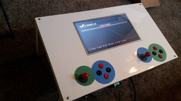

    e14 Contributor over 10 years ago +13
    Mine is pretty much done! Still waiting for a usb extension for the external usb port, and an IEC connector for a nice finished power input. I used some black electrical tape to give the screen a nice…

    I will post more later once I have everything working, but here is what mine looks like so far. I also installed an HDMI splitter and just like the external USB that Spencer used in his but mine also has…
  • kravex
    kravex over 10 years ago +8
    Finished at last! I never got the HDMI splitter to work correctly, it seemed to only want to work if both the TV and monitor were on and plugged in, I even locked down the monitor res in config.txt but…
