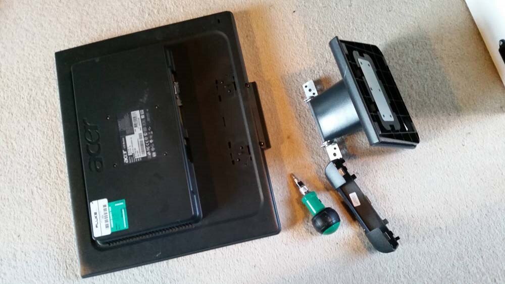

Dismantle Your Monitor
The old Acer AL1716 monitors we used seem fairly generic, in terms of 17" LCD screens, so hopefully yours will pan out the same. By taking the screen chassis out of the plastic casing (nothing complicated there -- take out the screws and prize the two halves apart) you should be left with the screen inside the shielding housing that's almost exactly the same depth as a LACK coffee table. This means that once you've got the screen, all you need to do is drop it into the hole we're about to cut into the PIK3A table top.
And by removing the bezel around the LCD, the screen will sit flush with the top of the table, and give you that essential minimalist finish.
{gallery:autoplay=false} Removing the LCD from the Monitor Housing
Remove the stand, and any screws in the back of the monitor's housing.
It's probably all clipped together, so carefully pry the back of the housing away from the silver bezel around the screen.
You don't need to remove any of the shielding inside once the housing is apart. This is better left in place, to protect the back of the LCD. Note that you might need to relocate (and protect/insulate) the small PCB with the monitor's buttons on.
Remove any small screws that fix the bezel to the LCD's shielding.
Leaving you with an LCD panel that'll sit nice and flush to the table top.

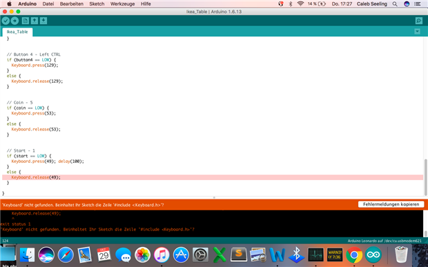

Download and install the Arduino IDE, if you haven't already, and plug in your Leonardo to your computer via a USB cable. Below is the code we hammered together that translates the joystick and buttons into key presses (using the MAME standards, as previously mentioned). But coders we ain't, so if you can improve on this sketch, please post it in the comments.
Before that, here's what to do if you've never played with Arduino before (skip ahead if you know how to upload the sketch to your Leonardo).
    • A "sketch" is a program that your Leonardo will run after it's been uploaded. You can copy and paste the code below into the Arduino IDE window, or download the attached sketch file and open it using the IDE window. It's the same code, but take your pick of how to get onto the Arduino.
    • Take a read through, and you'll see how each input relates to a specific keyboard key press. You can make any desired changes here before uploading to the Leonardo.
    • Click the "Tools" menu and select "Arduino Leonardo" from the "Board" option.
    • Click "Tools" again, and select your Leonardo from the list in the "Ports" option. It's now ready for uploading your sketch.
    • Click the "Upload" button (a circular button with a right-facing arrow in it) to upload the sketch, and the Leonardo is ready to rock.
Sketch Code:
//element14 PIK3A Gaming Table Controls, using an Arduino Leonardo//
void setup() {
  Keyboard.begin();
  //Joystick and buttons pin allocations
  pinMode(0, INPUT_PULLUP); //Joystick Up
  pinMode(1, INPUT_PULLUP); //Joystick Down
  pinMode(2, INPUT_PULLUP); //Joystick Left
  pinMode(3, INPUT_PULLUP); //Joystick Right
  pinMode(4, INPUT_PULLUP); //Button 1
  pinMode(5, INPUT_PULLUP); //Button 2
  pinMode(6, INPUT_PULLUP); //Button 3
  pinMode(7, INPUT_PULLUP); //Button 4
  pinMode(8, INPUT_PULLUP); //Coin
  pinMode(9, INPUT_PULLUP); //Start
void loop() {
  // Button labels:
  int joystickUp = digitalRead(0);
  int joystickDown = digitalRead(1);
  int joystickLeft = digitalRead(2);
  int joystickRight = digitalRead(3);
  int button1 = digitalRead(4);
  int button2 = digitalRead(5);
  int button3 = digitalRead(6);
  int button4 = digitalRead(7);
  int coin = digitalRead(8);
  int start = digitalRead(9);
  // Joystick Up - Arrow Up Key
  if (joystickUp == LOW) {
    Keyboard.press(218);
  else {
    Keyboard.release(218);
  // Joystick Down - Arrow Down Key
  if (joystickDown == LOW) {
    Keyboard.press(217);
  else {
    Keyboard.release(217);
  // Joystick Left - Arrow Left Key
  if (joystickLeft == LOW) {
    Keyboard.press(216);
  else {
    Keyboard.release(216);
  // Joystick Right - Arrow Right Key
  if (joystickRight == LOW) {
    Keyboard.press(215);
  else {
    Keyboard.release(215);
  // Button 1 - Left CTRL
  if (button1 == LOW) {
    Keyboard.press(128);
  else {
    Keyboard.release(128);
  // Button 2 - Left ALT
  if (button2 == LOW) {
    Keyboard.press(130);
  else {
    Keyboard.release(130);
  // Button 3 - Left CTRL
  if (button3 == LOW) {
    Keyboard.press(32);
  else {
    Keyboard.release(32);
  // Button 4 - Left CTRL
  if (button4 == LOW) {
    Keyboard.press(129);
  else {
    Keyboard.release(129);
  // Coin - 5
  if (coin == LOW) {
    Keyboard.press(53);
  else {
    Keyboard.release(53);
  // Start - 1
  if (start == LOW) {
    Keyboard.press(49); delay(100);
  else {
    Keyboard.release(49);

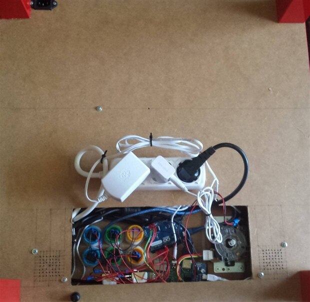

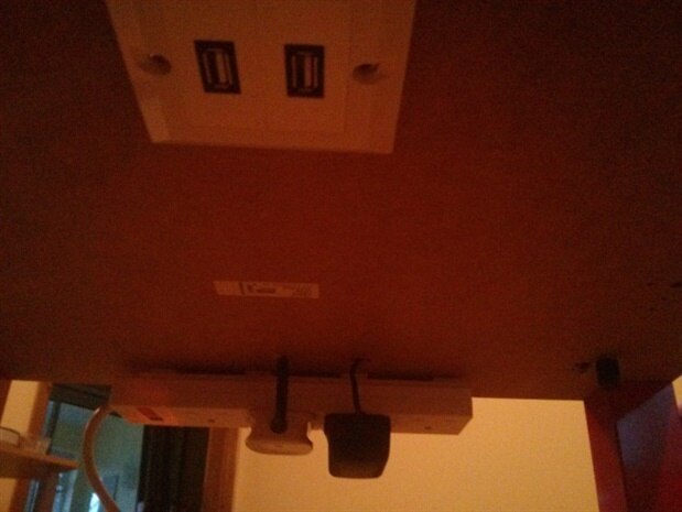

Power
There wasn't really much room left to embed a mains extension inside the table. We cut a connector into the bottom, and wired the extension lead into that. This way we can add a longer power cable if required, or even use one for different regions should the PIK3A table find itself going abroad.
We've powered the speakers and Pi separately, just to spread the load out a bit, but to be honest the Pi3 could handle the speakers from its USB ports. The choice is yours, here.
The monitor, Pi3 and speakers are all connected into the mains extension, powering everything up while hiding the connections beneath the table.
{gallery:autoplay=false} Powering all the Parts
Mark a square in the back corner underneath the table and cut a hole for the power connector. The mains extension is going to connect to the rear of this IEC connector.
Remove the plug from the back of the mains extensions, feed the cable through the inside of the table and bring it out of the hole for the IEC connector. You can now solder the wires to the reverse of the IEC connector, and fit it in place.
It doesn't hurt to screw the mains extension to the bottom of the table, too. In my experience, they tend to fall off the eyelet holes if there's a light breeze, so this one is screwed in place from inside.
You can plug the monitor and a couple of USB adapters into this, to power the screen, Raspberry Pi and speakers, while only requiring one power cable.

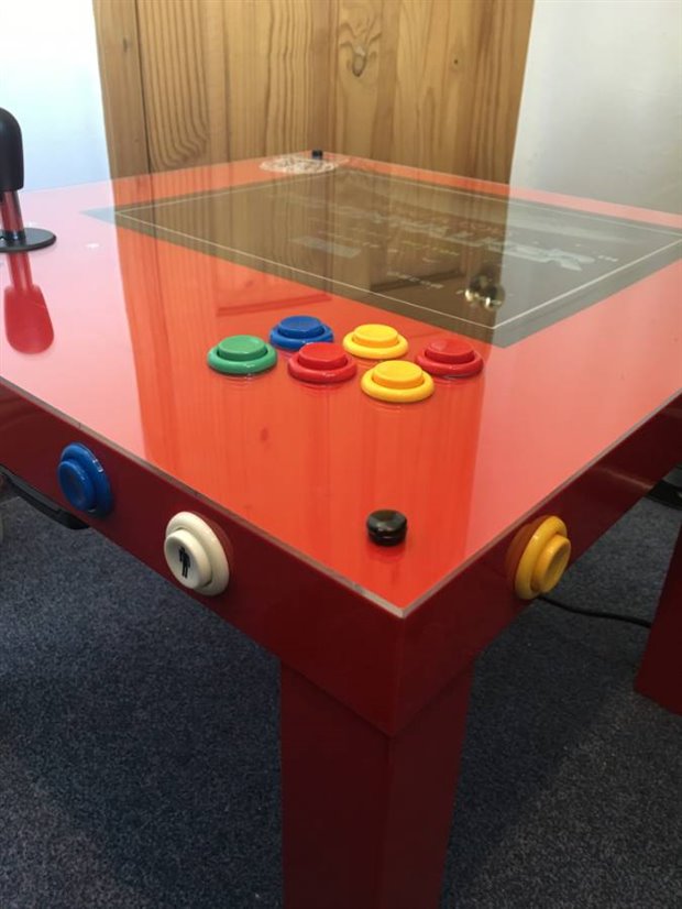

The monitor is a bit vulnerable here, so we decided to get a piece of 3mm acrylic cut to the same size as the table top (550mm by 550mm). It's just screwed into the table top in each corner, and the screws hidden behind screw caps. It's a cheap way to keep things protected.
I also added a panel mount USB port next to the access panel underneath, just in case I ever need to plug a USB keyboard (or other peripheral -- it could be a joypad if you wanted) into the Pi3.
{gallery:autoplay=false} Finishing Touches
An external USB port that goes into the Pi. This is a good one, as it also has a dust cap, since this probably isn't going to get a lot of use.
If you decide to put an acrylic or polycarbonate sheet on top to protect the monitor, remember to put it in place before you insert the buttons, as they'll need to pass through the sheet.
Here we've screwed it in place in each corner, and covered the screw heads with caps.
Remember how you saved the cut out from the monitor hole? Trim it down to make a cover for the access panel on the back, after notching the bottom of the table as an exit for the power cables.

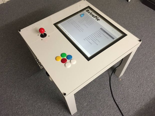

The finished PIK3A table is strong enough to hold Baxter here, but given how much we've hollowed it out, be careful about how much weight you put on it. Definitely don't stand on it to change a light bulb (mind you, I wouldn't trust these enough do that with a new Ikea table).
Then it's just a case of screwing the legs to the table top, and installing RetroPie on the SD card. There's one additional step you might have to perform for the time being, to get RetroPie running in the Raspberry Pi 3. The developers will undoubtedly fix things very soon, but for the moment we had to copy over the "*.elf" files (that'd be imagestart.elf, start_cd.elf, start_db.elf and start_x.elf) from the "Boot" partition of an SD card that had the official, Raspberry Pi NOOBs image.

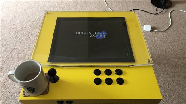

    e14 Contributor over 10 years ago +13
    Mine is pretty much done! Still waiting for a usb extension for the external usb port, and an IEC connector for a nice finished power input. I used some black electrical tape to give the screen a nice…

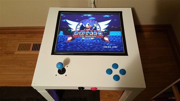

    I will post more later once I have everything working, but here is what mine looks like so far. I also installed an HDMI splitter and just like the external USB that Spencer used in his but mine also has…
  • kravex
    kravex over 10 years ago +8
    Finished at last! I never got the HDMI splitter to work correctly, it seemed to only want to work if both the TV and monitor were on and plugged in, I even locked down the monitor res in config.txt but…

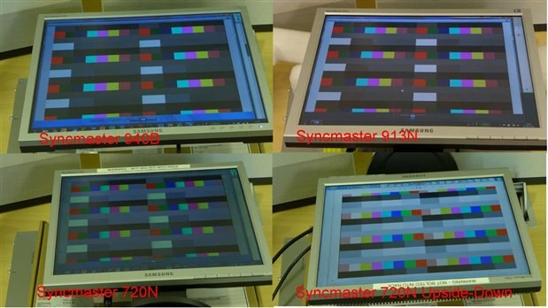

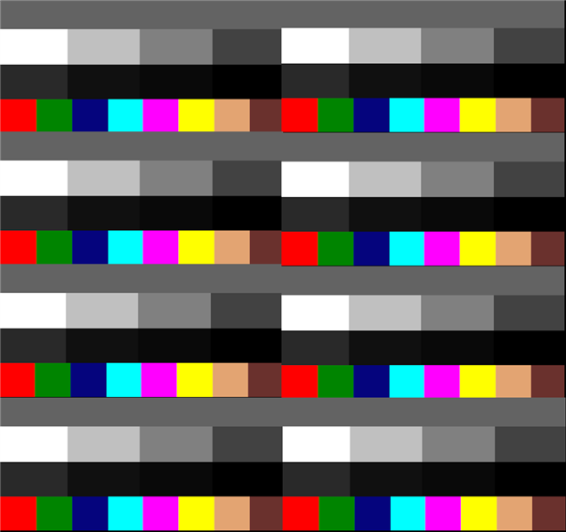

    shabaz over 10 years ago
    I tried three monitors, using the following as the test image:
    Here are the results:
    For all of these, the photo was taken about 45-50 degrees off perpendicular. I tried keeping everything consistent, fixed zoom/aperture/speed, but white balance was set to auto. I didn't adjust any monitor settings, they were left at whatever the last user had kept them at (presumably best for normal viewing face-on). The upside-down one looks best I think, but it probably needs checking in case the effect differs for other monitor types/brands.
    Overall (either orientation), the Samsung 9xx series was better than the 720N. EDIT: looks like the 9xx series is 19 inch. The 720N is 17 inch. Does anyone know if 19 inch is ok for that table, or too cramped?
    There is a monitor scrap-heap here, I thought I'd try to take some photos of different monitors at the same angle. I'll post up some photos shortly, but what is interesting is that on the Samsung one I've tried so far, when viewed at an angle, the colours fade a bit, but don't invert. White fades a bit too. But if there is anything black, it becomes grey, and anything grey becomes black.
    Interestingly, this greyscale inversion did not occur if the angle was from the other side. Then all I get is fading overall, but no greyscale inversion. I wonder if there is a way to permanently turn the image in RetroPie upside-down.
    This was with a Samsung 940B. I'll try some other monitors from the scrapheap..
