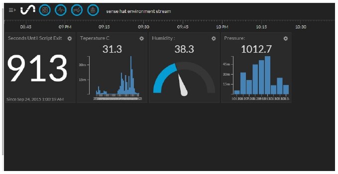

Raspberry Pi Weather Station Project
Using SenseHAT, InitialState Cloud Service and your Raspberry Pi, create a working Weather Station
Overview:
This kit helps to build your own local weather dashboard, capturing the weather inside and outside your house or office over time. This super-fun and easy project will leverage the Internet of Things (IoT), using the new Raspberry Pi 3 with built-in WiFi, a Sense HAT, and the Initial State cloud platform. Raspberry Pi will capture all the sensor data from SenseHAT and stream it directly to the cloud and this stream of data/information can be monitored or displayed in a professional graphical fashion which can be accessed from your smartphone or computer from anywhere in the world with just a few button clicks.

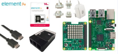

Get the kit:
SenseHAT Weather StationSenseHAT Weather Station
(you can remove individual item(s) at the cart )
Project requires:
1. Raspberry Pi3Raspberry Pi3
2. Translucent EnclosureTranslucent Enclosure
3. 16GB MicroSD card preloaded with NOOBS16GB MicroSD card preloaded with NOOBS
4. Raspberry Pi Sense HATRaspberry Pi Sense HAT
5. Pi3 Power Supply 5V, 2Pi3 Power Supply 5V, 2A
6. 7" Pi Display7" Pi Display or HDMI monitor with HDMI cable
7. Keyboard & Mouse (for HDMI monitor)

9. Now run the modified Python file to start the weather station:
sudo python pi_weather.py
10. Go to the browser from your computer or mobile device and login to your initial state account and start monitoring the data.
6. Go to the browser from your computer or mobile device and login to your initial state account and start monitoring the data.
