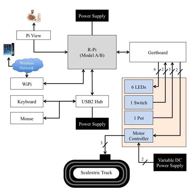

1. System Configuration

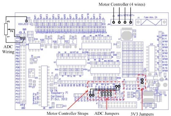

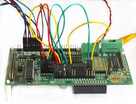

The system configuration is shown in Figure 1.1. The basic configuration is:
  • R-Pi (Model A/B) - this project can make use of either Model. In both cases it is recommended that a WiPi is used to provide network connectivity (wireless, IEEE 802.11, via the USB2 port on the R-Pi). Network connectivity is required to provide access to the R-Pi Web server and to download and install the necessary software updates required by the Gertboard software. A USB2 hub is recommended to enable more than two USB devices to be linked to the R-Pi (the R-Pi has two USB ports). It is assumed that the keyboard and mouse are linked via the USB Hub and, if necessary, the WiPi. The monitor can be linked either via the HDMI interface or the yellow RCA phono connector for composite video output. In this project a PiView connector is used to enable a monitor with a VGA connector to be connected to the R-Pi via the HDMI interface;

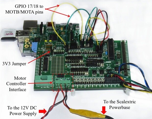

  • Gertboard - a single Gertboard is connected to the GPIO interface on the R-Pi. The Gertboard configurations vary depending on the input/output operations required. For this set of instructions the Gertboard will be configured, separately, to drive the internal/external Light Emitting Diodes (LEDs), the external switch/button, the external potentiometer and the motor controller interface. The Gertboard User Manual (Revision 2.0 published in 2012 by Fen Logic Ltd) is available at: Gertboard User Manual. This is required reading;

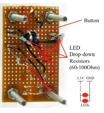

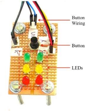

  • LEDs, Switch and Potentiometer (Pot) and Motor Controller circuitry - the 6 LEDS are wired so that they can be driven as outputs via the Gertboard buffers. The LEDs used in this project have a forward voltage of between 2.0V-2.2V.  The external switch is a 'Push-to-Make' button and also connected to the Gertboard buffer. The 'Pot' is wired to the Analogue-to-Digital Converter (ADC) interface on the Gertboard. The Scalextric track and the Variable DC Power Supply are connected to the Motor Controller interface on the Gertboard.
The basic approach is to use the Motor Controller interface on the Gertboard to vary the voltage supplied to the Scalextric track i.e. to replace the usual Scalextric car controller. The voltage is varied via the R-Pi and the use of Pulse Width Modulation (PWM) output from the R-Pi and supplied to the Gertboard through the GPIO interface. The PWM signal is applied to the voltage supplied by the Variable DC Power Supply (the variability of this power supply is NOT used to vary the voltage to the Scalextric cars) and the resulting output voltage from the Motor Controller interface on the Gertboard applied directly to the Scalextric track.
Figure 1.1 System configuration.

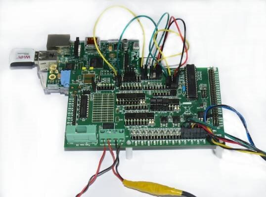

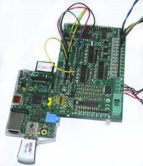

When the complete system is built it will look as shown in Figure 1.2.  The views shown in Figure 1.2 are full view (a) and close-up (b).
Figure 1.2 The completed system.

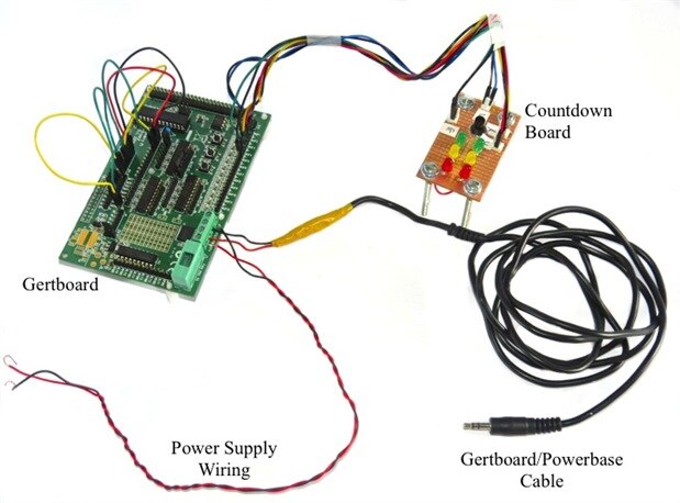

  4. Once it has been confirmed that the track and car are working correctly the next step is to replace one of the standard controllers with the R-Pi/Gertboard approach. The best way to create the new cable between the Gertboard and the Scalextric Powerbase is to cut off the cable from a standard controller (this means that the jack connector for the Powerbase can be used). At the cut end of the cable, tape the Green wire so that it cannot short the other two wires. The Black and Red wires are now ready to be inserted into the Motor Controller interface on the Gertboard. Video 2 demonstrates how the Gertboard/Scalextric Powerbase are wired together - see More Detail;

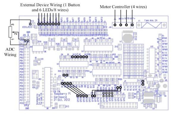

  5. Now that the basic system has been wired the next step is to control the speed of the Scalextric car using three different methods: i) a potentiometer, ii) the R-Pi keyboard, and iii) a Web browser;
  6. To control the Scalextric car using the R-Pi keyboard download and install the software (this is the file 'fsmot-wpv1p0p0.py' on the Element14 Github - see Appendix B3). Once the Python software is started the Scalextric car can be driven around the track by using the 'f' (to go faster) and 's' (to go slower) keys on the R-Pi keyboard (see Video 5) - see More Detail;
  7. To control the Scalextric car using a potentiometer the ADC pins on the Gertboard are used. The Gertboard has two ADC channels but only one is used. Three wires are used to connect the potentiometer to the ADC channel 0 on the Gertboard (see Video 3 for how to wire the potentiometer configuration for the Gertboard). The Python software required to drive the Scalextric car is now downloaded and installed (this is the file 'potmot-1way-wpv1p0p0.py' on the Element14 Github - see Appendix B2). Once the Python software is started the Scalextric car can be driven around the track by turning the knob on the potentiometer to make the car go faster and slower (see Video 4) - see More Detail;

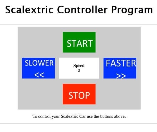

  8. When using a Web browser to control the Scalextric car the Gertboard wiring just requires the basic motor controller wiring. The Web browser software must be downloaded and installed (downloaded from the Element14 Github - see Appendix B4).  A Web browser is now used to open the Web page 'ScalextricControllerv1p0p0.html' on the R-Pi Web server (this requires the use of the IP address for the R-Pi). The car can now be driven around the track using the Web browser. The next step is to wire the Gertboard to enable the countdown board to be used. The countdown board is required so that the external LEDs and button can be controlled using the Gertboard (see Video 6) to provide a start of race LEDs countdown. The countdown software (either of the files 'countdown-rgv1p0p0.py' and 'countdown-wpv1p0p0.py' is now used to start the race) and the Web browser used to control one of the Scalextric cars (see Video 7) - see More Detail.

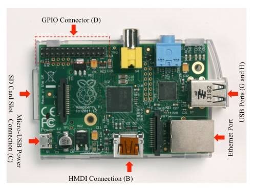

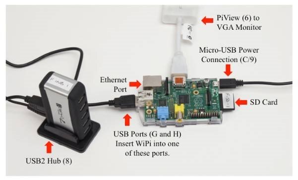

The layout of the R-Pi (Model B) is shown in Figure 4.1. Once the various cables have been connected to the R-Pi, the configuration is as shown in Figure 4.2 (the alphanumeric annotations refer to the identifier entries in Tables 2.1 and 2.2). The latest versions of the Raspbian operating system can be installed using the instructions in Appendix B1.1. Make sure that the Git client is installed (see Appendix B1.2).
Figure 4.1 - R-Pi Model board B layout.Figure 4.2 - The R-Pi with the set of connected cables.
If the WiPi has been inserted, the use of the appropriate wireless network must be established (this requires a wireless network to be activated, via an appropriate wireless network access device e.g. a wireless router, and for that device to be assigning IP addresses using DHCP). This is achieved by working on the desktop:

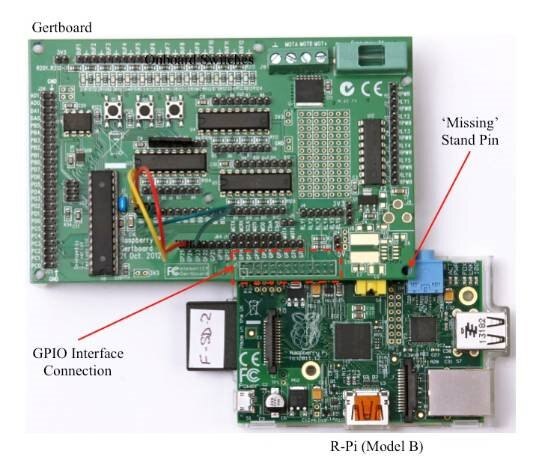

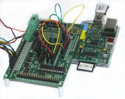

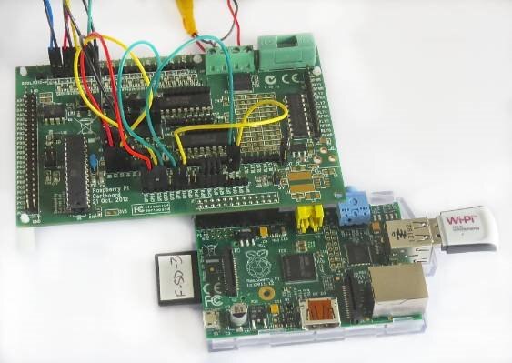

The Gertboard and the R-Pi are connected via the GPIO connectors. The GPIO interface on the underside of the Gertboard (female) is inserted into the GPIO interface (male) on the R-Pi. Figure 4.3 shows the resulting layout. If the 'Missing' Stand Pin was not missing then this form of connection would NOT be possible and so a separate cable would be required.
Figure 4.3 - Connecting the Gertboard to the R-Pi.
Once the Gertboard and the R-Pi have been connected then various software should be installed (the installation of the software does not require the Gertboard to be connected to the R-Pi). The software to be installed is:
  1. The WiringPi Python module - see Appendix B1.3;
  2. The SPI Dev module - see Appendix B1.4;
  3. The Apache2 Web Server - see Appendix B1.5;
  4. The new Gertboard Scalextric control software (from the Element14 Github) - see Appendices B2, B3 and B4.
A jumper should be placed across the top two pins of the three 3V3 pins to ensure that a logic '1' level on the board equates to a voltage of 3.3V (this jumper is not shown in Figure 4.3 but can be seen in Figure 4.4). Figure 4.4 shows the wiring of the DC power supply and the Powerbase cables to the Gertboard's motor controller interface (more detail on the detailed wiring of the Gertboard for this project is given in Appendix A2).
Figure 4.4 - The wiring for the motor control interface on the Gertboard.
The two wiring straps required to configure the motor controller interface are labelled in Figure 4.4. If a variable DC power supply is used then set it at a supply voltage of 12V as this will not cause damage to the track. A 12V battery pack can be used instead of the variable supply voltage. The power supply needs to be able to provide at least a 0.25A current and a voltage of at least 2V is required before the car will start. It should be noted that if a 10V supply is used that, in general, this does not stop the car from reaching a maximum speed.  In many cases, for a 12V supply,  the PWM setting for the car will not exceed 300 (note that this has an absolute maximum value of 1023) before the car starts to veer off curves in the track.  If a lower voltage is used then a higher PWM is required to achieve the same speed but this will still be well below the 1023 maximum.  See Video 2 for a demonstration the wiring of the motor controller interface.
4.3 Using the Potentiometer to Control the Scalextric Car
To control the Scalextric car using a potentiometer the ADC pins on the Gertboard are used. The Gertboard has two ADC channels but only one is used. Three wires are used to connect the potentiometer to the ADC channel 0 on the Gertboard (see Video 3 for how to wire the potentiometer configuration for the Gertboard). The wiring on the Gertboard is shown in Figure 4.5.
Figure 4.5 - Wiring of the Gertboard for potentiometer control of the Scalextric car.

The wiring of the Gertboard for control by the R-Pi keyboard requires only the use of the motor controller interface (remove the ADC wires and jumpers in Figure 4.5). However, the software will still work if the wiring for the other modes remains in place (the software ensures that the GPIO pins are used in the correct mode). To control the Scalextric car using the R-Pi keyboard, download and install the software (this is the file 'fsmot-wpv1p0p0.py' on the Element14 Github - see Appendix B3). The program is started using the LXTerminal command:
     sudo python fsmot-wpv1p0p0.py
Once the Python software is started the Scalextric car can be driven around the track by using the 'f' or 'F' (to go faster) and 's' or 'S' (to go slower) keys on the R-Pi keyboard (see Video 5). It is a simple edit of the Python program to allow the use of other keys.

Figure 4.6 shows the full countdown-based Gertboard configuration.
Figure 4.6 - The component wiring for the Web browser Scalextric car control.
The next step is to build the countdown board to provide a start of race LEDs countdown. The countdown board enables the external LEDs and button to be controlled using the Gertboard. Figure 4.7 shows the countdown board top view (a) and underside view (b) and a demonstration of wiring the board is shown in Video 6. The Gertboard provides a 3.3V source voltage and so a 60-100Ohm drop-down resistor is required for each pair of LEDs (the LEDs have a forward voltage of 2.0-2.2V).  Each set of coloured LEDs is wired in parallel (as shown in Figure 4.7b).
Figure 4.7 - The wiring of the countdown board.
(a) Top view of the countdown board.
(b) Underside view of countdown board.
The detailed R-Pi/Gertboard wiring when using the countdown board and the Web browser to control the Scalextric car is shown in Figure 4.8.
Figure 4.8 - The R-Pi/Gertboard configuration for the Web browser Scalextric car control.

A Web browser is now used to open the Web page 'ScalextricControllerv1p0p0.html' on the R-Pi Web server (this requires the use of the IP address for the R-Pi - see Appendix B4). The web-page is opened by using the following URL:
     http://<Your IP Address>/ScalextricControllerv1p0p0.html
The car can now be driven around the track using the Web browser. A demonstration of using the Web browser to control one of the Scalextric cars is shown in Video 7.

If the browser software has been installed correctly the web page show in Figure B4.1 should be displayed on your browser. If not, then read the Troubleshooting instructions.
Figure B4.1 - The start web page displayed for the Scalextric Controller.
The web-page provides four buttons to control the speed of the car. The speed of the car is shown in the centre cell and this has a value of 0 ≤ speed ≤ 1023 (this is the value that is being sent via the PWM pin).  When the 'START' button is pressed the car speed will become 250 and when the 'STOP' button is reseed it will become 0. The 'SLOWER' and 'FASTER' buttons decrease/increase the speed by a value of 10.

Once the software starts the line "Press button to start countdown" is printed to the terminal screen and all the LEDs on the countdown board will be off. The software waits until the button on the countdown board is pressed.  Once pressed the statement "Starting countdown" is displayed. The LEDs on the countdown board are now lit in the sequence:
  • Only the Red LEDs are on for 2s;
  • Both the Red and Yellow LEDs are on for 2s;
  • Both the Red and Yellow LEDs are flashing for 2s;
  • Only the Green LEDs are on for 6s.
Once complete the statement "Countdown complete" is printed on the screen. The race should start once the Green LEDs are lit.
