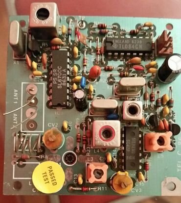

    shabaz over 10 years ago in reply to mconners
    My dad was the same! He didn't know what I was doing, but had the engineering spirit. He always encouraged me, even if it meant travelling miles just to find a store that sold an LED.
    The throwaway cost is a good point - would make people less scared to approach a PCB.
    I often nowadays purchase boards if they are a throwaway cost, since I might learn something from them, and no harm if I don't.
    This is the latest addition: It is a radio receiver board, I've no idea what it was used for but looks fairly ancient.
    Worth some experimentation time at some point!
