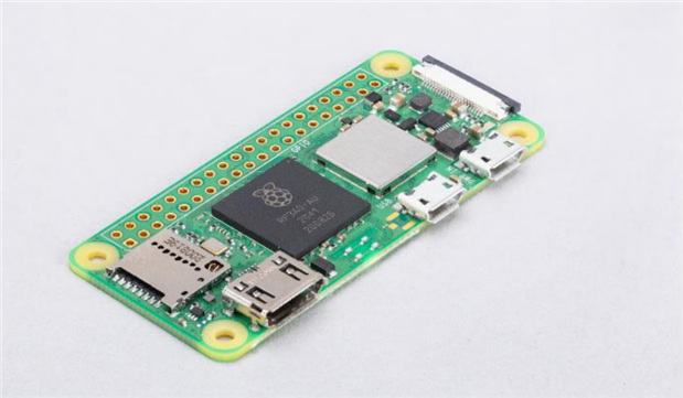

Introducing the New Raspberry Pi Zero 2 W.
The second version of the tiny and powerful fan favorite, building on the success of the current Zero family, Raspberry Pi Zero 2 W is built around a Raspberry Pi-designed System-in-Package, which integrates the BCM2710A1 die used in Raspberry Pi 3 with 512MB of RAM. The exact performance uplift over Zero varies across workloads, but for multi-threaded sysbench it is almost exactly five times faster.
Key features:
• 1GHz quad-core, 64-bit ARM Cortex-A53 CPU
• VideoCore IV GPU • 512MB LPDDR2 DRAM
• 802.11b/g/n wireless LAN
•Bluetooth 4.2 / Bluetooth Low Energy (BLE)
• MicroSD card slot
• Mini HDMI and USB 2.0 OTG ports
• Micro USB power
• HAT-compatible 40-pin header
• Composite video and reset pins via solder test points
• CSI camera connector

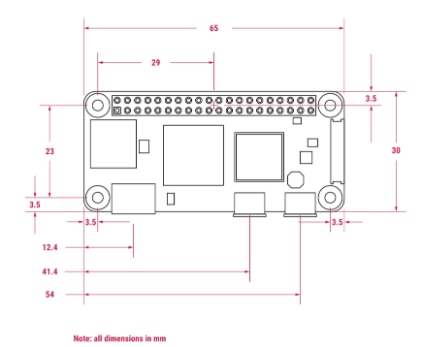

Foot Print
The Raspbery Pi Zero 2 W uses the same Footprint as the previous Raspberry Pi Zero W model.
65mm x 30mm (x 5.2mm maximum z-height)

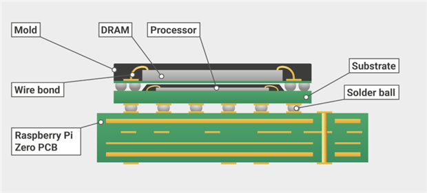

Like Raspberry Pi 1, Raspberry Pi Zero and Zero W are built around the Broadcom BCM2835 SoC. This neatly sidesteps the problem by using package-on-package (PoP) technology, in which the SDRAM package sits directly on top of the SoC. - Raspberry Pi 2021

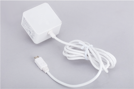

Raspberry Pi Zero V2 Power Supply
The Raspberry Pi Zero uses a Micro USB Power supply, the official power supply comes in US, EU, UK, AU and IN sockets.
