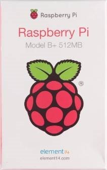

While there is a few variety of Raspberry Pi boards available, most users are likely to own a Model B of some description, as these are the recommended boards for beginners as they are most featureful without being too expensive. If you have the box, then that can definitely give you a hint as to which model you have. If you have the plain white box to the left, then you've got an "original" Raspberry Pi Model B. If you have the one in the middle, you have a Raspberry Pi Model B+. If you have the one on the right with a big "2" on it, then you have the latest Raspberry Pi 2 Model B.
