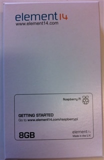

    Gough Lui over 11 years ago in reply to fvan
    Thanks Fred. I've handed the article over to spannerspencer, so I guess he can incorporate the images if necessary. It's cool to see them, but to be honest, the differences in the two sorts of boxes (NOOBS and non-NOOBS) are relatively subtle. That being said if you do manage to find the B+ NOOBS box, I think it will be worth incorporating just to be exhaustive.

    fvan over 11 years ago
    Managed to find a box for an original and Pi 2 NOOBS. I probably have a B+ NOOBS somewhere also. I can try to make a scan at work if you require better quality pictures.
