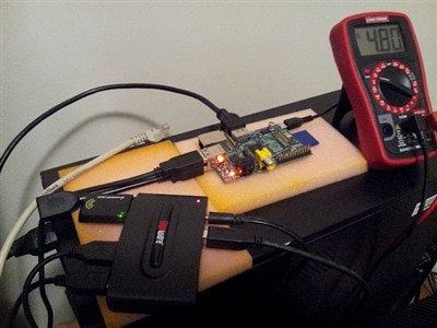

It contains detailed information on WiFi adapters I have tested with a production Raspberry Pi:
image UPDATES:
  • I recommend Raspbian "Wheezy" image as most WiFi drivers and firmware are included

      • image UPDATE: 2012-05-11 - connected OK to 802.11g WPA2 AP with wicd-gtk in LXDE with mouse and keyboard connected
        • TP1/TP2 voltage: 4.8V
        • All device plugged into powered USB hub (pictured at top of the page)
        • USB devices connected
        • Screenshot of wicd-gtk
      • imageUPDATE: 2012-05-15: able to stream video OK from YouTube in XBMC
      • image Requires:
        • Driver and firmware included in Raspbian "Wheezy" image
        • staging driver kernel module compiled from Raspberry Pi Foundation github repo (direct download)
        • install firmware-realtek package from squeeze non-free repo

      • image connected OK to 802.11g WEP access point with wicd-curses (haven't switched AP to WPA2 to test yet)
      • image UPDATE: 2012-05-15 - connected OK to 802.11g WPA2 AP with wicd-gtk in LXDE with mouse and keyboard connected
      • image Requires:

      • image connected OK to 802.11g WEP & WPA2 access point with wicd-curses
      • image if already associated via wicd-curses, connections stays up when launching LXDE
      • image however, fails to establish new connection in LXDE with errors similar to following in log:
        • kernel: smsc95xx 1-1.1:1.0: eth0: Failed to read register index 0x00000118
      • image TP1/TP2 is 4.80V and all devices are connected to powered USB hub

      • imagefails to establish new connection in LXDE with errors similar to following in log:
      • image Requires: htc_7010.fw firmware copied to /lib/firmware
