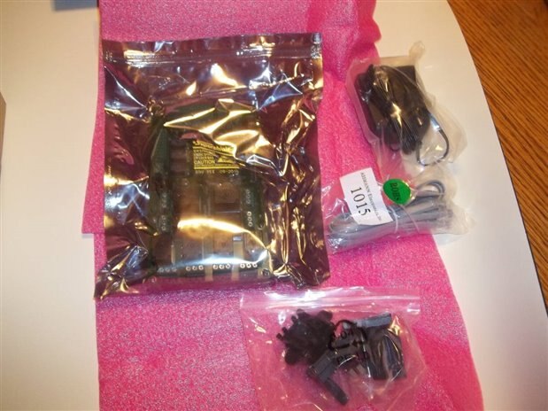

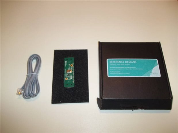

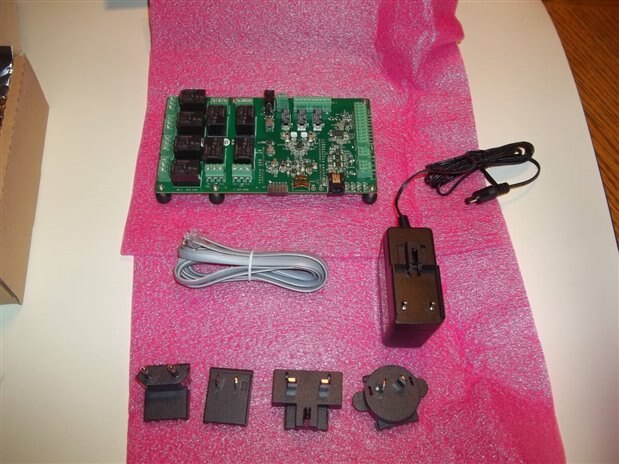

So here are the packages. The first and smaller box contained the Grid-EYE MAXREFDES130# module with a RJ11 cable for the 1-wire connection. The second box contained the 1-Wire Arduino shield.
MAXREFDES130#
MAXREFDES131#

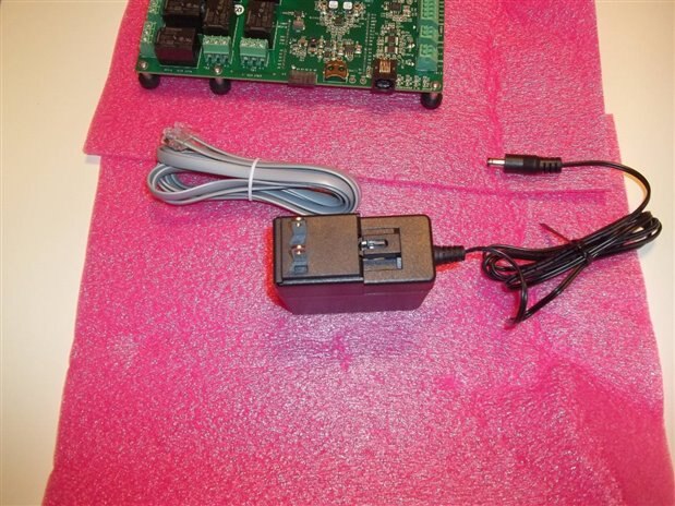

The shield was in a good ziplock ESD bag. The ESD bag was big enough to fit the shield in with the NerO and CleO both attached. The box also contained another longer RJ11 cable. The power supply came with a world wide assortment of outlet plugs that just snap right on the face.
The USA plugs clipped right on.....
NerO installed without a hitch.

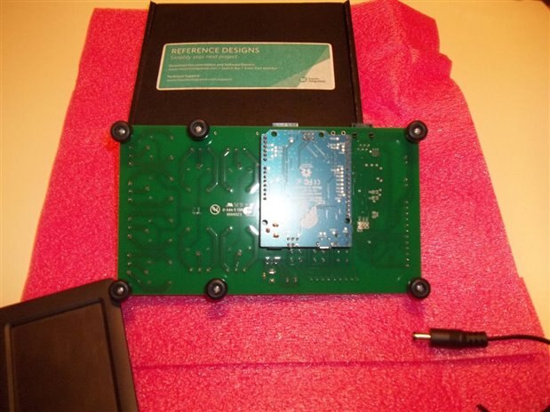

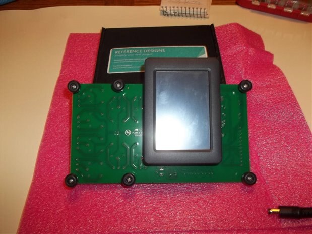

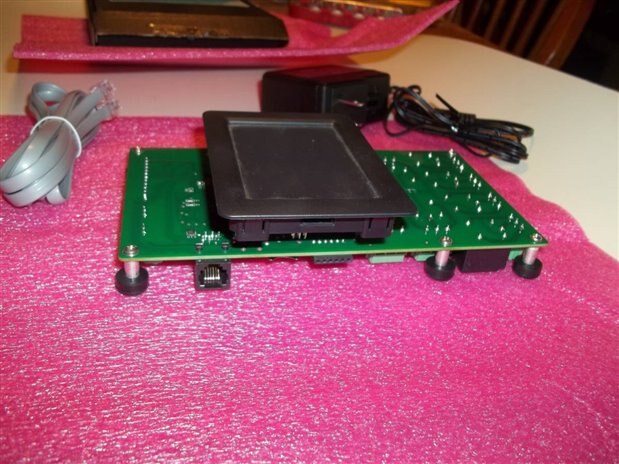

Once the CleO was attached I realized that the legs were oriented the wrong way for a tft screen.
The legs easily installed on the otherside of the shield.
However, one of the relay blocks was obscured by a leg and the board rests on the housing of the relays. This hasn't caused any problems for testing, but with a 3.5" screen installed on the NerO it would need an odd shaped housing. This is a reference design, so for its purpose it has a nice layout with all of the block and power connectors around the perimeter of the board. It all worked alright when I fired it up and installed the demo program at any rate. It seems compatible with the CleO and they seem to share the SPI bus just fine.

    A quick note, I believe the legs should be on the other side (at least that's how mine came) not that this resolves teh issue at all. The bigger issue if you are using an UNO (it's all I have) the ethernet port makes contact with a number of solder points possibly shorting the board... I have not checked exactly which pins would be shortened only that it would be the lower 4 that connect K10 to the board (the 4 closest to the Arduino headers). as for being rushed out.. thats is definitely not an understatement.
    Kas
    EDIT: Just realized I commented before reading the full blog entry, I understand teh issue with teh legs in your case now, sorry
