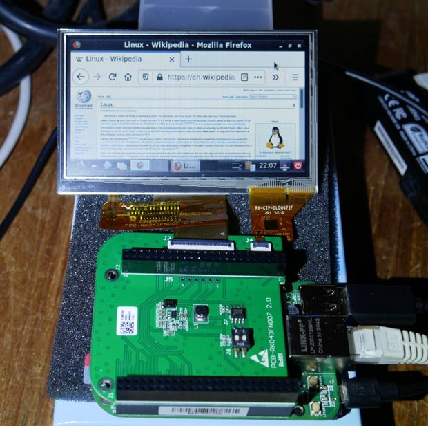

Look! there it is, it works. image

Actually it's all fine. You don't need any software from Farnell at all.
All you need to do is load the most recent IOT SD card image from the Beaglebone site.
At the time of writing the latest image is "AM3358 Debian 10.3 2020-04-06 4GB SD IoT".
You can download it here
Graphics on the LCD is inherently supported. The machine will boot to a text mode console on the graphical LCD display.
If you want a Linux desktop just install one. You will get a login dialog box and then a graphical desktop.
You can find instructions for the LXDE install here
Use the instructions for LXDE on Debian Wheezy the other instructions might work too - I didn't try those

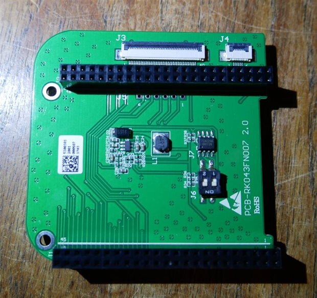

  • There are no schematics for the board.
There is barely anything on the board, so you might think you don't need one.
Actually you don't really know what's happening there, and if it doesn't work you're left guessing.
It's pretty lamentable that there are no schematics available, it encroaches on Raspberry Pi territory. image
It's hardly an NDA thing, it's just a boost regulator and an EEPROM, after all.

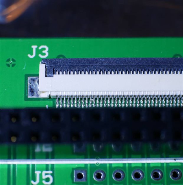

  • I was unlucky. Out of the box mine had an electrical fault.
Not knowing the previous three things I lost a lot of time to research. I was trying to figure out why the software was wrong.
Actually, it wasn't until I inspected the LCD electrical signals I realised that the 10MHz LCD clock was not right.
On my oscilloscope I could see the signal was stuck high and "all spikey like".
Using a multi-meter I was able to identify that the the clock signal was shorted to the 3.3V rail.
Careful visual inspection revealed a short on the LCD flex connector. Picture below;
The basic design of the board is not well thought out. I can see already that the failure rate on these boards is going to be high and that they cannot easily be tested.
Testing would have been possible but not at the price the board is sold at.
I suggest that it is quite likely that other people will see failures on these boards too.
If you get a board with a fault like this Farnell are very good about returns. I decided to fix mine.
In the picture below you can see the problem;
The 0.1" pitch header is very close to the LCD flex connector. You can't easily get in with a soldering iron to clear the short.
I flooded the area with liquid flux. I have a Weller TCP iron with a screwdriver tip "Weller ETB". It's a pretty chunky iron, and you have to be careful not to melt the header.
I folded the end over on some solder wick and hooked it over the top of the connector. I applied the iron vertically to the board and pushed outwards against the wick and the connector.
It took a lot of attempts to catch and soak up the short. Be patient and use lots of flux. You can clear the short without melting the connector, even with a chunky iron.
