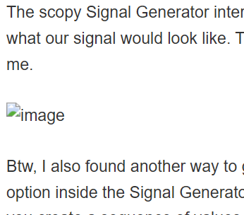

The scopy Signal Generator interface gives us a visual representation of what our signal would look like. This looks like an acceptable pulse to me.

  • beacon_dave
    beacon_dave over 3 years ago
    FYI I'm seeing two broken image embeds in this blog.
    First one here:
    and the second one here:
