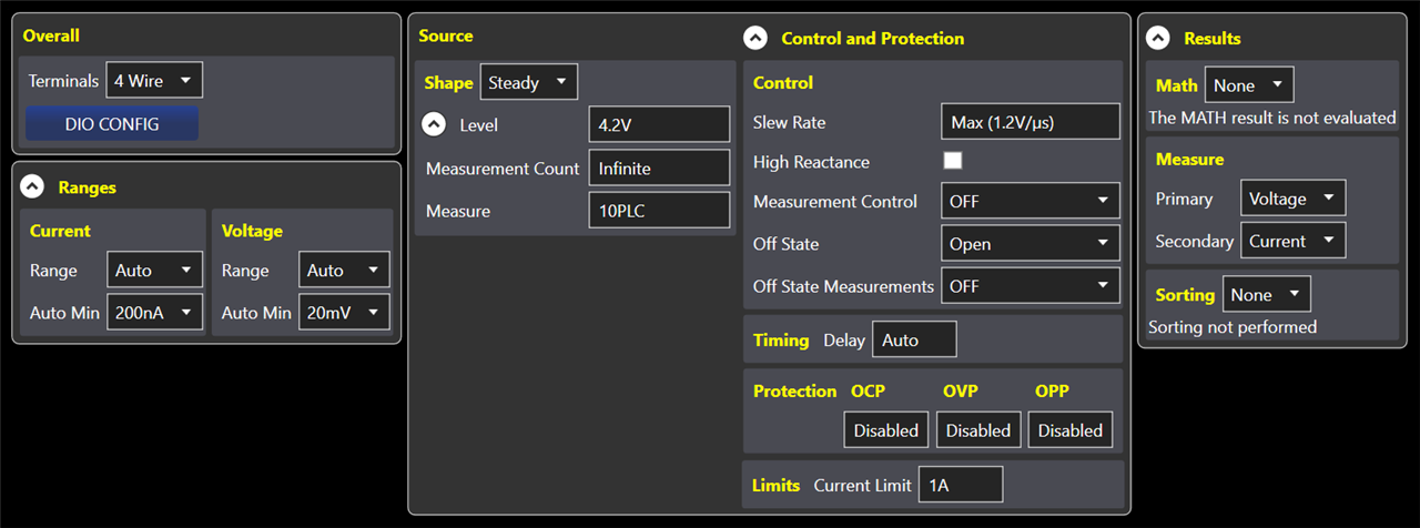

6.3.1 Battery charge
To characterize the battery the first thing that needs to be done is to completely charge it. To do this I set the SMU as a 4.2 V voltage source with a current limit of 1 A. With these settings the battery begins charging at 1 A constant current, followed by a constant voltage of 4.2 V. I let the SMU charge the battery until the charging current dropped below 1 mA.

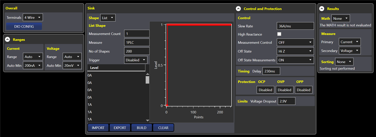

6.3.2 Battery discharge
To measure the capacity of the battery a current load must be applied until the battery voltage reaches the recommended minimum of 3 V. The internal resistance can be measured by taking the difference between the battery voltage without and with a load current, divided by the applied load current.
I used a load protocol that alternates between 1 A for 59 s and no-load for 1 s to measure the internal resistance as the battery discharges. To do this, I set the SMU to operate as current load, and repeatedly apply an arbitrary waveform. The SMU application allows the creation of common waveforms, so I built a step waveform that began with 4 time units at no-load followed by 236 time units at 1 A. I then configured the time unit to be 250 ms by setting the measure time to 20 ms (1 PLC) and the delay to 230 ms. Finally, I set the SMU to repeat the waveform 200 times and the voltage dropout to 2.9 V to cross the 3 V threshold.
Once the battery voltage crossed the 3 V threshold, I waited for one last no-load phase and then interrupted the process.
I then proceeded to saved the data as a CSV file for further processing with Python.
If I define 0% charge to be the point where the battery under a 1 A load reaches the threshold of 3 V, then the battery has a capacity of 5.24 kC (or 1455 mAh) and can store 18.9 kJ of energy.
To measure the internal resistance, I computed the difference between the voltage before the the no-load spike, and at the spike divided by 1 A.
The internal resistance of the battery showed a "U" form, where it reaches the minimum of 111 mΩ around 60% of its charge, and a maximum of 126.5 mΩ at 0% of charge.
