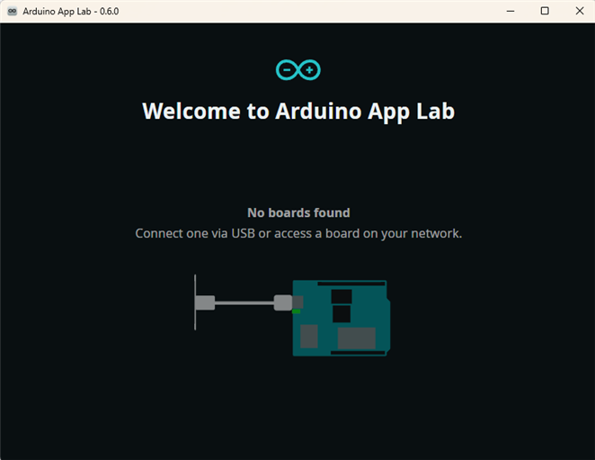

The Arduino App Lab is the software ecosystem that is the key to developing applications for the Uno Q.  I'll cover how AppLab operates and the composition of an application in a future blog.  For now,  I'm just trying to verify that my setup is operational  by running a couple of example applications.
It takes a little while for AppLab to find the board on USB.
If it finds the board you need to select it to connect (in case it finds multiple boards or connection types there can only be one connected at a time).

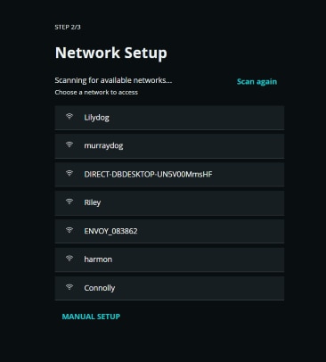

Then it scans for network access points nearby.
You choose the access point and enter the password to connect to the WiFi network.

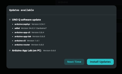

Then, it checks for updates.
And there will be a few if this is the first connection to AppLab.

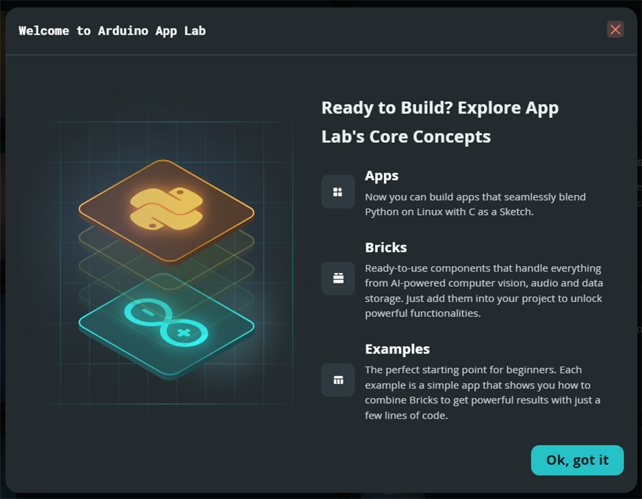

The login prompt - the default user is "arduino".  It will prompt for a password at first login.
Initial Welcome Screen

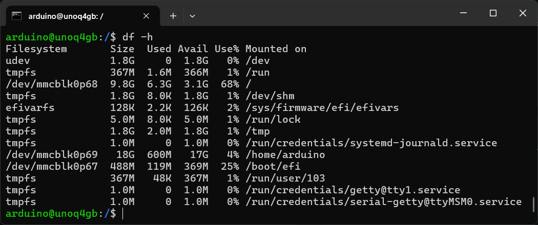

Uno Q File System
The Status bar at the bottom of the AppLab window gives a concise view of Flash, RAM, and CPU usage.
The Linux df command gives a better look at how the Flash memory is partitioned.  At the bottom left of the AppLab window there is a ">_" button that lets you open a remote shell on the board.
There are three primary partitions /, /home/arduino, and /boot/efi.  I am a bit concerned that 68% of the / partition is already consumed.  I have read that the docker system that is used by AppLab is stored in that partition

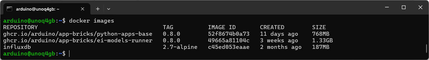

I took a look at the initially installed docker images and it seems like AI applications might quickly consume the available space.  It's something that I'll check when running some of the AI examples.

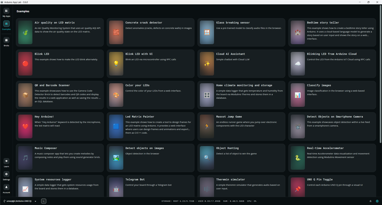

Example Apps
On the left menu bar there are buttons to access your own apps, example apps, and bricks (which are modular components that are essentially functional libraries).
Currently, there are 29 example apps (AppLab version 0.6.0).  Here is what would fit in the window just to give you an idea of what's available.
Of course, I ran the customary "Blink LED" and that worked as expected.  Then, I ran "Blink LED with UI" which allows controlling the LED using a web browser and that also worked.  The next step is to try an app that uses a Modulino module to try out the QWIIC (I2C) interface.

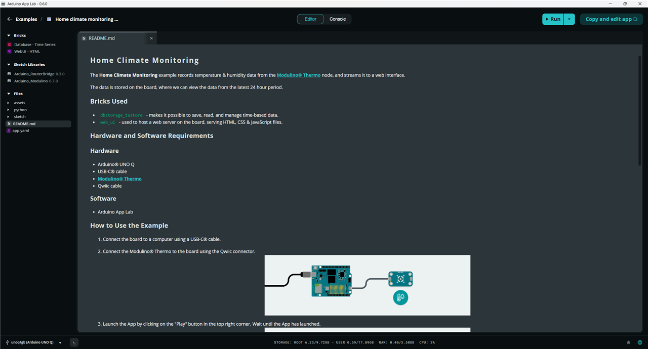

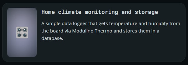

Home climate monitoring app
I decided to use the Home Climate app that uses the Modulino Thermo module to measure temperature and humidity data which it stores and streams to a web interface.

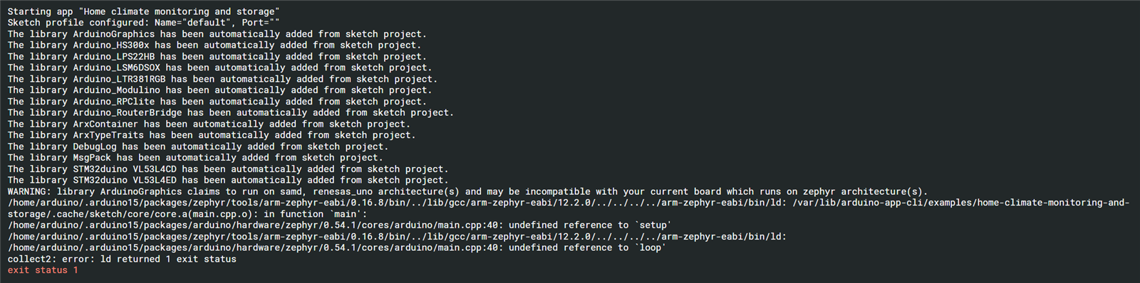

When I tried running this app it had a linking failure during compilation.
It is something related to Zephyr.  One of the changes to the Arduino IDE used for AppLab is the replacement of the Mbed hardware libraries with Zephyr due to the end of Mbed support.  I'm not completely sure what this error is, but an AI query suggested that for certain hardware uses Zephyr needed to recompile and it did not have permissions to update the sketch directory because examples are read only.  I created a copy of the app which allows me to modify it and it worked without modifying the sketch source code.
The app uses the WebUI Brick to publish data to a web browser to display the data.  The browser URL is unoq_ipaddr:7000.

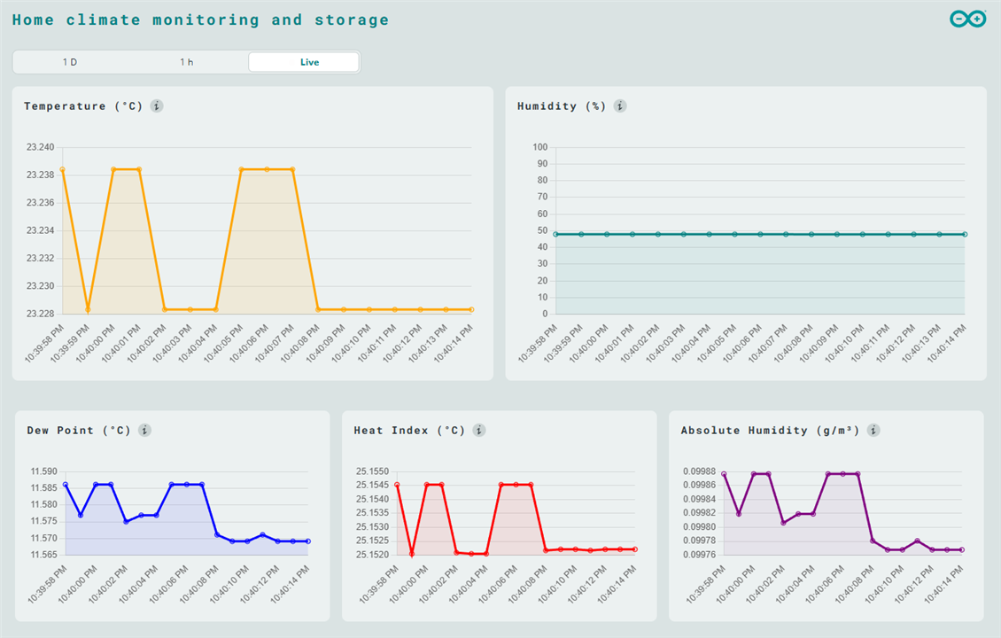

Home climate monitoring app with proximity detection
I have an Arduino Plug and Make Kit which includes an Arduino Uno R4 WiFi board with 7 Modulino modules and an aluminum baseplate.
  • Modulino® Knob: for super-fine value adjustments
  • Modulino® Pixels: eight LEDs to shine bright, dim down, or change color – you choose!
  • Modulino® Distance: a time-of-flight proximity sensor to measure distances with precision
  • Modulino® Movement: to perfectly capture movements like pitch, roll or tilt
  • Modulino® Buzzer: to generate your own alarm sounds or simple tunes
  • Modulino® Thermo: a sensor for both temperature and humidity data
  • Modulino® Buttons: three buttons for quick project navigation
I modified my Uno Q case so that I could attach it to the kit baseplate in place of the Uno R4.  I decided to modify the Home climate monitoring app to display the temperature on the Uno Q LED matrix.  I will use proximity detection to only display data when a person is detected within 500mm.  So in addition to the Thermo, I will need to add a Distance module.  The setup is shown below.
Here is a view of my app file structure.  Basically the same as the original app.
  • Two Bricks are used
    • Database for data storage
    • WebUI for the web browser based data display
  • Two Sketch Linraries are used
    • RouterBridge to enable communication between Linux and the MCU
    • Modulino that contains classes for all of the Modulino modules
  • Two primary app source files
    • Python - main.py
    • Sketch - sketch.ino
My new app just modifies the sketch.ino file

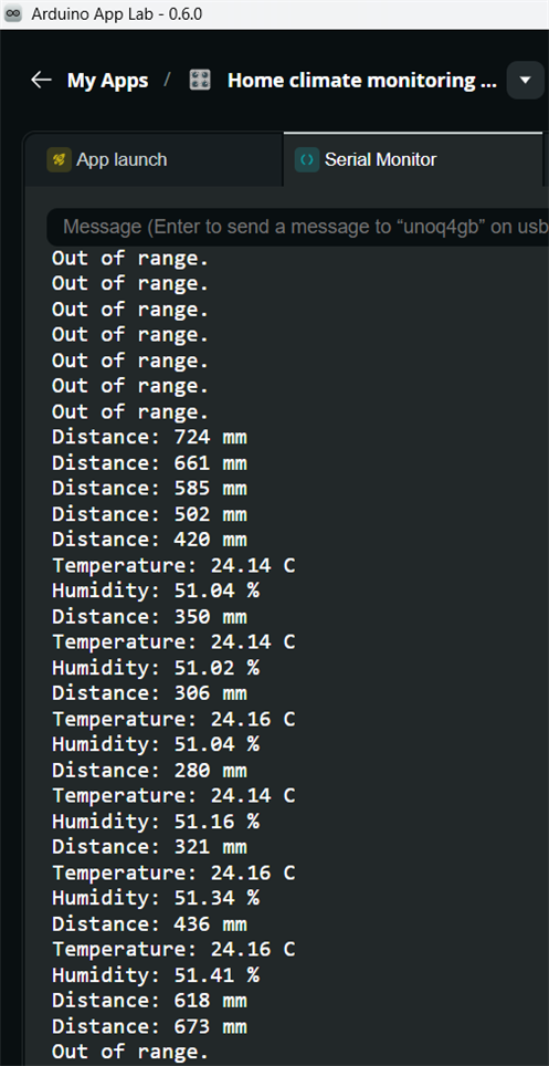

A quick demo of the app.
A Serial Monitor output shows the result of my approaching from beyond 2m (Out of range)
Then temperature and humidity data starts logging when I am within 500mm and stops when I am beyond it.
Video showing the same sequence on the Uno Q LED Matrix (displays temperature only within 500mm).

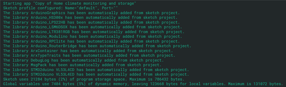

A quick video to get a sense of the time for the app to start from press of the "Run" button and time to stop from the press of the "Stop" button.
The text color switches from white to green when the action is complete.
