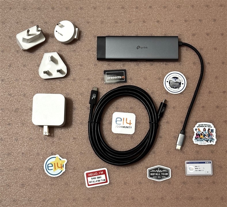

Received the shipment of the USB-C accessories for the roadtest.  Thanks OwainM  and E14Alice .  Stickers are a nice addition.
  • Multicomp Pro USB-C PD Power Supply 30W, MP009260
  • TP-Link USB-C 9-Port Hub
  • USB-C Cable 2M USB4 20Gbps
Multicomp Pro Power supply
USB-C PD 30W
  • 5.0V, 3.0A
  • 9.0V, 3.0A
  • 12.0V, 2.5A
  • 15.0V, 2.0A
  • 20.0V, 1.5A
The power supply comes with standard US type prongs and a set of international adapters.  Nice feature is that it uses a separate USB-C cable so that you can customize the installation length if required.  It has a different set of PD voltages than the RPi 27W power supply.
RPi USB-C PD 27W
  • 5.1V, 5.0A
  • 9.0V, 3.0A
  • 12.0V, 2.25A
  • 15.0V, 1.8A
The RPi supply has a capability of 5.0A at 5.1V, which probably would have provided better margin since the Uno Q only negotiates 5V power delivery.  So there would have been 10W of extra headroom.  The Uno Q should work fine with 15W unless high power accessories are added.  I didn't realize it earlier, but the RPi supply also uses 17AWG wire for power which is a significant advantage as most cables are currently using 20-22 AWG max.
TP-Link USB-C Hub
  • 1x HDMI, 4K@60Hz
  • 1x USB-C 3.0 PD, 100W
  • 1x RJ45, 1 Gbps
  • 1x SD, 1x uSD, 104 MBps
  • 1x USB-C 3.0, 5Gbps
  • 3x USB-A 3.0, 5Gbps
Nice hub.  It will allow for standalone operation with display, keyboard, mouse, and USB camera plus storage.
USB4 Cable
  • USB-C to USB-C
  • 2m length
  • EPR (Extended Power Range) - implies E-Marker chip
  • 20 Gbps
Not sure who the manufacturer is and there is no jacket marking, but it sort of looks like a Cables Direct logo on the connectors.  This should be a high performance cable, but I would have preferred a shorter length for my particular setup.

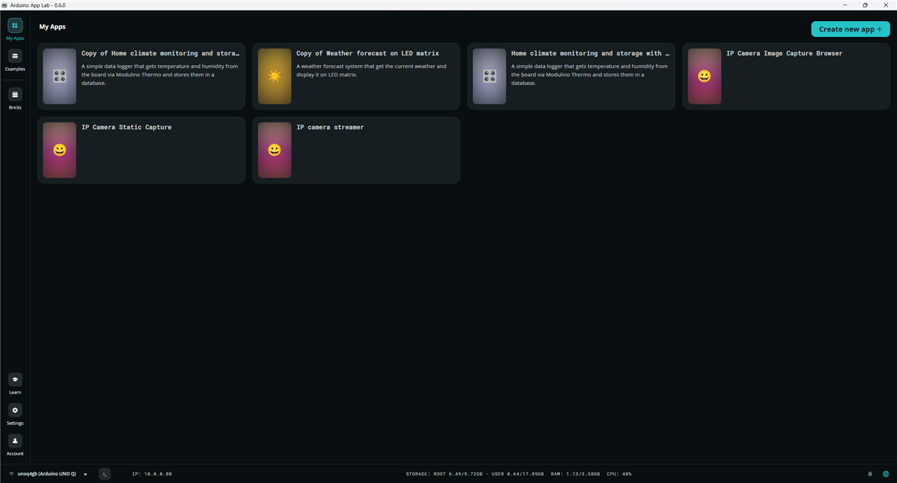

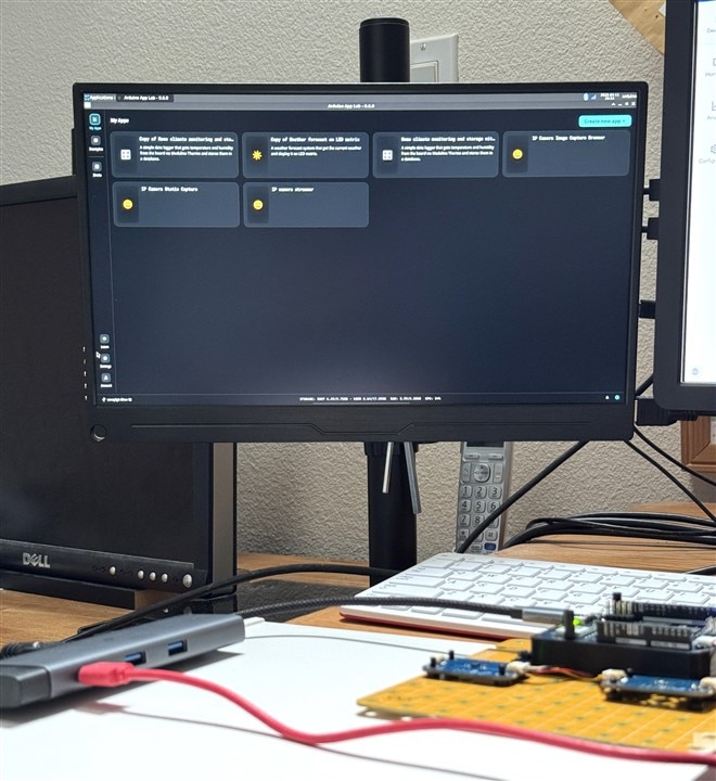

Time to run standalone using the hub.  I connected an RPi keyboard/mouse and a portable HDMI display.  Powered up with boot messages on the monitor and it ran through the familiar LED matrix animation.  Desktop opened with AppLab login.  After logging in I could see all the apps that I had been working on with AppLab running remotely on the PC.
And just for fun - opened AppLab on the PC and connected over WiFi and can see the same apps.  There are a couple of differences that I can spot.  The apps on the PC have colored backgrounds on the app icons.  The AppLab on the PC shows a network connection and the one on the Uno Q shows a USB connection.
The AppLab instances don't run in sync, i.e. when I ran the Home Climate app on the PC, I did not see it running on the Uno Q monitor.  It ran as expected and opened a browser window on my PC.  Likewise when I ran the same app on the Uno Q, I did not see it running on my PC.  This time it opened a browser window on the Uno Q using the localhost addr 172.0.0.1:700.
The one interesting thing that I did not initially realize is that if I look at the Run/Stop button in either AppLab instance, that they do track and I can stop the app from either AppLab.
I guess this is all expected behavior - lots to learn.

    It runs a Debian variant (Debian13 Trixie with XFCE desktop environment support)   I had already configured it earlier via a USB connection to the PC.  It initially requires login to AppLab and some configuration to get started, but after that runs like a normal Linux machine with login via desktop or SSH.   I could have configured it initially in SBC (standalone) mode, but I didn't have the hub when I started (needed for the added display/keyboard/mouse ports).
    Actually, the app always runs on the Uno Q.  It's really just two views of the running app and its output.  It's the output view that changes based where you start the app.  I'll have to go back and try it, but I think even though it only opened a localhost browser window on the Uno Q when I was running the local AppLab instance - that I could have manually started a browser window on the PC using the unoq_ipaddr:7000.  When running the PC AppLab instance the browser connection to unoq_ipaddr:7000 is started automatically.  No console or serial monitor would be available in the remote AppLab..
