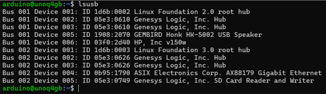

I did a quick check to see what USB devices were seen:
It sees the hub, hub Ethernet and SD card interfaces, and the USB speaker as Device 005 and the USB drive as Device 006.  I will be using the drive in the next mp3 player app.

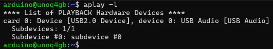

And that the audio player could ID the speaker:

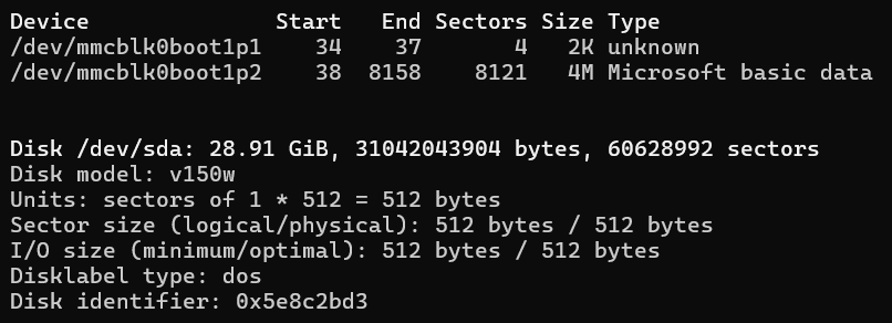

Next I thought it would be useful to create an mp3-player app that would play music stored on the USB drive.  This turned out be be a lot more challenging than I expected.  This seems like it would be a simple task with a Linux OS, but the difficulty arises with implementing it in the AppLab environment.  Apps in AppLab are created in a sandboxed environment that is implemented using Docker containers.  I didn't initially grasp the all the ramifications of this and I did what I usually do and created a global mount point for the USB drive.  Linux could see the drive which is an HP 150 32GB drive that I use to store a single MP3 file borrowed from a previous project.  It was found as Bus 001 Device 006 in the previous USB scan.  It is drive /dev/sda with partition /dev/sda1.
So, I mounted the partition on directory /mnt/usb and set access permissions for the user (arduino).  And it is initially empty except for a directory that HP puts on there by default.

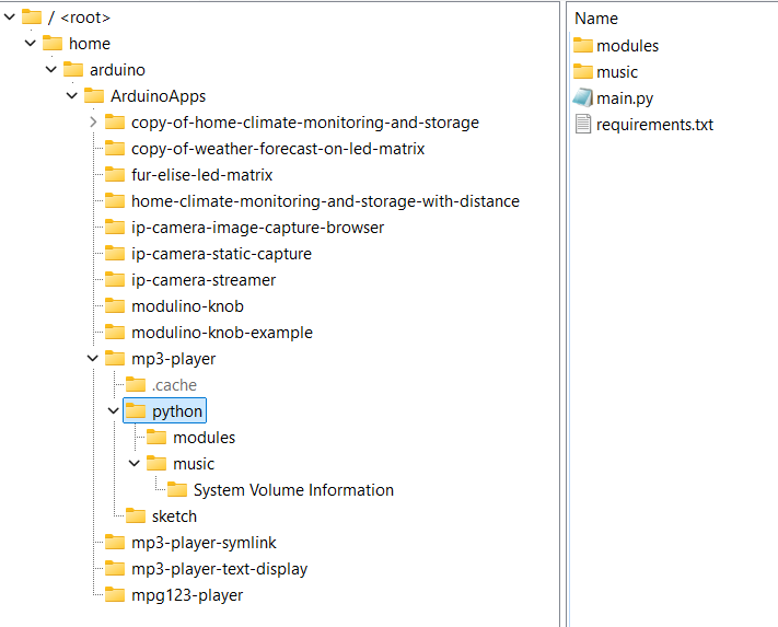

The program did not run in the AppLab environment because it could not find /mnt/usb or mpg123.  This is a feature of a sandboxed environment that I hadn't considered.  The sandbox is created to isolate the app from the host Linux environment so that a misbehaving app cannot crash the system.  One of the ways that it does this by restricting file and process access to within the sandbox, so it could not access either of these elements that I had created in the system environment.
What is somewhat confusing is that the system can see and access the app file structure.  You can see the files in the mp3-player app in the WinSCP window.  There are probably many ways to solve the file problem.  One way is to create a directory in the app file structure (music in this case) and just copy files from the /mnt/usb.  Or you can mount the USB drive directly to the music directory.  I've tried both and they both work (python code stays the same)  One thing that does not work in the sandbox is a symlink to /mnt/usb.  Depending on your development requirements you might try other solutions.

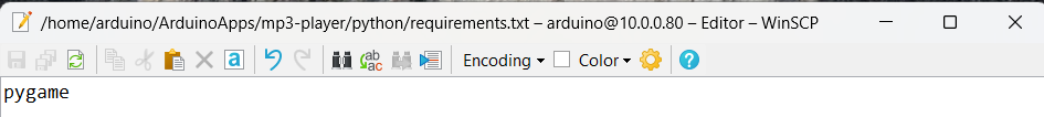

To solve the process/program problem I needed to install mpg123 in the sandbox python environment since it isn't installed by default.  The only way to currently install python programs in AppLab is to use requirements.txt  This requires that a package wheel is available for the program that you want to install.  It turns out that there is not a wheel currently available for python 3.13.5 which is installed in AppLab. And there is currently not the capability to build a binary from source (lots of tools missing).  So, I ended up searching for a different MP3 player and decided on pygame which is a bit more capable and resource heavy than mpg123.
With these changes the app worked.

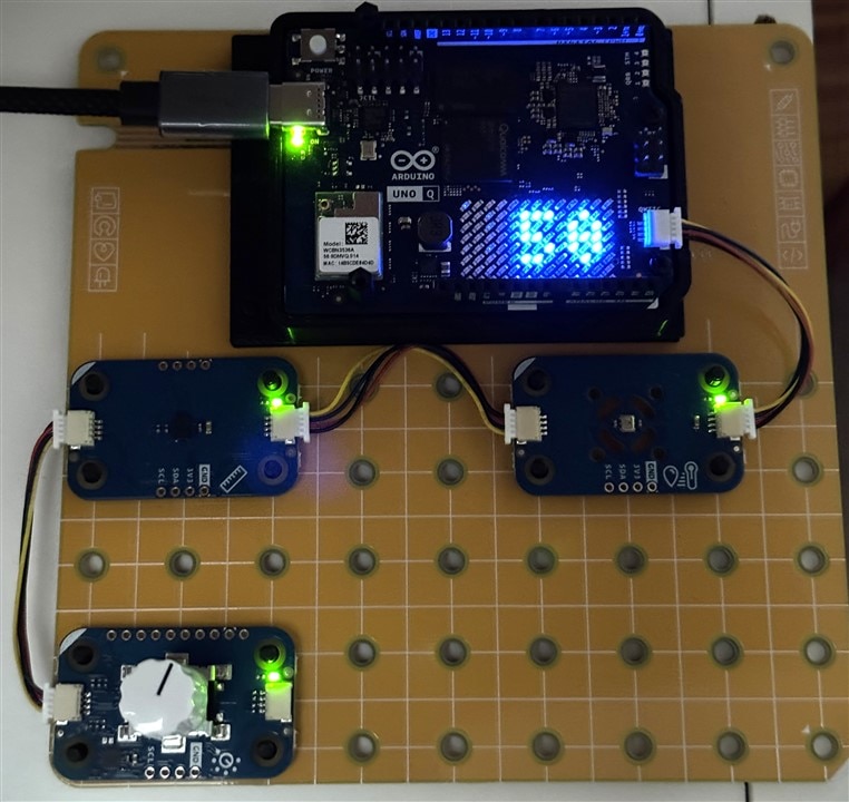

Since I have a Modulino Knob, I decided to add volume control and display the volume level on the LED matrix.  I initially intended to display the level as a "VU" meter style bar graph, but the 13 "pixel" horizontal resolution of the matrix is too coarse so I ended up just displaying the volume level as 0-100% in text.
This post has been way too long, so I'll just include the code and the demo video.
