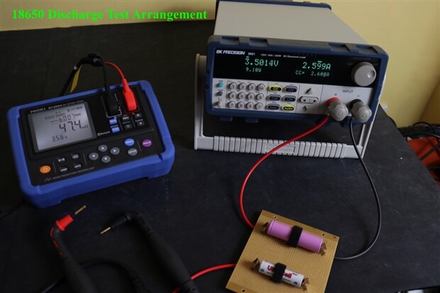

4.2 V Li-Ion Cell Test Set-up
Unlike the VRLA battery that can be wired directly to the load bank from its terminals and any measurements made are also directly from the terminals, the 18650 cell I have does not lend itself so well to this arrangement. I have some battery clips left over from another project, that I soldered to a piece of strip-board and test wires from these clips to the load. I can take a measurement from the back of the clips with the 18650 cell in position, so that will add to the overall AC resistance value obtained.
The 18650 cell is initially charged with a bespoke  charger circuit up to 4.7 V and is discharged down to 2.80 V. The discharge current this time is 2.6 A which is the nominal 0.2C rating for this cell. The manufacturer's data sheet is a bit light on AC resistance measurement, it again specifies a 1 kHz test signal, but merely states that the actual value is expected to be less then 100 mOhms for a fully charged cell.

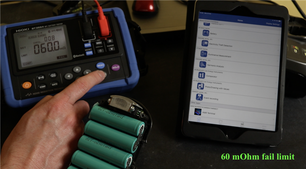

To further investigate AC resistance measurements on Li-Ion cells, I have a couple of old battery packs from Ryobi power tools, one of these battery packs has failed and will not charge up in the charger, so seems an ideal candidate to take a look at and investigate with the BT3554. One thing to note is that all of these battery packs are the smaller Ah packs with a single stack of cells within them, I can therefore measure the AC resistance of each cell. Larger Ah packs have multiple cell stacks and I would be reading the AC resistance of cells in parallel and not an individual cell. One slight disadvantage, is that in order to carry out the measurements, I have to break open the battery packs to gain access to each of the individual cells.
For these measurements, I utilised the Bluetooth function of the BT3554-01 to send the results straight to my iPad 4. For the second set of measurement, I sourced the data sheet for the specific cell within the Ryobi battery pack. The information on impedance measurement of this cell indicated that it should be below 30 mOhms with a 1 kHz test signal. I therefore set up limits within the BT3554-01 of 45 mOhms for a warning and 60 mOhms for a fail. These values are based upon the 1.5 and 2.0 times limits established for VRLA cells.
{gallery} 18650 cell limits
45 mOhm warning limit
60 mOhm fail limit
With the limits set up in the BT3554-01, there is a beep and the screen turns red momentarily when a measurement exceeds one of the limits. This function can be turned off if desired or altered so that the BT3554-01 beeps for a cell that passes the measurements. Note that the reading in the picture on the BT3554-01 is different to that on the iPad due to the slight delay in sending the readings to the iPad. By the time the iPad is updated, the screen is no longer showing the red warning.

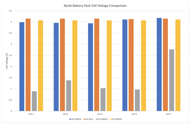

The test results are analysed after the failed battery pack is manually recovered using a power supply to charge the cells directly. The results are shown in the table below. The oldest battery pack, 02-2009, whilst it will still recharge, shows 3 cells that are below the nominal 4.2 V cell voltage. Two of those cells have AC resistance readings that exceed the alarm limit. In comparison the next battery pack, which is the youngest, shows all the cells at around 4.1 V and the AC resistance values are all less than 30 mOhms. Note also the low voltage and AC resistance differentials across these cells in comparison to the cells from the 02-2009 battery pack.
The 03-2009 battery pack that will not charge, shows very low cell voltages that are actually below the 2.5 V minimum discharge value from the manufacturer's specification sheet. One cell is above the minimum level and is the culprit fir the high differential across the voltages. Interestingly, the AC resistance readings for these cells are only slightly above the 30 mOhm limit for a new cell. The cell with the higher 2.77 V is below the 30 mOhm limit. It would appear then that the BT3554-01 is saying that the cells within the 03-2009 battery pack are in a reasonable condition despite the low voltage charge.
The final reading in the table, shows the cell measurements of the 03-2009 battery pack after the voltage on them was raised with a power supply and then the battery successfully charged on the Ryobi charger. All 5 cells are close to a 4.1 nominal voltage and the spread is down to 0.97%. The AC resistance values have also dropped to below the 30 mOhm level, but the spread remains similar to well the battery pack was discharged. It would appear then that the battery pack has been recovered and is potentially in a better condition than the 02-2009 battery pack.
The tabulated data is displayed in some bar graphs for those that prefer a more visual concept. The plots contain an extra set of values for the 02-2009 battery pack that I made to confirm the original readings and that there had been no test measurement errors.

Comparison of cell voltage measurements

Looking back at the measurements made with the BT3554-01 on the 02-2009, shows that there are three cells with a voltage around 3.9 V, two of those cells have an AC Resistance value around the 50 Ohm mark. This is over the 1.5 times warning value applied to VRLA cells. I decided to carry out a bit more work on the 02-2009 battery pack to see if it could be rejuvenated. A technique often used on a bank of Nickel Cadmium cells, when there is mismatch across their voltage values, is to over charge them for a duration. This is known as a boost or equalising charge. The same technique is also used on VRLA cells during commissioning after they have been installed.

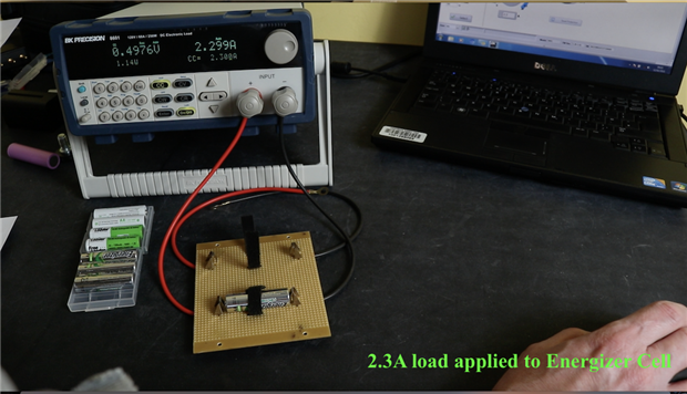

I have a batch of Nickel-Metal Hydride AA cells that I use for instruments and wireless keyboards and mice, and decided to give some of these the same treatment as the 18650 cells. They are of various different makes and ratings. The youngest cells are a batch from EBL, I purchased back in November and have 4 discharge/charge cycles accredited to them. The other main batch are Energizer cells and are in the region of 5 to 6 years old, I have no idea how many cycles they will have undergone. Thrown in between these are a set of FreeLoader cells are purchased with a minim USB charger, these are 3 to 4 years old, again the number of cycles is unknown.

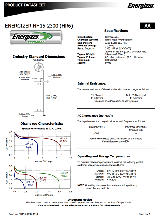

Manufacturer information on these cells is also hard to come by. Only Energizer produce specific information on AC Resistance measurements and capacity. The cells appear to be tested at a nominal 0.2C and then the data extrapolated to give a 1C rating. They do provide a nominal 12 mOhm figure for impedance measured at 1 kHz. However, it does specify a test current of 1A for this measurement, where as the BT3554-01 will only provide a maximum of 160 mA.

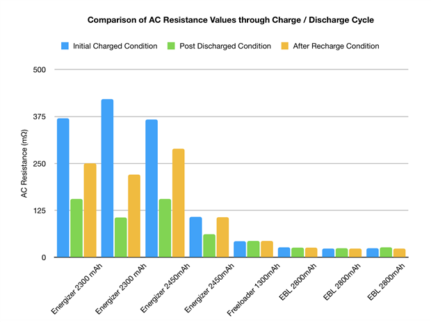

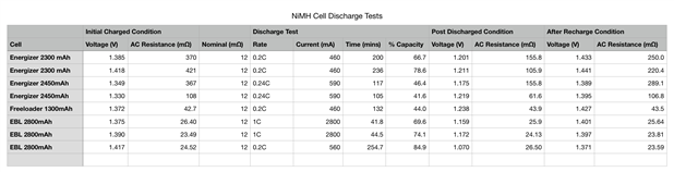

I carried out a number of discharge tests, measuring AC Resistance prior to the test, after the test and then after the recharge. All of the cells were charged on a universal charger from EBL. All cells were charged prior to the initial test and measurement.
The Energizer cells being the older, quite clearly had the higher readings and none were even close to the nominal 12 mOhm, although there seemed to be a good spread across the values for testing purposes. The EBL cells showed the lowest AC Resistance at the start of the tests, which was to be expected and the FreeLoader cell sat in between the EBL and Energizer cells. The EBL cells were twice the expectation of the Energizer cells but I do not have any information to say that the 12 mOhm is also applicable to other manufacturers cells.
All of the cells failed to reach their potential discharge rates. On top of that the Energizer cells with the high AC Resistance values could not be tested at 1C. At that load, the cell voltage instantly dropped down to 0.5 V as the load was applied, I didn't even get time to switch the voltage logging function on. The cells with the lower AC Resistance values could take a higher test current.
Some correlation can be seen between battery capacity and the AC Resistance, with the EBL cells with their lower AC Resistance, predominantly showing a better capacity, especially when tested at 0.2C. I am not sure that the practice of testing at a lower capacity and then extrapolating the data out to give a rating is particularly accurate, given the age of these cells. I may choose to get hold of a new set of Energizer cells at some point and test them at 0.2C, to see if the results improve.
Below are the discharge curves for the cells where a 0.2C discharge rate was applied. As can be seen none of them reached the 5 hours (300 minutes) specification. The EBL cell with the lowest AC Resistance shows a more gradual discharge. The two Equaliser cells with the high AC Resistance show a much higher initial voltage drop, due to a combination of the higher AC Resistance and the load current. They then show a more flat response until the end of the test.
The FreeLoader cell, has a low AC Resistance and so shows the small initial voltage drop similar to the EBL. It is then quite flat, until a sudden drop-off, that actually dropped all the way down to zero without giving me a chance to switch the load off. I think that this likely to be due more to the quality of the cell manufacture and is a bit of a red herring within the results.
Interestingly, all the cells that had a very high AC Resistance after charging, all saw a drop in their AC Resistance values after the discharge test. This is opposite to the VRLA and 18650, that all saw an increase in AC Resistance when discharged.
When the cells were recharged, the AC Resistance increase again, but not up to the same levels as previously seen. It could be that these older cells are suffering from only being partially discharged and a full discharge and recharge cycle has improved their state of health. The Freeloader and EBL cells, saw very little change across their AC Resistance values irrespective of their state of charge.
It would seem that the NiMH technology does respond to AC Resistance measurements, although the information from manufacturers to verify the readings does not seem to be as progressive as it does for other cell technologies.
