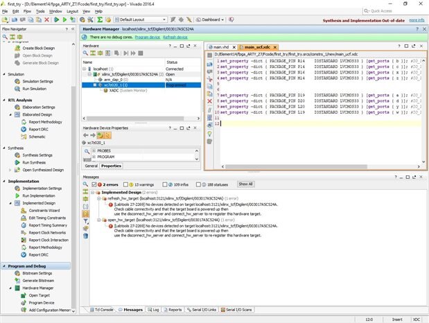

Here I have a simple .vhdl code and I programmed the fpga.The aim is to light 4 leds by pushing the 4 buttons on the dev board. I also took the necessary part from GITHUB and wrote the constraints file .xdc
Writing appropriate .xdc file to manage the constraints

This error appeared many times after reset and sometimes during on. Then you must re-fresh the project and if not then re-power the board again. At some point I thought the board is broken. But it is not true the FPGA became very hot and after I left turned off for few hours it was running good again.
Another mistake I also made often is the programming jumper should be set correctly to JTAG-QSPI to program bitstream.
