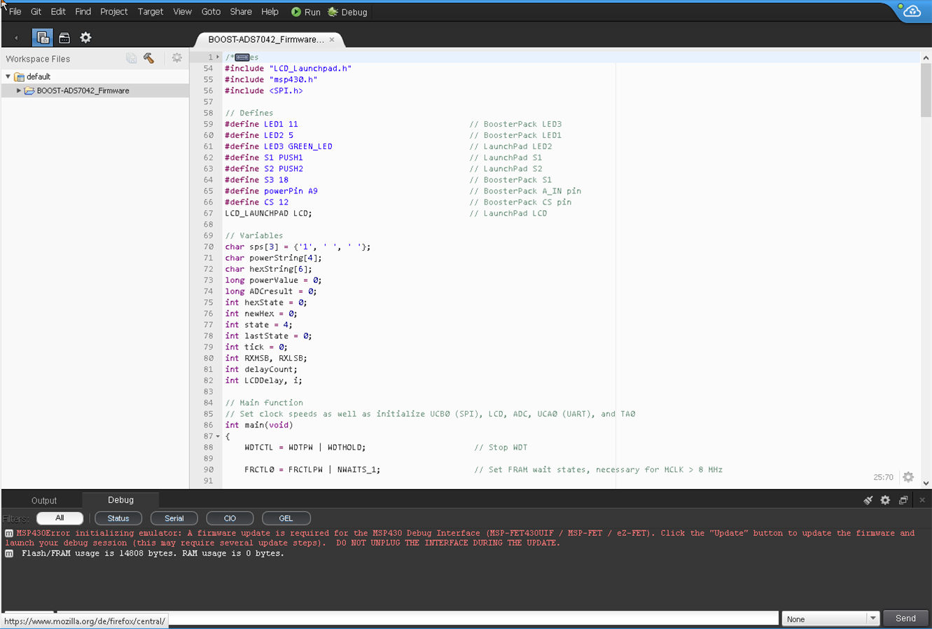

After few minutes the CCS Cloud-IDE was installed.
Then import the ADS firmware, -> Energia Sketch: BOOST-ADS7042_Firmware.ino
You will asked which LP you use.
Next, install the drivers for the Launchpad and the firmware for the booster board.
Klick: Target - connect to COM -> install -> the exe file will download to the c: user username.. Refresh the CCS Cloud - it will restart
Then in the local explorer klick the exe and install the drivers, the COM-USB driver also Programmer (may be the Software of the Launchpad will be upgraded).
Then refresh the Cloud-IDE
Klick Target - connect to COM - the connection will established

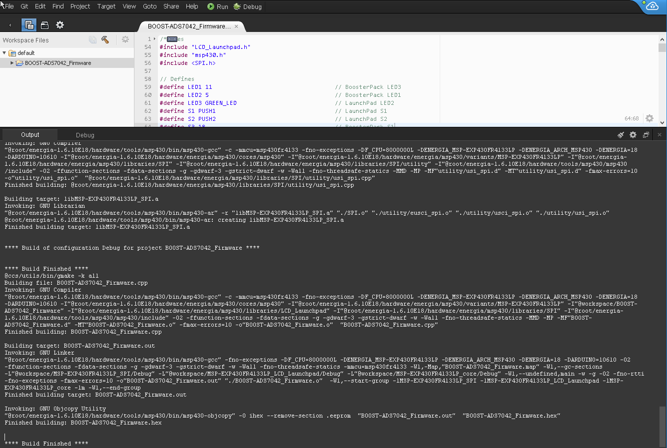

- download the sketch file
->> If all right in the CCS Cloud-IDE and also the connection, the firmware will downloaded and installed into the LP.
The target is now ready for operation.
