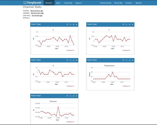

Embedding the sensor readout code with the ThingSpeak IOT platform. In the beginning I wanted to use Sparkfun open source IOT platform to stream the sensor data live but unfortunately the platform does not exist anymore. Another open platform is the https://thingspeak.com/  where anyone can publicly upload sensor data upto a certain limit. The Github code of Thinkspeak for ESP8266 is https://github.com/mathworks/thingspeak-arduino/blob/master/examples/ESP8266/WriteMultipleFields/WriteMultipleFields.ino
Reading out the sensor data on the IOT platform.
How the sensor readout in real time works. The data was taken since afternoon today and refreshes every 20seconds (as it is a free version of the IOT platform)

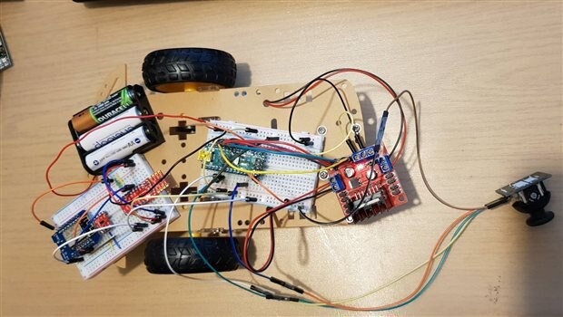

Finally combining the SolarBot project with the Infineon IOT sensors working together. The SolarBot was built in a previous project Simple Solar BOT  ----Blog 1
