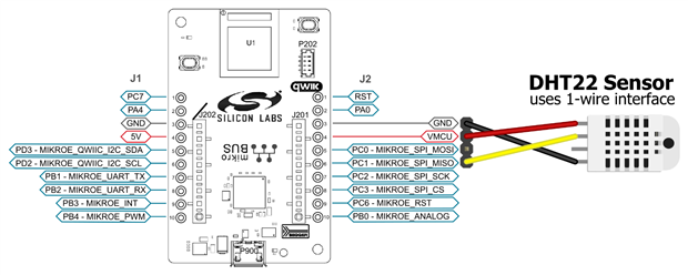

    • DHT22 Temperature and Humidity Sensor

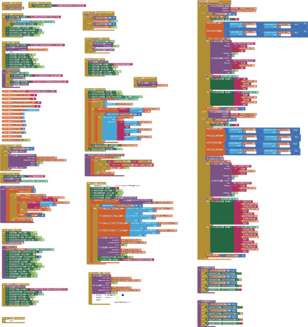

    • Custom Android OS Phone (BLE+MQTT) and Windows 10 Desktop (MQTT) Apps

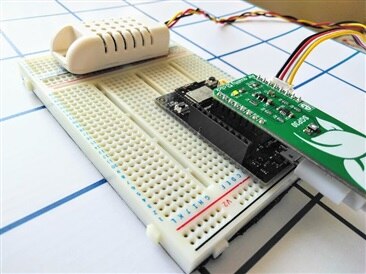

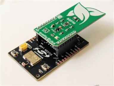

1. Introductionimage
This blog is about me exploring how to develop my own BLE Air Quality Sensor application using the Mikroe SGP30 Air Quality 4 click board and a Silicon Labs BGM220 Explorer Kit (BGM220-EK4314A).
The aim this project was to find the simplest and/or quickest method to get my application working. Knowing that I have a habit of over complicating things I knew this was going to be a trial and error exercise as I have limited experience using Simplicity Studio 5, the Gecko Bluetooth SDK and the BGM220 Explorer Kit. I have also not used this click before.
So where does one start?
Well, I suppose I could start by reviewing the documentation about the click.

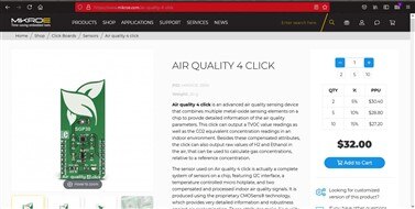

2. Mikroe’s SGP30 Air Quality 4 click
Mikroe.com

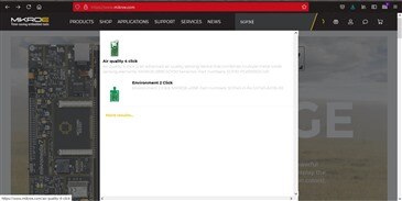

Opening the mikroe.com website on my browser, I typed “SGP30” in the search box and the Air quality 4 click appears as a search result.
Search resultsProduct Landing Page
On this click's product page, I’m informed that this click can output a TVOC value readings as well as the CO2 equivalent concentration readings in an indoor environment. The click can also output raw values of H2 and Ethanol in the air, which can be used to calculate gas concentrations, relative to a reference concentration. I am also informed that the device allows air humidity corrections over the results for both the compensated and raw values. However, a separate absolute humidity sensor will needed to obtain the humidity reading as this sensor is not provided on the click.
The documentation goes on to explain that this click takes care of delivering the required sensor operating supply voltage of 1.8V (max supply voltage for the SGP30 is 1.98V) using an onboard 500mA LDO voltage regulator (SPX3819M5) and it uses a PCA9306 dual bidirectional I2C bus and SMBus voltage level shifter for data comms.
Last but not least, we are told that the sensor uses the I2C interface.
Further down on the webpage the Specs and the Sensirion SGP30 datasheet are also included.

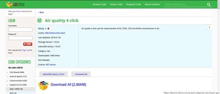

And software libraries?
Yes, a link is provided to their LibStock page at the bottom of the webpage. Here I was able to download a zip file containing a c library.
And here’s my first lesson learnt…

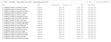

Selecting the big “Download All” option did not help as when opening up the downloaded zip file I am presented with a bunch of “MPKG” files. That's a file format I am not familiar with.
So what went wrong?
Well with a bit of pondering, and closer scrutiny, it appears that the older version (1.0.0.0) is presented first and not the latest version (2.0.0.0). The “Last Updated” field confirms that version 2 is the newer version (last updated on 2021-04-27).
So I downloaded this zip file, and success! I had some c code.

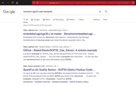

Searching for other SGP30 drivers online
Being heavily influenced by the Arduino ecosystem, I’m thinking that there’s bound to be something published online, so I undertook a keyword search using Google.
And, as shown above, when searching for “sensirion sgp30 code examples”, the top 3 search results on Google was a link to the Sensirion GitHub repository a Seed Studio Arduino example (also on GitHub) and a Hookup Guide for the Sparkfun SGP30 breakout. When I dropped “code” from the search term I was also presented with a link to the (NRND) SGP30 page on the Sensirion website.
However, there was still nothing specific to the BGM220 or any other Silicon Labs development boards.

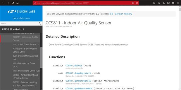

Broadening my search terms, I found a useful link when searching for “silicon labs air quality sensor example” on Google. I discovered that this was the same link that pops up when searching for “Air Quality” on silabs.com.
Still nothing specific to the BGM220, but the Silabs driver for the (CCS811) Cambridge CMOS Air Quality Sensor plus documentation on docs.silabs.com portal on how to use this driver was very useful.
I then also stumbled on a blog about this very sensor on element14: https://www.element14.com/community/people/koudelad/blog/2017/09/14/thunderboard-sense-board-experience

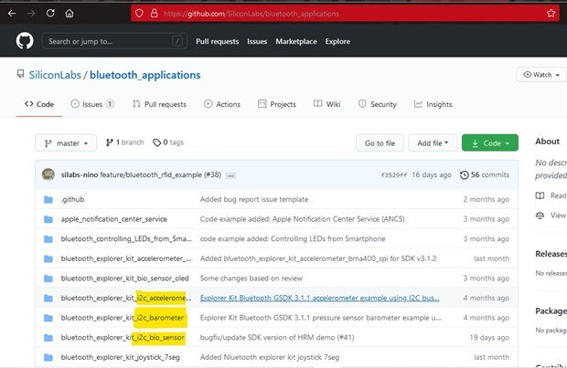

Silicon Labs GitHub page for I2C-based Bluetooth Applications
To close out my search efforts I decided to search on the Silicon Labs Github page. Here I found three bluetooth sensor examples which used the I2C bus.
So, this was not quite the copy and paste scenario I was hoping for to get the SGP30 working on the BGM220 board, but I now had all the building blocks I need.

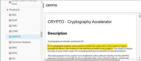

Having experimented with a few of the "platform" examples to understand the basics, I decided to use the "Platform - I/O Stream USART Bare-metal" example as this allowed me to send text to a serial terminal. Whilst the 2 I2C examples found on GitHub were useful they were not suitable to learn from, in my opinion, as each example applied the logic slightly differently and as I was road testing I wanted to rely on the documentation as best I could to see if I could build from the ground

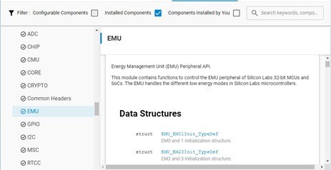

I found it difficult to work from the detail code libraries without understanding the big picture. Part of the problem stems from the fact that there are all these low level gecko SDK "em_" based code libraries, some of which are becoming deprecated, and then there are these higher level "sl_" based code wrappers, which simplify things to a degree. You are never sure which to include as headers and are never sure which functions are then more applicable. Here's one random example, where at least you're told not to use the "em_" library.
Then when you lack understanding of the architecture logic behind this philosophy and you find that there's no way-finding guidelines to help you navigate through the vast low level documentation vault and there is a general lack of code snippet type tutorials to get you started, you quickly find yourself in no mans land. The thing that rather annoyed me was that none of the function documentation, found in the Software Components tool or even on docs.silabs.com told you what the library name was to include.
Here is another random example, for Energy Management (EMU) where it does not tell you what library file or files to use. Instead, it just dives straight into all the data structures and functions. As someone learning I found this very frustrating especially as I found this problem to be throughout the SDK:

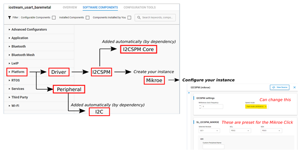

So it was quite arduous to build even the simple stuff like an I2C library, but I did it.
It's worth walking through the 2-step process I applied.

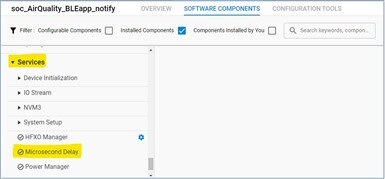

Step 1: Choose and configure your components from the Software Components tool. This can be somewhat confusing to start with as there is no obvious order prescribed and the documentation does not highlight the dependencies and what these dependencies do. So you tend to just add what you can until it works. What I rather liked about the BGM220 Explorer Kit's SDK is that there's two pre-made I2C instance names provided, one for the Mikroe click and one for the quiic connector. These instances then pre-populate the SDA and SCL pins associated with those configurations.
Step 2: Create your SGP30 drivers with the required I2C read / write and setup functions. As highlighted in the previous sections, I had a few code libraries to choose from. I had seriously considered the official Sensirion library option but struggled to get their library structure to fit with the Simplicity Studio example structure. So, as I had previously used the Sparkfun library with Arduino I decided to use this option as it looked the simplest to implement, even if the code could be written more efficiently. It was very easy to understand, which helps to get things going but now that I have the application working I will take another look at the Mikroe library.
With my code, I decided to bundle in all the I2C functionality into the driver files so that I only had a header and source file for the SGP30.
Then I create an application wrapper for the click board. This follows the same structure as all the other Simplicity Studio examples where an init() function is used to initialise the driver and then another repeat function to retrieve and/or write data. In my code example, a timer is also used to repeat the data request at the beginning as the sensor requires at least 15 seconds to warm up before meaningful data is returned.
The initial headache was working out which Gecko 3.1/3.2 header files to include in the code. Then it was trying to get the I2C transfer function to work correctly.

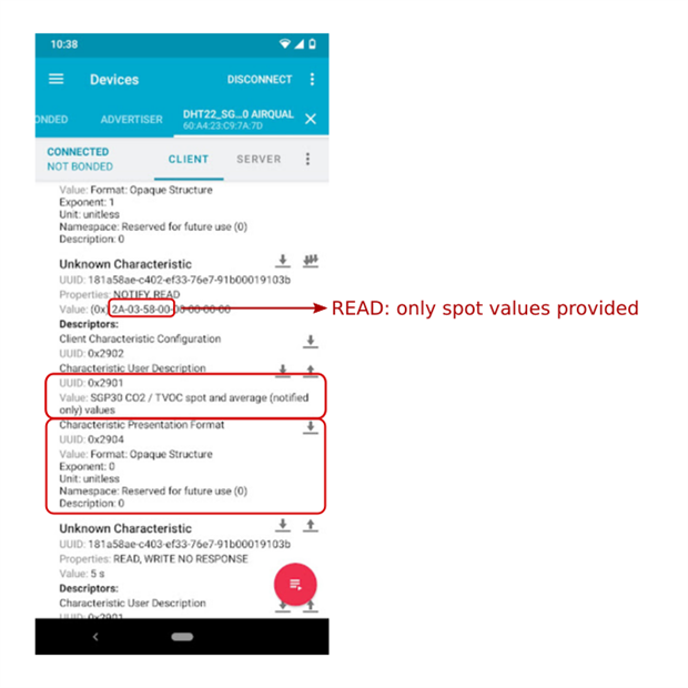

Based on experience with other Bluetooth SoC's I initially thought that getting the Bluetooth part working would be the harder part of project to complete. But it wasn't... to a degree.
With Simplicity Studio 5, Silicon Labs have really simplified the process of configuring GATT services and installing these services onto the stack that you can be viewed on a phone, for example. It is almost a drag and drop / low code setup.
What lets the system down is some of the quirks and software bugs, which no doubt will be ironed out as the system matures. So for now, if you stick with the basics it is quick and easy, but if you try dig deeper and customise parameters it does have bugs and niggles... I'll get back to this issue in my road test review.
Let me now demonstrate some of the features.

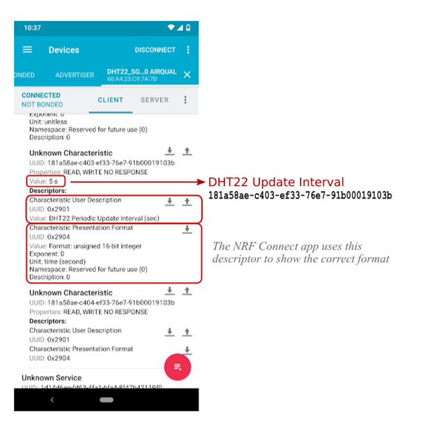

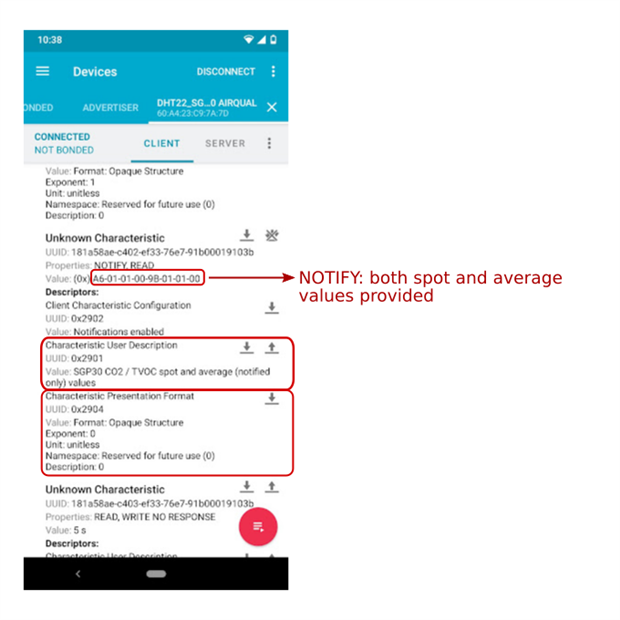

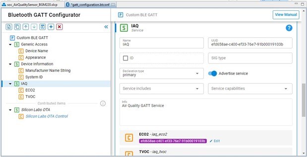

Here I demonstrate how to add in a new GATT service (in this case I'll add in a dummy Battery Service) into an existing example. It just so happened that Simplicity Studio released their Bluetooth SDK version 3.2 so I created a video demonstrating how this is done with the new Bluetooth SoC-blinky example.
I decided to stick with the methodology of using an XML file to create my GATT services. Note that this is not the recommended method to get started, especially if you are unfamiliar with this setup and also this method is quite buggy.
In most circumstances you would start with the Bluetooth GATT Configurator tool. This is a very user friendly set up. However, I found this tool a little slow for my liking as it does not have any keyboard shortcuts included. For example, if you want to delete an item you cannot use your keyboard delete key. Instead you have to click on the red X and then confirm for it to proceed. This gets tiresome quite quickly.
So, I started designing my GATT Database by looking at how the Thunderboard Sense 2 example created its Air Quality GATT service for the CCS811 air quality sensor. Here the Thunderboard Sense 2 example defined a custom Gatt Service named "IAQ" and then defined two Characteristics named "ECO2" and "TVOC".
<gatt>
  <!--IAQ-->
  <service advertise="false" name="IAQ" requirement="mandatory" type="primary" uuid="efd658ae-c400-ef33-76e7-91b00019103b">
    <informativeText/>
    <!--ECO2-->
    <characteristic id="iaq_eco2" name="ECO2" uuid="efd658ae-c401-ef33-76e7-91b00019103b">
      <informativeText/>
      <value length="2" type="user" variable_length="false"/>
      <properties read="true" read_requirement="optional"/>
    </characteristic>
    <!--TVOC-->
    <characteristic id="iaq_tvoc" name="TVOC" uuid="efd658ae-c402-ef33-76e7-91b00019103b">
      <informativeText/>
    </characteristic>
  </service>
</gatt>

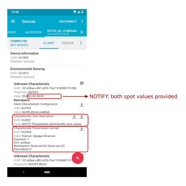

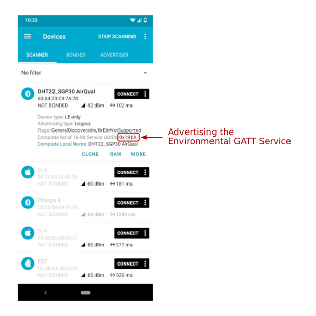

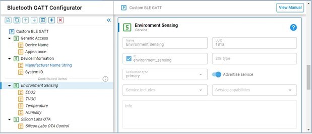

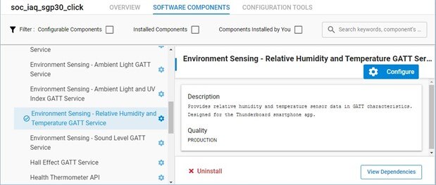

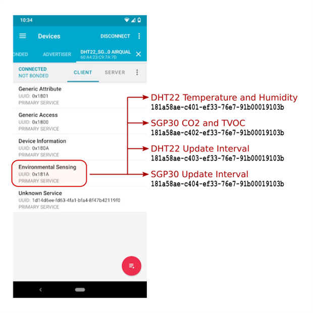

But this did not quite make sense to me, as I tend to think of Air Quality as an Environmental Service. So I changed my XML file have my two custom characteristics for CO2 and TVOC to be listed under Environmental Sensing (0x181A) and also have advertising set to true. I then gave it a custom name (gatt_service_airqual.xml):
<gatt>
  <!--IAQ-->
  <service advertise="true" id="environment_sensing" name="Environment Sensing" requirement="mandatory" type="primary" uuid="181a" instance_id="es_s1">
    <informativeText/>
    <!--ECO2-->
      <informativeText/>
      <!--Characteristic User Description-->
    </characteristic>
    <!--TVOC-->
      <informativeText/>
    </characteristic>
  </service>
</gatt>
The nice thing about Simplicity Studio is that this is imported in automatically if it is in the correct folder and all the field values are in the correct format - at the moment any error found prevents all the XML data to be loaded (and no error is given). Now I had the four characteristics listed within my Environmental Sensing Service. As you can see these are all listed as Contributed items on the Bluetooth GATT Configurator tool - note that you cannot edit any of the fields as they are all greyed out:
I was then scratching my head as to which example was the easiest to modify.

The secret ingredient here is adding in sl_bt_evt_gatt_server_user_read_request_id. This triggers each time a user makes a read request from a connected device, like a phone. From this event you can then split out the Characteristic ID's and call other functions like the two callback functions:
gas_eco2_read_cb
static void gas_eco2_read_cb(sl_bt_evt_gatt_server_user_read_request_t *data)
  sl_status_t sc;
  // update measurement data
  if (!gas_updated) gas_update();
  sc = sl_bt_gatt_server_send_user_read_response(
    data->connection,
    data->characteristic,
    0,
    sizeof(gas_eco2),
    (uint8_t*)&gas_eco2,
    NULL);
  app_assert_status(sc);
and gas_tvoc_read_cb.
I decided to add in a DHT22 temperature and humidity sensor to measure humidity values, as I had one available and I wanted to test out microsecond timings using a 1-wire custom GPIO interface with the BGM220P module.
To configure my SS5 project to handle the DHT22 sensor I first needed to add in a new component, which was the “Microsecond Delay” component.
What is interesting about this component is that the delay function is designed to not use any hardware peripherals and instead uses a while loop, based on the frequency of the MCU core clock. The documentation informs us that it is only suitable for very small delays.
What I also liked about this function is that within the function’s code it gave me a method to measure the number of ticks and convert this to a pulse duration using the MCU clock frequency.
I then needed to define my signal port and pin number, and configure my input and output modes. Here I used  #define:
#define GPIO_DHT22PIN                  gpioPortC, 1
#define GPIO_DHT22PIN_INPUTMODE        gpioModeInputPullFilter
#define GPIO_DHT22PIN_OUTPUTMODE   gpioModePushPull
I then created an initialisation function for the sensor, where I used the SystemCoreClockGet() to determine my “maxcycles” parameter.
void dht22_init(void)
  CMU_ClockEnable(cmuClock_GPIO, true);
  GPIO_PinModeSet(GPIO_DHT22PIN,
                  GPIO_DHT22PIN_INPUTMODE,
                  GPIO_DHT22PIN_HIGH);
  // First we set out max cycles to represent a 1ms timeout
  maxcycles = SystemCoreClockGet() / 1000U;
I then created a “dht22_read()” function, which is the core function for the sensor. Within this function, the timings are critical and here I used the Atomic functions to set this as critical:
CORE_DECLARE_IRQ_STATE;
CORE_ENTER_ATOMIC();
Then after the critical timings section of the code I closed the section off with a:
CORE_EXIT_ATOMIC();
The rest of the library code is fairly self explanatory as it follows similar logic to the Adafruit DHT Sensor library (it’s basically a port of the code).

Modifying the Environmental Sensing GATT Service
When I created the original code, I could quickly see how messy the code had become simply because the Environmental GATT service had defined separate characteristics for CO2, TVOC, mock Temperature and mock Relative Humidity value.
This made no sense from a coding and performance point of view, in light of how much data you could transmit across using the Bluetooth Low Energy Protocol - the Maximum Transmission Unit (MTU) is the maximum length of an ATT packet and the minimum length of the MTU ATT packet is 23 bytes.
As the SGP30 returns both the equivalent CO2 and TVOC values upon a single code request, and similarly the DHT22 does the same by returning both a Temperature and Relative Humidity value when requested, it made more sense to create just two characteristics which would transmit a composite byte array for each sensor.

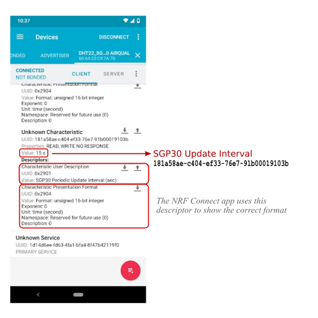

Thus for the revisited app, I decided to create one characteristic for the SGP30 sensor and one characteristic for the DHT22 sensor and use byte arrays to transmit the data. Thus the characteristic for the SGP30 sensor transmits 4 x uint16 data types and the characteristic for the DHT22 sensor transmits 2 x int16 data types.
Then, as I wanted to create an app which could be used for data analysis I set the property for each characteristic to notify. An optional read property was added to the SGP30 characteristic to provide spot values at given moment rather than the notify option which was set at a periodic interval of 15 seconds.
Two additional read / write characteristics were added to allow the user to change the periodic update intervals for both the SGP30 and DHT22 sensors.
{gallery:autoplay=false} BLE application structure
Then for the core application logic (app.c) I flattened out my original example so that most logic is handled within app.c with direct function calls to sgp30 and dht22 libraries:

 * Callback function for SGP30 spot values read event.
  * @param[in] data component used for response
static void sgp30_readrequest_cb(sl_bt_evt_gatt_server_user_read_request_t *data)
  uint8_t sgp30buf[8] = { 0 };    // two bytes for each CO2 and TVOC spot value (average values left at zero)
  sgp30_measurement_vals_to_buf(_CO2, _TVOC, 0, 0, sgp30buf);
    data->connection,
    0,
    sizeof(sgp30buf),
    (uint8_t*)&sgp30buf,
    NULL);

 * SGP30 CO2 and TVOC Measurement characteristic's CCCD has changed.
 * Environmental Sensing - CO2 and TVOC Measurement from SGP30 sensor
 * Notification changed callback
 * Called when notification of sgp30 measurement is enabled/disabled by
 * the client.
static void sl_bt_es_sgp30_notification_changed_cb(uint8_t connection, sl_bt_gatt_client_config_flag_t client_config)
  (void)connection;
  (void)client_config;
  app_connection = connection;
  // Indication or notification enabled.
  if (sl_bt_gatt_notification == client_config) {
    app_log_info("SGP30 Notifications enabled\n");
  // Notifications disabled.
  else {
    app_log_info("SGP30 Notifications disabled\n");
To develop my custom Android BLE phone app, I could’ve gone with Google's UI toolkit flutter.dev as it allows you to deploy both IOS and Android OS apps from just one code base, but instead I stuck with MIT App Inventor, the no-code solution to developing apps (this too now allows you to deploy apps for both IOS and Android).
My decision was narrowly based on the fact that I could reuse previous project “code” or blocks, such as the app I developed for the BGX13P road test (see comments below road test review).
So there was not much to add to this app, other than adding in the MQTT extension. Here I used this open source extension from Ullis Roboter: https://ullisroboterseite.de/android-AI2-PahoMQTT-en.html
