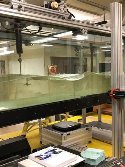

I'm not sure what to set the limits at yet, so I filled the tank and ran the motor at "Normal" experiment settings.
The Tank:

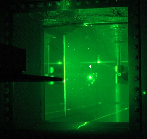

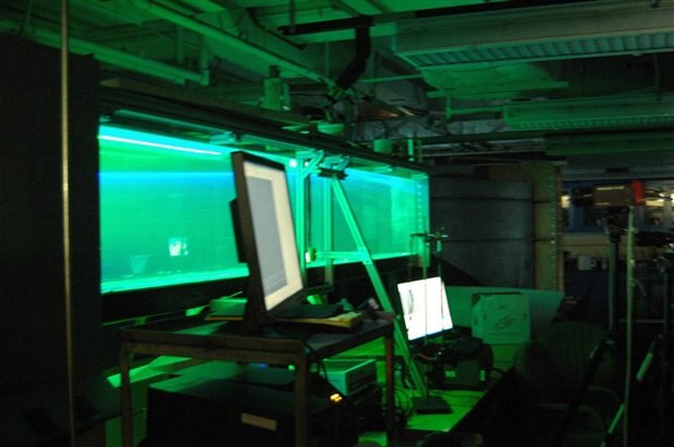

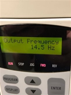

The application is a 1500 gal hydrodynamic water tunnel ( flume)
https://en.wikipedia.org/wiki/Water_tunnel_(hydrodynamic)
We fill the tank to a specified height and seed the water with PIV particles.  Then we shine a laser sheet in the area of interest and measure the flow around
the test article using video capture software.  The flow is controlled by a LabView script by changing the motor/pump speed.  The motor is 20HP, and uses a marine propeller
to move the water through the system.
https://en.wikipedia.org/wiki/Particle_image_velocimetry
The Eaton breaker powers (and now monitors) the pump motor.

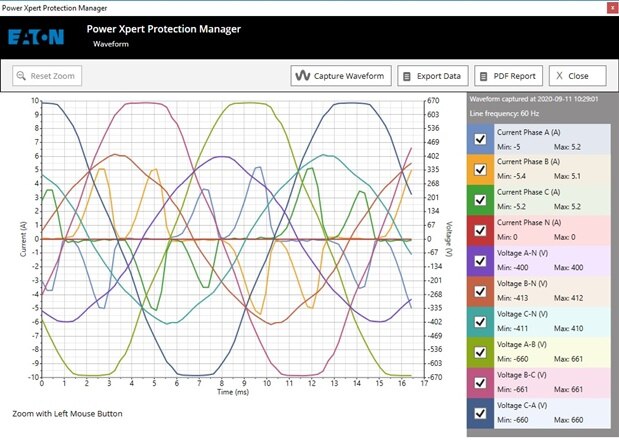

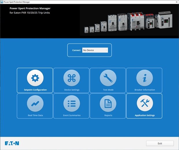

I used the diagnostic port to capture the circuit activity using the Eaton Power Xpert Protection Manager software.
This capture was taken at about 25% max motor speed (0-70Hz PWM)
The flow in the tank was about 0.6 m/s with the tank approx. 30% full.
I need to run some more tests with maximum loads to determine where to set the trip unit limits.
I think I may try and connect the Modbus to the LabView computer to capture the data real-time.
