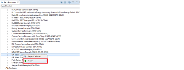

The procedure is fairly standardised, so we follow instructions as per user guide, starting with selecting our example via the CMSIS Packs perspective.
Then, as before, we right-click on mouse and copy the project into our workspace.

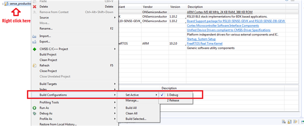

Then, once the project is loaded in the Project Explorer folder we can choose our build configuration. This time we use the DEBUG option.
Once the build is done, the code is ready to be flashed to the board.

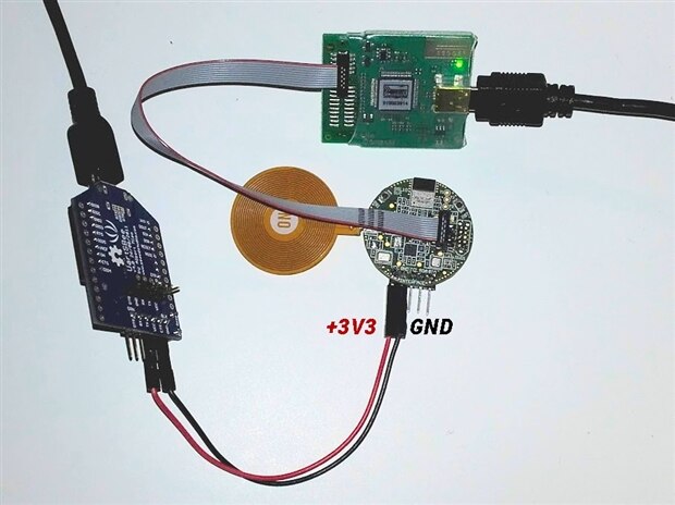

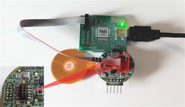

I soldered a 10-pin header onto my RSL10−SENSE−GEVK board to allow me to use the Segger J-Link Lite CortexM debugger.
To flash this board, we follow the User Manual instructions:
[1] Connect the J-Link Debugger SWD ribbon cable to the board as shown in the picture.
[2] Make sure the CR2032 battery is inserted into the board –  alternatively, you can power using 3V3, or less, via the pinout (but then make sure to remove the battery beforehand), as shown here. Powering the board is a mandatory step as it creates the voltage reference for SWD logic signals. In my opinion, when developing code, it is better to power without battery.

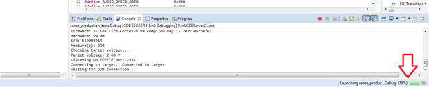

[3] Go to IDE's top menu and select Run → Debug Configurations...
[4] We can now click the "Debug" button.
This will usually trigger a dialog popup asking us to confirm a perspective switch when we click "Yes". If you've run debugger before this request (assuming you did not select the "Remember my decision") will happen after the debugger launched and before the "resume" option comes up.
Launching debugger can sometimes take awhile. You can watch progress on bottom right of screen.

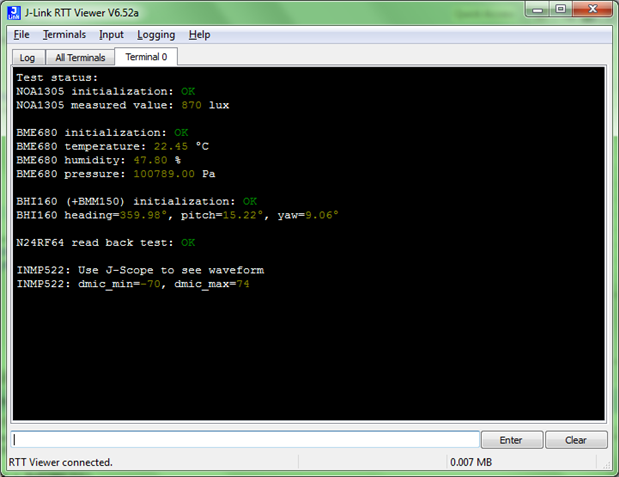

When perspective has changed, you then click on "Resume (F8)" to execute the code on the board.
To view the debugger output we need to launch the terminal console.
This is where I found the documentation to be a little confusing. For a start, the project readme.html instructions differs somewhat from the User Guide instructions. Anyhow, I suspect that part of the problem is my lack of experience using the Segger debugger.
Here is a video demo capturing my experiences executing this program and running through the various tests.

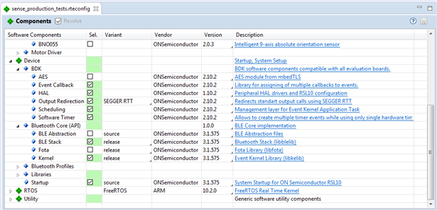

2.3.1     sense_production_tests.rteconfig
According to the User Guide, the *.rteconfig file lists the software components within the CMSIS pack.
So for this project we have:
{gallery:autoplay=false} rteconfig

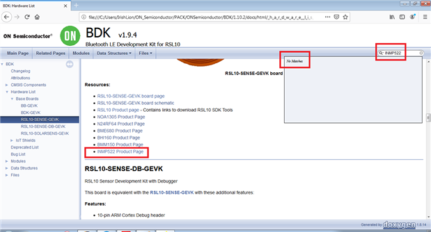

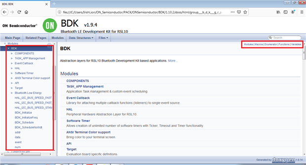

As you may have noticed, many of the Descriptions given are hyperlinked. So, if we click on one of those links it opens up further documentation.
Let's look at some of those links, starting with the one provided in the User Guide for the Device BDK:
The document is divided into a number of bookmarks or subsections, namely: Modules, Macros, Functions, and Variables. Then, on the left, there are plenty of drill down options available. The items listed on the left are the same as those shown in the Modules section.
So, for example, if we clicked on “COMPONENTS”, we get the following:
Then if we drill down further, into say the I2C Eeprom Library we get this page, which then also has a number of subsections (as shown on the top right), etc.:
So, the documentation looks pretty good once you get familiar with it.
However, one thing I found was that the Search box does not seem to work. I tried putting in the term “INMP522” and it returned “No Matches” even though that term was listed on the page I was on.

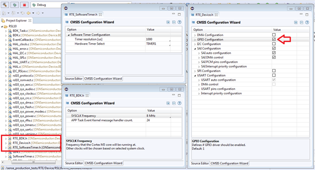

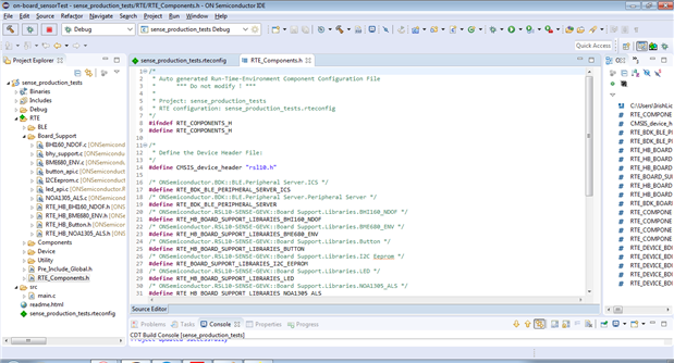

2.3.2     The “RTE” folder
The User Guide also mentions that System settings can be configured directly from within the CMSIS pack via the RTE folder. It mentions that “Each example is equipped with basic system
configuration that covers three main categories”. Let's try and make sense of this.
First, we know from the User Guide that each system configuration starts with “RTE_”.
Then, we can use the CMSIS configuration wizard (right click on the header file), to display the configuration table.
There are also configuration options found in the Device->RSL10 folder. This key one here is the GPIO configuration:
The one that does not appear to provide configuration settings options is “RTE_Components.h”
And that is basically it, regarding what I know about documentation and configuration settings via the IDE.

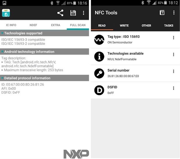

However, because the EEPROM is not formatted for NDEF or NCI Tag, I could read the information when I presented the RSL10-SENSE antenna to my PN7150 NFC controller. This is the output I get:
When reading via a phone app we also get the relevant information as per the PN7150 controller:
As such, if I wanted to read any NFC data, I would need to modify this code. I was thinking that probably the easier method, or at least the method I would start with, would be NDEF and I will be looking at my previous blog for guidance:

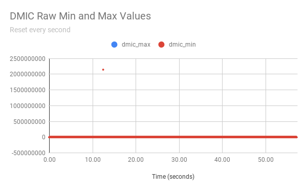

Having digested the Adafruit learning guide, I decided to add in a Sound Pressure Level calculation, this time in dB's, and then I also took these measurements and added in some more logic to determine if a clap or loud knock is detected, which is similar to the Arduino clap detector example found in the ArduinoSound library.
To calculate Sound Pressure Level we need to know the amplitude, which can be determined with the minimum and maximum values of a sample of values.
If you look at the original code (as shown above) you will notice that there are two variables dmic_min and dmic_max. In the above video you would have seen that these are shown in the Segger RTT Viewer terminal view. I have a screen shot of that view here:
But, I noticed something odd with the max value. It always shows a max value as the maximum value of an INT16 data type and this value never changes. Then another thing I noticed is that the min and max values are never reset during runtime in the code, so it just provides us with a man/max for the period the device is powered on, which is not what we need for determining a dynamic sound pressure level.
We can make simple modification though.
printf("INMP522: dmic_min=" COLORIZE("%ld", YELLOW) ", dmic_max=" COLORIZE("%ld", YELLOW) "\r\n", dmic_min, dmic_max);
 dmic_min = 0;
 dmic_max = 0;
By resetting the values after the print statement we will get a min and max value for every second the printf is updated. I worked out that the sample rate via the interrupt is approximately 30kHz.
Anyway, you will notice that I set them at a zero value. The reason for this is that I when using J-Scope to monitor these values we can get spurious values because of the way J-Scope extracts the value at a specified frequency. I managed to capture this in another test I did. We will get back to that test.
So, by resetting the min and max we get much better results - so, it appears to me that the spurious values are caused at device power up, for some reason.
However, the issue here is that I could not readily normalise all 30,000 values as per the Adafruit code logic. So, I chose a sampling method to capture 128 values per second. Hence every 234 increments in the interrupt routine I update a value and this is rolled through in my cicular array, so that my 128 value buffer is updated approximately every 8ms. Code logic is as follows:
