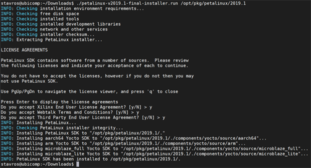

I started building the latest PetaLinux on an Ubuntu host by following the Getting started guide:
https://reference.digilentinc.com/reference/programmable-logic/genesys-zu/getting-started
First, I need to download and install PetaLinux tools:
source the PetaLinux environment:
disable statistics send to Xilinx:

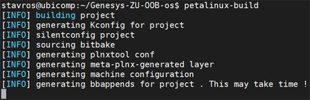

next step is to clone the PetaLinux repository for Genesys ZU from github (https://github.com/Digilent/Genesys-ZU-OOB-os)
cd into the repo directory and run petalinux-build and wait for the project to build
the actual process fetches the necessary packages in order to build and configure the linux boot image:
when done
and now ready to package everything to BOOT.bin binary:
Finally, copy both the generated BOOT.bin and image.ub inside the SD card.
