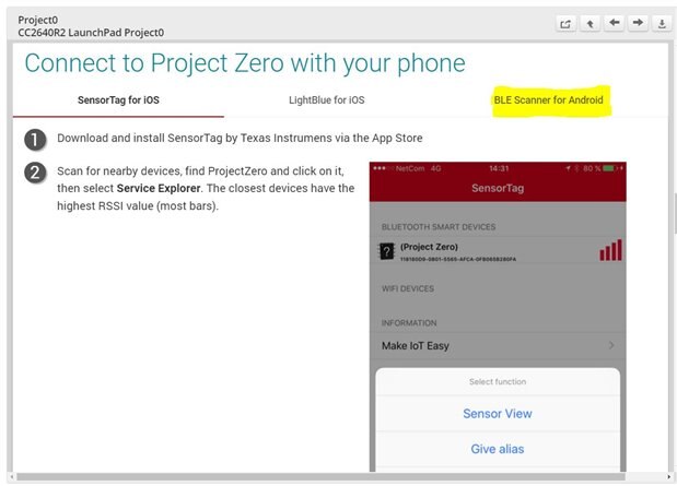

The next section "Connect to Project Zero with your phone" didn't quite work out for me to start with as I was not paying attention to the text. At first, I tried to test the example using the TI SimpleLink App I just downloaded for the OOB demo. But this does not work and was left pondering why (I missed seeing the tab on the screen for Android).
I used the nRF Connect App from Nordic, which works just as well as the BLE Scanner App. I was able to use the LED service (0x1110) to turn on and off the red and green LEDs. With the button service (0x1120) you have to turn on notifications and my app detected the button presses (state change). With the data service (0x1130) I sent a text string "hello" and this was displayed in the log message on the UART serial monitor.
