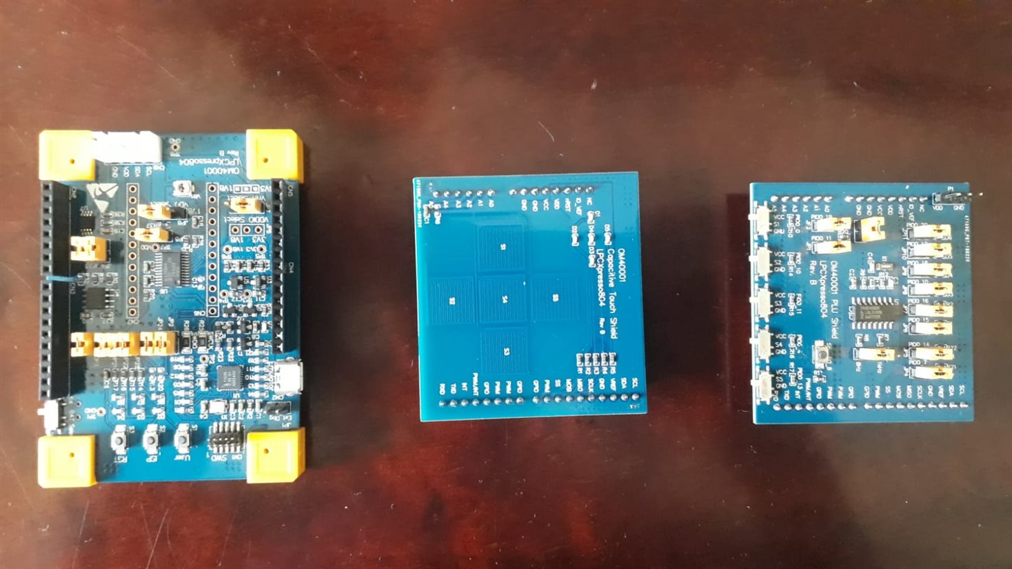

Today I will teach how can you take the first step with LPCXpresso804 Development KIT from NXP.

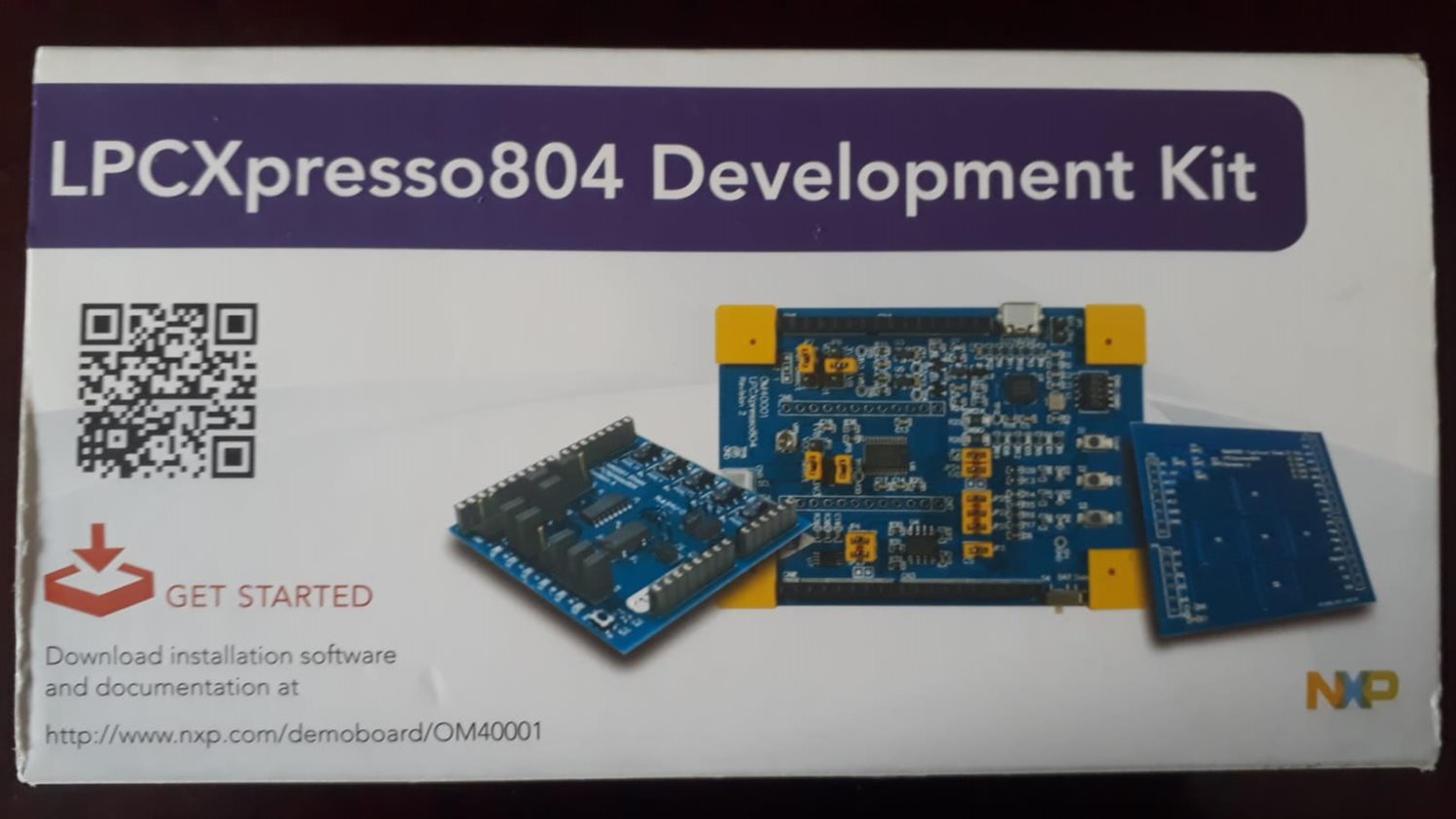

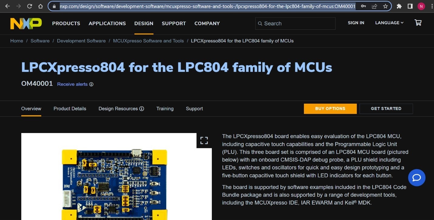

  1. On the box lower left side, you can see an URL (http://www.nxp.com/demoboard/OM40001), click at that or copy and paste at your preference browser, will open that page.

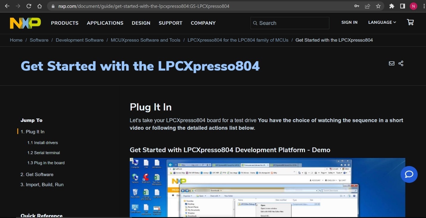

  2. Here you can see a lot of information, and you must click at the button "GET STARTED" to take the first step.
  1. Here you will download the Demo to test your board and make the first connection between the board and PC.

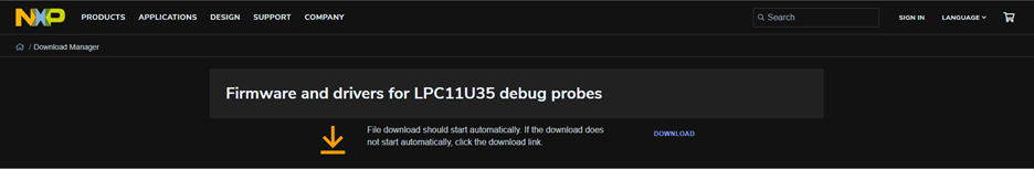

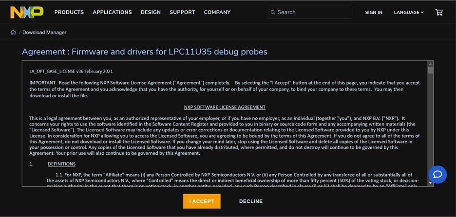

  1. First step to begin, is download the drivers, if you click here will open the page bellow, click at the button "I ACCEPT" and download the drivers, normally the download will begin automatically but if it doesn't click "DOWNLOAD"

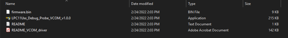

  1. Downloaded the zip folder, extract all, I recommend create a folder to organize all files about LPCXpresso804
  2. Complete the extraction, you will have some files like this, double click at the file named "LPC11Uxx_Debug_Probe_VCOM_v1.0.0" will open a window, you have to click "next, install, next and finish".

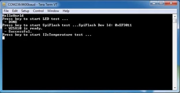

  1. I use Tera Term, so I downloaded it, now plug your board at your PC and double click to launch the app, now you must select the serial button, and select the board Port like the image bellow, in my case the board are connected by COM3.
  1. If you don't know where your board are connected in, search at your PC "DEVICE MANAGER", and go to the option "Ports (COM & LPT)".
Follow the steps bellow to run the DEMO program.

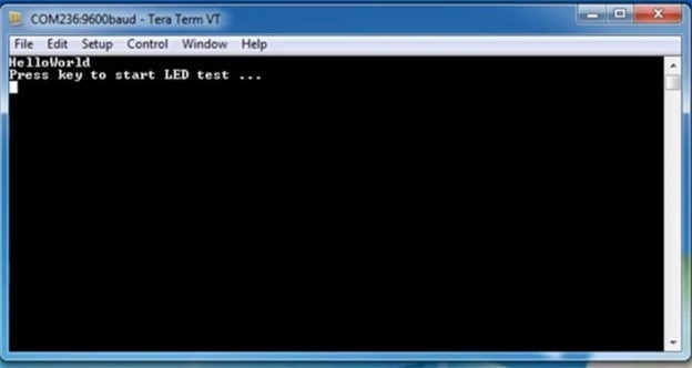

    • The Blue user LED will flash 3 times, then the green LED will flash 3 times, and the terminal will display “HelloWorld”, followed by “Press key to start LED test …”
    • Press the ISP button (S2). The green and blue user LEDs will flash, then each LED will be lit in turn twice before all three blink 3 times. The terminal will show “DONE”.
    • The terminal will show “Press key to start SpiFlash test”. Press the ISP button. The LEDs will blink as the test is run, and the SPI flash device ID and name will be shown on the terminal.
    • The terminal will show “Press key to start I2cTemperature test …”. Press the ISP button to run this test, which checks communication with the LM75 temperature sensor.

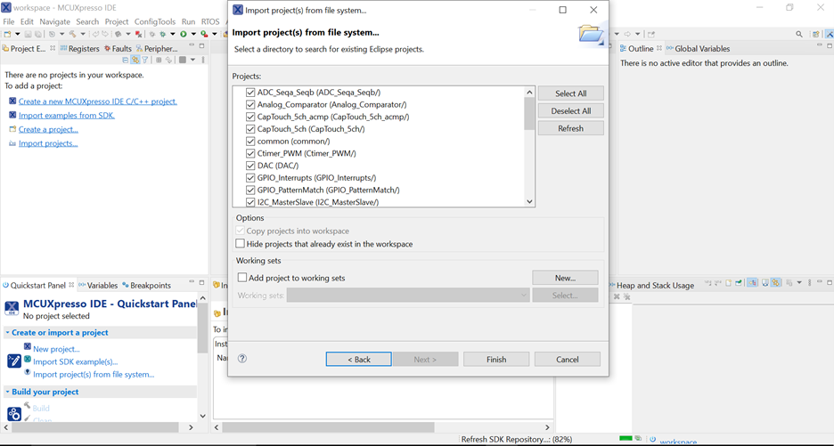

  1. So, let's do this, click in "IMPORT PROJECT FROM FILE SYSTEM..."
The window bellow will open:
  1. Click at the button "Browse" from "PROJECT ARCHIVE(zip)" and Browse for the zipped folder named "LPC804-EX-CODE-MCUXPRESSO" (From this Hyperlink you can get all codes you will use), if you use the wrong folder you will have an error which you can't compile nor debug the program because you using the wrong board.

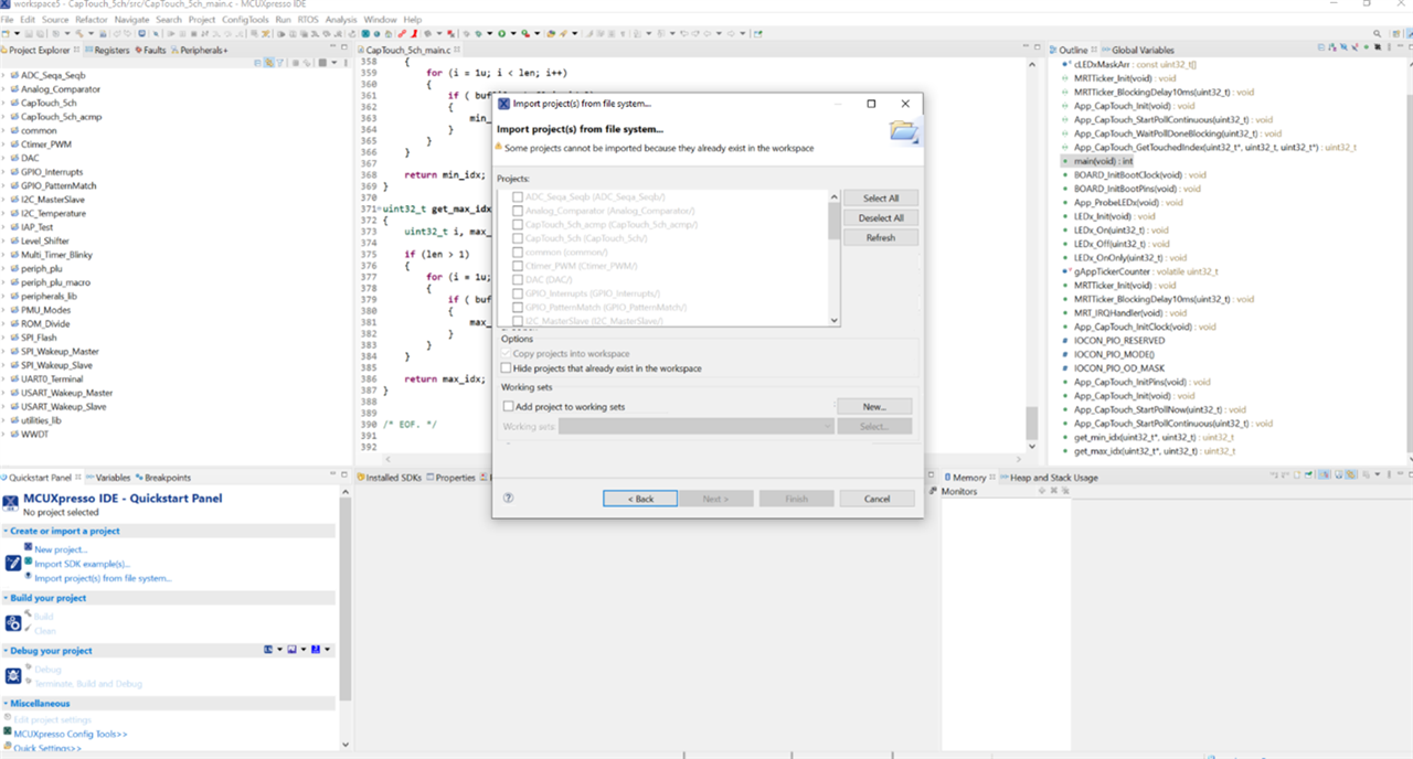

  1. Did the step above, click "NEXT" maybe you can't select the files like the image bellow, that occur because you didn't create a new "Workspace", so to resolve it you must create a new one.
Notice that, the image bellow all select boxes are selected, because that workspace is new, comparing "PROJECT EXPLORER" at the left side at two images, you can notice differences like at the first have a lot of folders this means this workspace already in use, at the second image hasn't any folder at the same side it means everything is right.
  1. So, click at the "FINISH" button and wait complete.

Error when compiling
That error occurs every time I try to debug the code "Multi_Timer_Blinky", because I wrong the folder I browse when I do the "OPEN PROJECT FROM FILE SYSTEM..." step, that occurs because the folder I browsed belong to other board.
