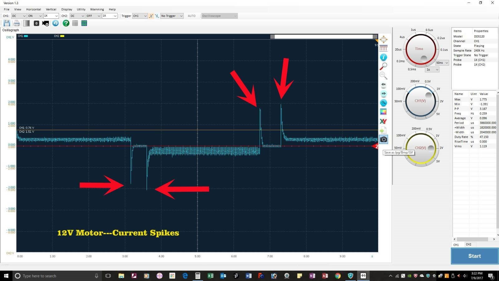

Once issues with the XMC1100 were worked out, I tried using Infineon's sample sketch to power 6 "hobby" motors at once----no go.  Unless the voltage supply was kept in a very narrow range from 5.1 to about 6.1 Volts.  Note that the 5.1 volts is below the power supply operating specifications for the DC Motor Shield 5.5 to 18V typical).  I also tried using different voltage supplies (AC/DC converter, 12V Lead acid battery, dry cells, etc.)  The shield comes with a 16 bit diagnostic system that can determine different faults with the circuit including under/over voltage power supply, over load current, thermal warning/shutdown, and even open load situations.  I kept receiving  over current and load errors, regardless of the motor or power supply.  However, after several exchanges with Manuel and Johannes from Infineon (excellent support and very knowledgeable of their product), it was finally determined that the motors were in fact triggering an over current situation.
Below is the video I prepared for Johannes and Manuel based on my testing platform.  I designed and printed a motor testing platform with my 3D printer using ABS filament to allow testing of up to 6 motors at once.
So the question that became apparent was why was I having such a difficult time with this while it appeared that other roadtesters were not.  My motors were all rated to operate at less than .9A, the operating limit for each output, the motors were within the specified voltages and other requirements, as were the voltage supplies.  I was certain the shield was bad and so tried using another one.  Again the same results.  So based on Infineon's recommendation, I set up current monitoring with my oscilloscope using various low-ohm (1 to 10) shunt resistors.  Take a look at some of the recordings:
After conducting some rather arduous DC motor research, I was finally able to determine that most DC motors used for hobby applications are usually either high-torque or high RPM type motors.  Both the high torque and RPM brushed motors have the capability of creating initial current spikes up to 20 times or more their average current rating when initiating.  Because of the inductive forces incurred, the energy needed to initiate momentum of the drive shaft, etc. some of these motors, though rated for an average operation of .1 to .5A, can produce a momentary spike of up to 10A or more!  Unfortunately, for this purpose, the diagnostics and shutdown latching times are a bit too quick.  Even though each output can support up to .9A of continuous operating current, Both High-Side (HS) and Low-Side (LS) thresholds for the over-current shutdown protection is around + or - 1.4A.  Although the shield has these higher current thresholds to trigger shutdown, it only takes the TLE94112EL chip an average of 20 uS to detect this.  If the motors are started from a stand-still position (not free-wheeling), their over current spikes tend to last a little longer than 20 uS triggering detection and latching shutdown.  Not good for many hobby applications  such as cars, boats, planes, quad copters, etc.
Solution!
Overcoming this inherent safeguard which becomes an obstacle in this circumstance however, is relatively easy.  Instead of utilizing all 12 outputs of the Infineon DC Motor Shield to drive 6 or more motors, outputs can be tied together in pairs to operate 3 motors with a doubled operating current capacity ( Outputs 1+2 and 3+4 drive Motor 1; Outputs 5+6 and 7+8 drive Motor 2; and Outputs 9+10 and 11+12 drive Motor 3).  I also discovered another work around.  In addition, high wattage, low ohm resistors (ex. 25W 1 Ohm) can also be used with any combination of motors to help dampen the initial current spikes enough to prevent detection during motor initiation by the Shield.  Depending on the motor type, power supply, load and usage, the ratings and placements of these resistors can vary to achieve success.
Also, hobbyists may want to note that this problem does not always occur when using the PWM feature of the Shield, as some of the diagnostic features are shut down when using this mode.
