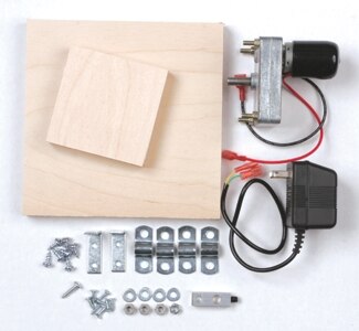

    The larger 12V motor (the one with the wooden sprocket) is marketed specifically for use in a DIY Wood Christmas Lawn Ornament from Winfield Motorized Parts Kits - Ferris Wheel Motor Kit
    That's an excellent price for those motors.

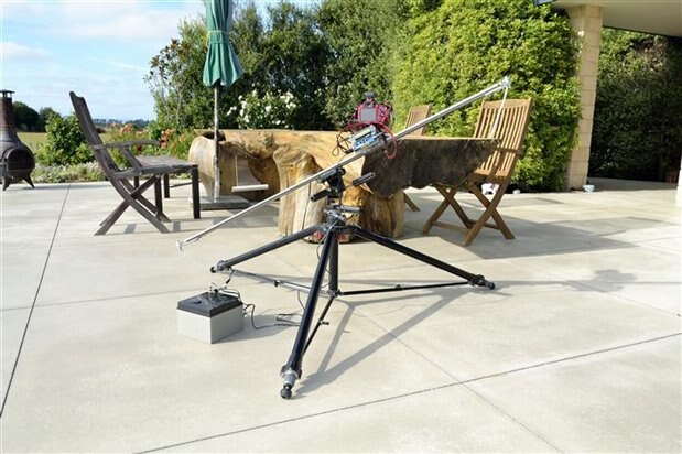

    I've used them for driving a Motorised Camera Dolly using a 8rpm motor.

    I wouldn't rule anything out Enrico.  These motors might very well be inferior, but I think the key here is that these are indicative of the types of motors that a typical "hobbyist" might use, obtained from Radio Shack, on-line sources such as Amazon, and also as surplus from Mabuchi.  The larger 12V motor (the one with the wooden sprocket) is marketed specifically for use in a DIY Wood Christmas Lawn Ornament from Winfield Motorized Parts Kits - Ferris Wheel Motor Kit
