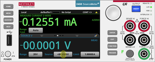

Even with the front panel there are multiple ways to accomplish the same task, what I'm going to show here is just one of them. The following images show the sequence of presses to accomplish the different tasks.
To measure the Voc I pressed QUICKSET and set the SMU as a voltmeter, which actually just sets the SMU as a 0 A source.
To measure the Isc I pressed QUICKSET again and set the SMU as an ammeter, which sets SMU as a 0 V source.

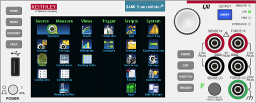

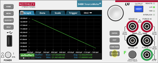

To find the Pmax, Imax, and Vmax a sweep is required. I pressed the sweep icon from the main menu and set the SMU to act as a voltage source and to measure power. I set the parameters so that the voltage sweep begins at 0 V, ends at 3 V, and uses a step of 100 mV. Then I pressed generate to generate the sweep trigger model.
After pressing generate I could immediately press TRIGGER to begin the sweep, but I went to the graph view before pressing the trigger just to see how the V-P curve gets traced. At the graph view I pressed TRIGGER and the curve got traced. Since the instrument is sinking power (positive voltage, negative current), the curve is inverted compared to the previously shown image. The most negative point of the graph is the Pmax point, or the point where the instrument sinks the maximum amount of power.
To find the values of Pmax and Vmax I got back to the main menu and then opened the "Reading Table". The table showed the 31 measured value pairs, where the most negative power value is Pmax and the voltage that generated it is Vmax.
Finally I could have just divided Pmax by Vmax to calculate Imax, but instead I set the instrument as an ammeter (0 V power supply), and then set it to source 2 V (Vmax) and measured the current, which was Imax.

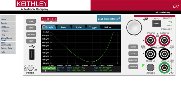

3.1.2 Web remote control
The virtual front panel could be used to perform the same exact previous operations, but since the virtual front panel is less responsive, there are better approaches to perform the same task. I opened the web page, selected "Virtual Front Panel" from the web menu, and then performed a sweep the same way as I did using the front panel. Then I selected "Extract data" from the web menu and downloaded the "defbuffer1.csv" file.

Now with the sweep data file I could manually look for, or calculate the solar cell parameters, but probably the simplest way is to just use a spreadsheet to compute the parameters.

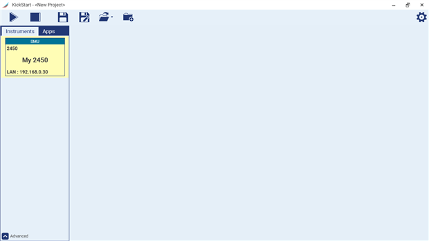

3.1.3 KickStart

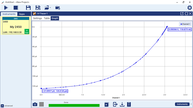

KickStart maked it really simple to measure the solar cell parameters. First I double clicked on the instrument ("My 2450"), then I chose "I-V Characterizer", and then I set the sweep parameters as seen in the screen capture. I pressed the "play" button to begin the sweep and then I was able to explore the data from either a table or graphically. In the graph tab through the use of cursors and the ability of KickStart to find the minimum value I quickly was able to find all the solar cell parameters. KickStart can save the data as CSV or an image of the plotted graphs.
3.1.4 I-V tracer app
I-V tracer is a TSP app that makes the SMU behave a bit like a curve tracer. The TSP app must be installed to the instrument through KickStart, after that it stays in the instrument and can be used even in a stand-alone way.
To initiate the app, I selected "Apps" from the main menu, then "I-V Tracer" and then pressed "Run". At the main I-V tracer screen I pressed "Settings" to set the tracing parameters
I set the tracer to operate as a voltage source, set the maximum voltage to 3.5 V, the current limit to 10 mA, the sensing to 2-wire and the polarity to positive. Then I got back to the tracing screen and pressed the OUTPUT button to begin the tracing. The instrument plots a violet point at the current I-V position which can be changed through the rotation of the navigation wheel. The navigation wheel controls the voltage which can be read directly at the bottom right of the screen along with the current. The Isc and Voc values were simple to measure, but it took a bit of effort to get the tracer to the 0 A position because of the navigation wheel acceleration. Unless I missed it, it does not seem to be possible to plot power, which would mean that its not possible to easily find Pmax from within the app.
I-V tracer modifies the instrument's menu, but still gives access to the reading table and reading buffer management. The latter can be used to save the buffer data to a USB drive.
A simpler way to transfer the data to the computer is with KickStart. To do that, I selected the SMU from Kickstart's instrument list and then the "I-V tracer" operation mode. To download the data I pressed the camera icon at the bottom, and program automatically downloaded the used I-V tracer settings and the measured I-V points. The downloaded data can then be explored from either the table or the graph view or saved to a file just like when using KickStart in the "I-V Characterizer" operation mode.
