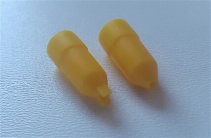

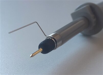

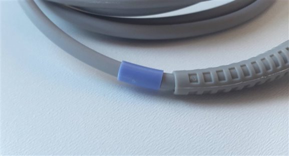

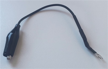

Along the scope the other important thing to consider are the probes. The MSOX3034TMSOX3034T comes with four N2843A probes.
The bandwidth of the probes is 500 MHz, which means it can handle signals of up to 500 MHz without attenuating them with more than 3dB.
The attenuation ratio of the probes is 10:1, while the input impedance is 10 MOhm.
The probes come with Probe ID technology, so the scope can automatically detect their model and set attenuation ratio accordingly.
In terms of accessories we get the followings:
  • Retractable Hook
  • Ground Leads
  • Spare Tips
  • Insulating Caps
  • Ground Springs
  • BNC Adapter
  • Colored Channel Identification Tags
As the accessories came in some pretty flimsy nylon bags, so I decided to store them in a little plastic box instead:

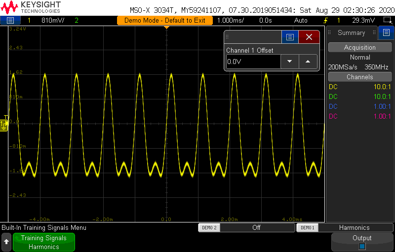

As I not that experienced with oscilloscopes, I decided to start experimenting with the in-built Training Signals and Demos of the scope.
3.1. Training Signals
The scope comes with the following Training Signals.
Sine wave
  • 5 MHz sine wave @ ~2.5 Vpp
  • can be used to explore the basic functionality of the scope
Sine wave with noise
  • 1 kHz sine wave @ ~2.4 Vpp, with random noise of ~0.5Vpp
  • can be used to experiment with the Noise Reject, HF Reject, Trigger Holdoff and Waveform Averaging
Two Phase Shifted Sine waves
  • two 1 kHz sine waves @ 2.4 Vpp with a configurable phase shift between them
  • can be used to show off features like delta-time, phase shift measurements, and XY time mode
Sine wave with glitch
  • 30 Hz sine wave @ ~2.7 Vpp with a narrow glitch near each positive peak
  • can be used to experiment with the Peak Detect acquisition mode
Amplitude Modulated Sine Wave
  • 26 kHz sine wave @ ~ 5 Vpp on Demo 1, amplitude modulated signal, ~2 Vpp, 13 MHz carrier on Demo 2
  • can be used to play with features like deep memory, high res display, and trigger on AM
Frequency Modulated (FM) Burst
  • Frequency Modulated (FM) Burst from ~100 kHz to ~1 MHz, ~5.0 Vpp, ~600 mV offset
  • can be used to show Nth Edge Burst triggering and Measurement Trend Visualization
Sine wave with harmonics
  • 1 kHz sine wave @ ~3.5 Vpp with 2 kHz sine wave coupled in
  • can be used to demonstrate the FFT capabilities of the scope, and as well as zoom features
Noise coupling
  • 1 kHz square wave @ ~1 Vpp, with a ~90 kHz sine wave ~180 mVpp riding on top
  • can be used to demonstrate the FFT capabilities of the scope to find signal coupling
Single shot
  • ~500ns wide pulse with ringing @ ~3 Vpp, 1.5 V offset
  • can be used to show single-shot acquisition using either Normal triggering or Single acquisition mode
Clock with glitch
  • 3.6 MHz clock @ ~2 Vpp, 1 V offset, with infrequent glitch (each 1,000,000th clock)
  • can be used to demonstrate fast waveform update rate, pulse width triggering and mask testing
Runt
  • digital pulse train with positive and negative runt pulses @ ~2.9 Vpp, 1.5 V offset
  • can be used to show the benefits of runt triggering, and other features
Setup and Hold
  • Demo 1 - 6.25 MHz digital clock @ ~ 3.5 Vpp, 1.75 V offset
  • Demo 2 - Data signal @ ~ 3.5 Vpp, 1.75 V offset
  • can be used to show of Setup & Hold triggerring
Along the above there a bunch of other training signal, including analog and digital ones. There is even one imitating the KeySight logo:

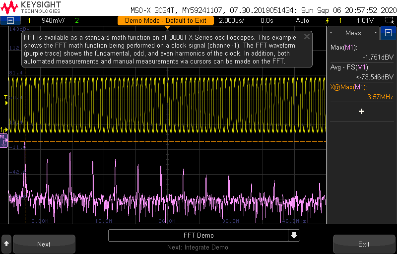

3.2. Demos
The instrument also comes with a series of Demos:
  • Debugging Demos
    • Debugging Glitch - Finding the coupling signal that causes a glitch
    • Isolating Serial Error - Isolating a serial bus error packet/frame
    • Stress Testing - Stress testing FlexRay serial bus using the integrated WaveGen
    • Identifying Noise - Identifying a noise source
    • Mixed Signal - Debug a mixed signal design using the digital channels
    • Gated FFT - Validating the frequency hop of an FSK signal using Gated FFT
  • Application Demos
    • Serial Buses
    • Advanced Triggering
    • Advanced Math
    • Power Measurements
    • Advanced Features
  • Auto Demo
    • Update Rate
    • Zone Trigger
    • MSO
    • Serial Buses
    • Segmented Memory
The Demos were mostly automatic, demonstrating different features of the instrument. The scope does almost all the actions, you just need to press Next time to time.
I would have preferred something more little more interactive. Something like the Training signal section, but with instructions.
Here are some screenshots:
(unfortunately not all the demos allow taking screen captures)
