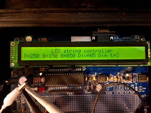

I wrote code to control intensity of the RGB LEDs and code that allows exploration of a power reduction scheme.  The power reduction scheme is based on programming the LEDs to operate at two intensity levels at a fast enough rate that human eyes don't detect significant flicker. I settled on a 10 ms period composed of a low intensity duration followed by a full intensity duration.  When I test this scheme on the bench I barely notice any flicker.  The low intensity duration is adjustable from 1 ms to 9 ms.  The low intensity RGB values can be adjusted from 1/2 to 1/10 of the full intensity values in integer steps (1/2, 1/3, 1/4, etc). Because I was building upon known working code modules, the application came together quickly.
For the signal explorations using the Keysight MSOX3034TMSOX3034T and the Tektronix MDO4104-3 the LED power save parameters were configured as shown in the image below:
These settings will cycle all 9 WS2812 devices every 10 ms with a dim illumination for 3 ms followed by a bright illumination for 7 ms.  Maximum value for any LED is 255.  The values for the bright illumination portion of every cycle are Red = 250 , Green = 150, and Blue = 50.  To my eyes, this combination produces a warm (not too blue) white light.  The dim illumination values will be obtained by dividing the bright illumination values by 5.  In this case the dim illumination values will be 50 for Red (250 / 5), 30 for Green (150/5), and 10 for Blue (50/5).
