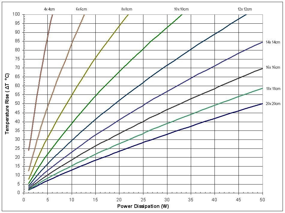

Here is a flat plate heat sink chart I found on the internet - I am not sure how good it is yet:

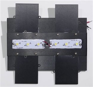

It indicates I need 100 sq cm, however in my test this still got too warm, so I need to increase the heatsink area.
I increased the heatsink area from 101 square cm to 250 sq cm and it eliminated overheating. The temperature now stays below 46 C. The aluminum I am using is too thin to work optimally - the edges are 10 degrees cooler than the middle. If the material was thicker it would conduct more heat to the edges and they would play a larger role in dissipating the heat. Here is a picture of the beefed up heatsink:

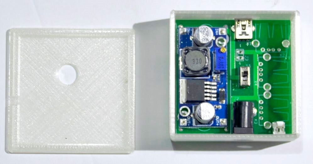

The ring of LEDs is a commercial "angel eyes" circuit card normally used for headlights, so it runs off 12-15 volts. It has 33 LEDs. The ring I used has an inner diameter of 83.8 mm and an outer diameter of 100 mm. It is powered from a custom module I designed that converts 5 V to 12-15 V, so I can use a standard USB power supply to run it. The 3D printed ring diffuser and quick-connect tripod mount allow access to my camera battery and memory card.

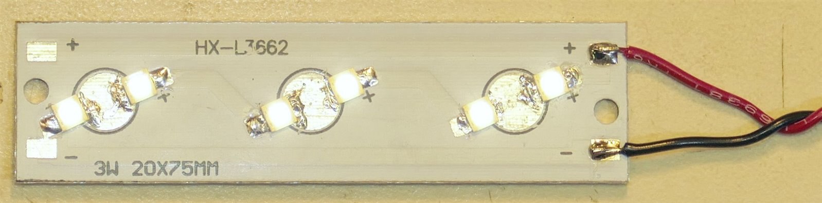

What you can do with the Würth LEDs is connect them on aluminum circuit cards intended for other form factor LEDs.

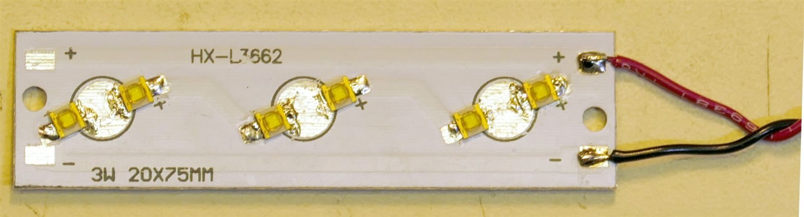

Here is what that looks like - I have soldered twice as many LEDs as the card was intended to carry, one on each lead - using the central heatsink pad to connect each pair. I was worried that all central pads were common, which would prevent this from working, but it turns out they are all isolated from each other. You will need a fairly high power soldering iron as the aluminum card is hard to heat up. It is also tricky to get some heatsink compound under each LED and get them to lie flat for good contact. But it is possible as shown here:
Here is what they look like turned on - again at low current to allow the camera to capture a reasonable picture:

    The control module I built uses an adjustable DC-DC converter to translate 5 V to a higher voltage, in this case 12 to 15 volts. It takes under 10 Watts so I can run it from a 2A USB power supply. The…
    dougw over 11 years ago in reply to gpolder
    I will update the blog above to add some further description. I am looking forward to seeing your project.

    dougw over 11 years ago in reply to DAB
    The control module I built uses an adjustable DC-DC converter to translate 5 V to a higher voltage, in this case 12 to 15 volts. It takes under 10 Watts so I can run it from a 2A USB power supply. The control is a pot.
