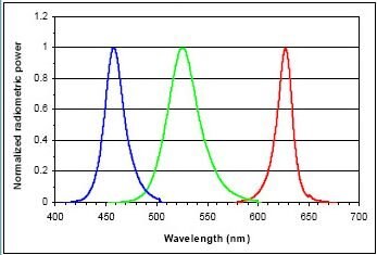

LEDs are available in many colours but they all emit a range of colours around their nominal colour as illustrated in this spectral plot:
If you combine red green and blue LEDs the light appears white, but if that light shines on a surface that only reflects yellow, the surface will appear dark because there is actually no yellow light in the the white light obtained from RGB LEDs.

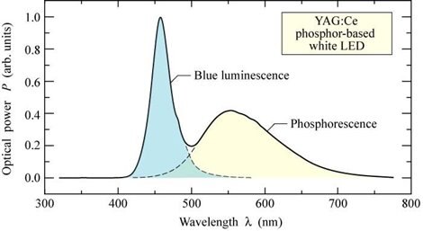

Even white LEDs (which all use a white phosphor driven by a blue LED) don't emit a uniform range of colours as shown in this spectral plot:
