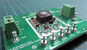

TPS92512: TPS92512EVM-001TPS92512EVM-001 [TPS92512 Buck Regulator with Analog and PWM Dimming - TPS92512EVM-001 - TI Tool Folder]
TPS92512 is a 2.5A buck regulator for driving LED stack.
Input range:     42v and 60v version. The on-board chip says 512H, so I think I've got the high voltage version.
However, the board says a little bit different ratings.imageimage
Vin: 12v to 48v
Vout: 5v to 25v
Iout: 1.5A max
and there are caution marks for ESD and HOT surface image

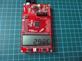

MSP-EXP430FR4133MSP-EXP430FR4133: MSP430 MCU development kit [MSP430FR4133 LaunchPad Development Kit - MSP-EXP430FR4133 - TI Tool Folder]
MSP430FR4133 - 16 bit RISC 16 MHz MCU
Segmented LCD
couple of button switches and LEDs
on-chip temperature sensor
16bit timer
IDE: CCS
Front view                                                                     Back view                                                                                     welcome display at power up
Pre-loaded firmware supports 'stopwatch' mode and 'temperature' mode which can be selected by pressing sw1 and sw2.
LEDs turn on while pressing sw1 and sw2 to change mode                         Stopwatch                                             Temperature

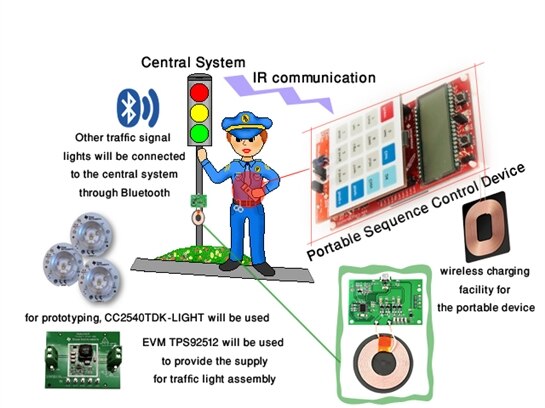

Project Description:
The on duty traffic police officer will possess a portable device which will send the sequence of switching along with time duration to a central traffic light post [through IR/BLE]. The central light post [central system] will be connected to other light post of the road junction through bluetooth. The sequence can be changed manually based on the current traffic load. On the other hand an automatic sequence can be programmed too when the traffic load is low. The change of sequence will be logged and saved into a micro SD card for further record and future load study to workout an automatic system algorithm.
Use of the Roadtest kits:
  • TPS92512 LED driver - will be used to power up the Ultra Bright LEDs of the traffic signal light assembly
  • CC2540TDK-LIGHTCC2540TDK-LIGHT kit - will be used to demonstrate the bluetooth communication between the traffic signal lights [for prototyping purpose].
  • MSP-EXP430FR4133MSP-EXP430FR4133 -
                    1.     Controlling the portable device for programmable switching sequence
                    2.     Communication with the Central System trough InfraRed or Bluetooth Low Energy
                    3.     On board LCD to guide the traffic police officer
                    4.     16-bit timer to track down the time delay
                    5.     Communication with a MicroSD card to log the change of switching sequence with time for future study of an automated control system
Extra Features:
                    1.     The portable device will consist a wireless charging system, which will take power from the Central System [central light post].
                    2.     In case of an communication error or any other technical problem, the lights will be set to RED [STOP] sign.
                    3.     Encoded data communication to avoid unwanted intrusion in the control system.
