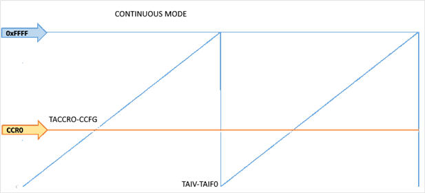

Continuous Mode
The timer starts at zero, and counts (once per clock cycle) all the way up to 65,535 (or 0xFFFF). If CCR0 (the “alarm”) is set, the timer triggers an interrupt but keeps on counting up. When it reaches OxFFFF it overflows and returns to zero, just to start counting up again.
Interrupt Flags:
  • If CCR0 is set, then an interrupt is generated and the TACCR0-CCIFG flag is set when the timer reaches CCR0. However the timer will continue to count past CCR0 up to 0xFFFF.
  • When the timer overflows, it generates an interrupt and sets the TAIV-TAIFG interrupt flag.

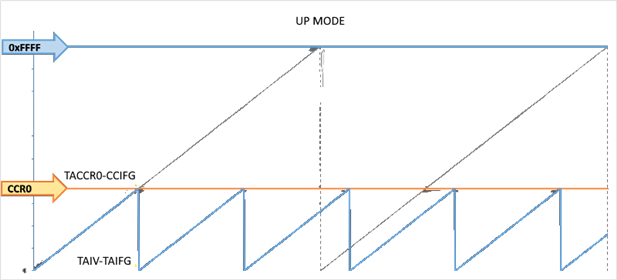

Up Mode
The timer starts at zero and counts up to the value that you specify in CCR0. On the next count it restarts again from zero.
Interrupt Flags:
  • When the timer counts to CCR0, it generates an interrupt and sets the TACCR0-CCIFG flag.
  • When the timer resets to zero, it generates an interrupt and sets the TAIV-TAIFG flag

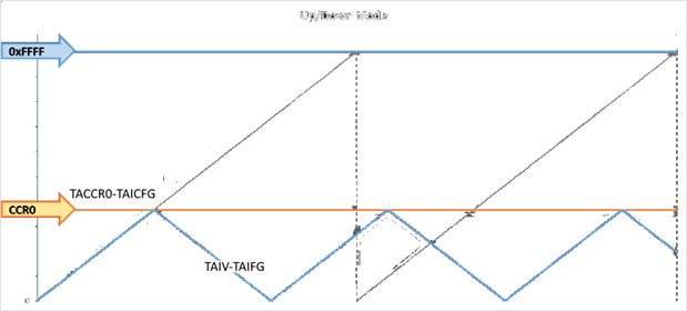

Up/Down Mode
The timer starts at zero and counts up to the value that you specify in CCR0. It then counts back down to zero, and starts the cycle again.
Interrupt Flags:
  • When the timer counts back to zero, it generates an interrupt and sets the TAIV-TAIFG flag
From this you can see that the period between interrupts is double that in Up Mode – as the timer counts all the way back down to zero, rather than resetting at zero.
