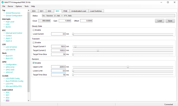

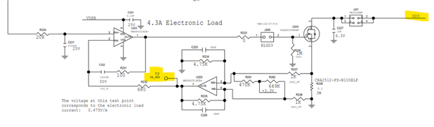

The EVK includes a number of programable current sources and switched resistive loads on board.
Net names:
SD3 - BUCK3 Output.
VIL_SD3 - Output of the current shunt amplifier for Buck3's programable current sink.
BUCK 3 - Configuration
Buck 3 is left in its default configuration for a 900 mV output.
(BUCK3) SD3 - 0 A to 1 A
(BUCK3) SD3 - 100 mA to 1 A
(BUCK3) SD3 - Random 0 mA to 2.2 A
