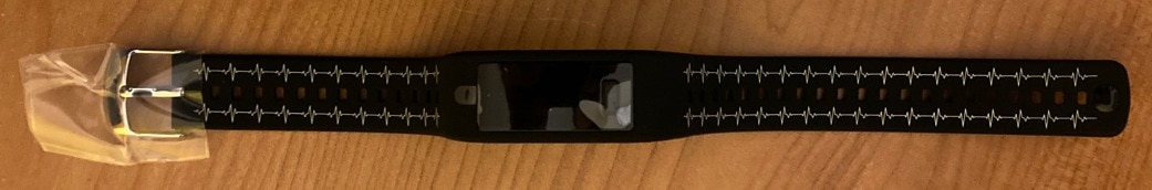

Hello everyone. In this blog post I will show Maxim’s fitness watch which I won for asking best question in Maxim’s How to Design Low-Power Sensor Solutions and Interfaces webinar. I originally plan to write short blog about it but at the end I realised that it has 23 pages in Word, so I decided to assign this blog post in RoadTest section because it is more like review rather than simple thank you blog.
Unboxing
Fitness watch was packed in white box which at first look looks like box which maxim use for any other evaluation kits Slight smile. In comparison with other evaluation kits this box has sticker describing content.
After opening box, first thing which you see is welcome letter. Because I already have worked with some maxim evaluation kit this letter is nothing new to me and I already have some these letters in my cabinet:
After removing first layer of antistatic foam, you will see inner white box which contains USB cable and fitness watch.
Now let’s look to the main part, fitness watch:
From the bottom we can see some sensors, LEDs and labels including FCC ID which I will use later:

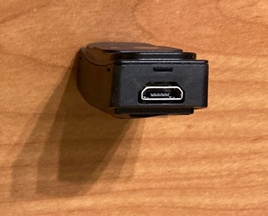

Very soon I found that main core of fitness watch is detachable from rubber bracelet.
USB connector is at the side which is covered by rubber bracelet:
Maybe watches satisfy some level of basic IP protection but I never read anywhere about it.
Then I tried power up the watches, but nothing happened. I guessed than maybe battery is discharged so I tried to connect watch to power supply and yes it worked. Maxim logo and hBAND appeared:
After some time, I disconnected watches from charger and started using them. They show heart rate, burned calories and steps. When synced they can also show clock. Device can work in two modes – sampled mode and continuous mode. In continuous mode it consumes more energy but sample data more frequently.

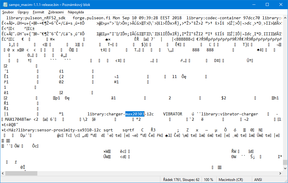

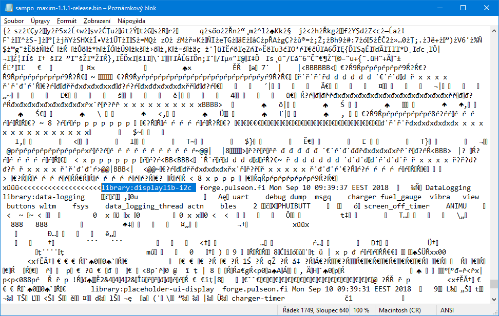

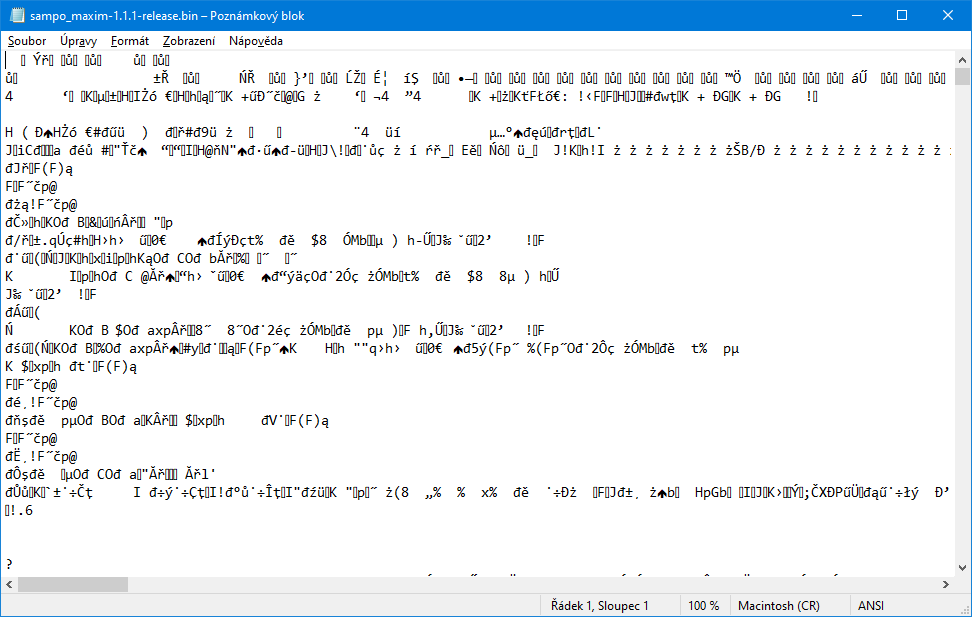

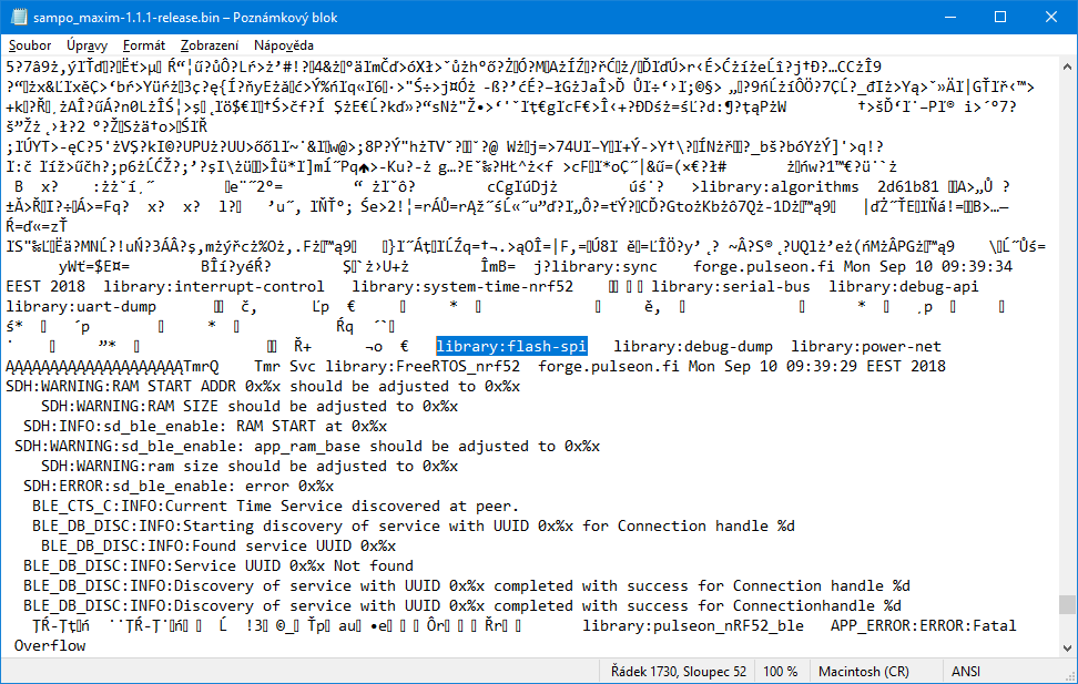

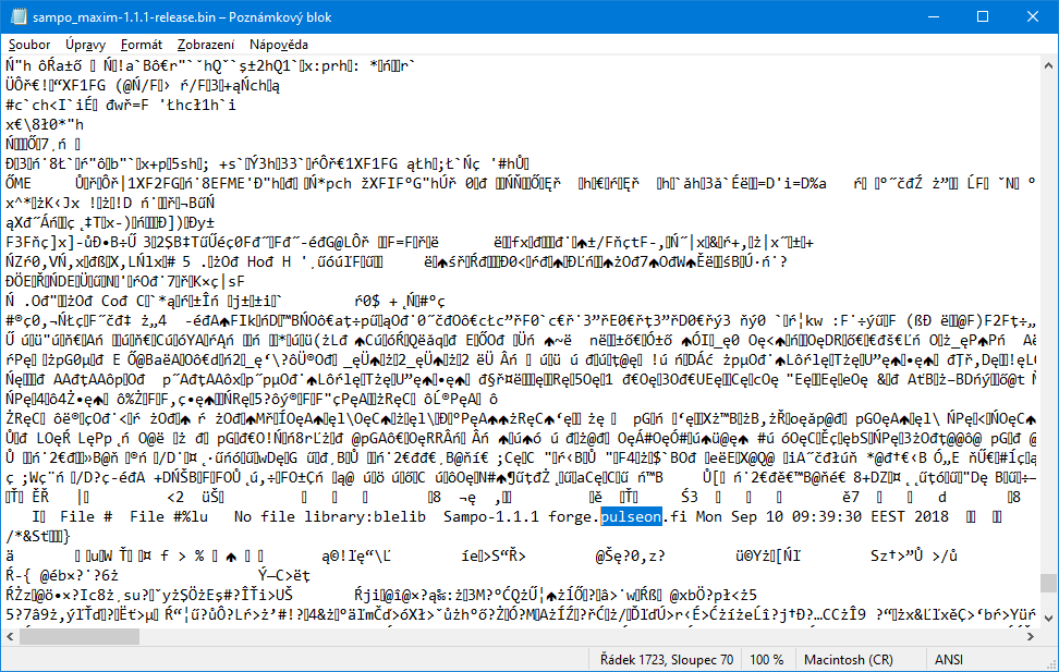

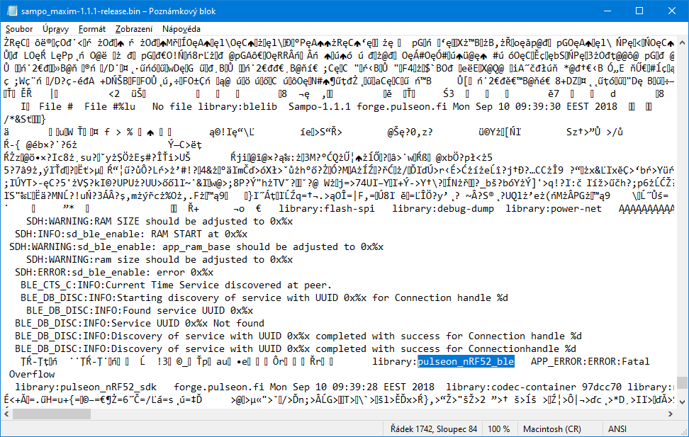

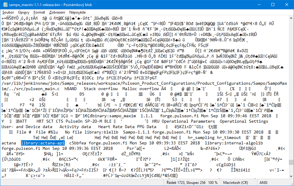

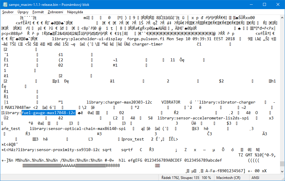

Bluetooth Low Energy Interface
Watches communicates with mobile phone using Bluetooth Low Energy. Since I did some BLE applications I know how GATT interface looks like and for this reason I tried to see what the device offers. First of all, I tried Raspberry Pi CLI tool bluetoothctl for connecting to device and enumerating its features. At beginning I enabled scan mode:
As you can see, I successfully find the device under hBAND name very soon. I connected to device and device very soon announced all services which it supports.
If you are interested, here is full output from bluetoothctl command:

Surprisingly device manufacturer string is not Maxim Integrated but PulseOn and Module Number String is not hBAND or MAX-HEALTHBAND, but it is SP-2D-M. Note that the same model name is also printed from bottom of fitness watch.
Who did develop Maxim hBAND?
More interesting to me is Manufacturer Name. PulseOn is company which makes not only fitness watches, but they specialize in professional monitoring devices used by doctors most probably for monitoring patients. After some investigations I think that PulseOn developed whole watch without any intervention from Maxim but because they used some chips from Maxim, Maxim licensed their design and sells it under their own brand as an “evaluation kit” for their chips. Later I will show some other indices about this theory. I think evaluation kit here is not a correct word because it is hard to evaluate Maxim’s chip in this sealed compact device. It is not standard EVKIT which we know from Maxim. Rather is complete product for end-users and it has required certifications (CE, FCC, …). Alternative point of view is that Maxim offers this device to the public (you can buy it for example at Farnell) while PulseOn do not offer their products (at least SP-2D-M) to the public.

For checking what chips are inside device I used my favourite binary editor: Windows notepad. Note that there are better choices like Linux strings utility, but Notepad also works well.
As you can see binary data does not make sense very much at the first look. But firmwares sometimes (frequently) contains interesting strings which we can use for identifying details about firmware and related device. After scrolling you for example can see references to pulseon:
Next, you can see very interesting reference to something referred as actana-api:
After googling I found very interesting to company Aktana (note C vs K) which develop AI algorithms with reference to life. Most probably they develop some algorithm used in this watches.
Next you can find reference to Flash SPI which is most probably memory used for storing database and log-term logs:
Later you can see additional interesting references to Nordic Semiconductor nRF52:
Even more you can see some strings used in debugging messages. If you google for some of them. They will indicate that PulseOn most probably used Nordic MCU with BLE connectivity:
After next scrolling I very soon find references to MAX20303 PMIC (note that this is nothing new. Maxim mention that hBAND evaluates this chip).
Later you can find reference to I2C display driver:
One line later we can find reference to MAX17048 fuel gauge. This is interesting because Maxim do not say that this chip is used in hBAND. Maybe it is or maybe it is artefact of later unused code in firmware. Who cares? Let’s go next.
Next reference disclose what sensor is used for detecting steps. It is Accelerometer LIS2DS from ST:
Next reference indicates what I already known. Optical sensor is MAX86140 sensor from Maxim. Maxim mention that hBAND is used for evaluating this sensor. Firmware of course contains references to it:
Next line contains reference to SX9310 proximity sensor.
This chip is not form Maxim, so Maxim do not mention it but most probably this sensor is here. But it is vey interesting sensor! It look that it is proximity sensor which is here used for presence of hand. It is invisible and does not detect hand directly. It is completely hidden after plastic cover and works in a interesting way for detecting human while not interfering with non-life parts. Datasheet also mentions some ideas for what is this sensor used for.
And this is all. No next interesting reference is here.
To summarize based on firmware opened in Notepad we most probably know most of the onboard chips. To summarize they are:
  • nRF52 MCU
  • Some SPI Flash
  • MAX86140 Optical sensor
  • MAX20303 PMIC
  • MAX17048 Fuel Gauge
  • SX9310 proximity sensor
  • LIS2DS accelerometer
