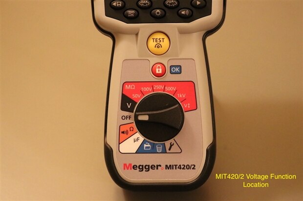

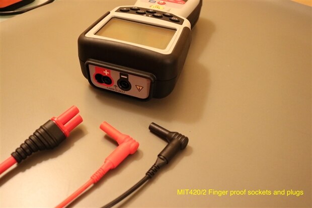

As standard with most electrical instruments these days the terminals on the  MIT420/2MIT420/2 are 4mm safety socket designs with compatible plugs on the leads to prevent any inadvertent contact with the output of the instrument I also like the location of the voltage function in between the off position and the insulation test functions Merger make it absolutely clear that it does not constitute as an appropriate testing for dead procedure and I fully agree with that But for me it adds an extra safety feature as pausing on the voltage function allows for a last double check to ensure that no live voltages are present before moving to an insulation testing function or that the circuit has been discharged when switching back having completed the insulation testing
