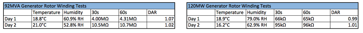

For the 145MVA unit the rotor winding is designed to work at a maximum of 360V DC under short circuit conditions of the stator output. The  MIT420/2MIT420/2 has nominal test voltages of 250V and 500V. If I use 250V then I am not testing the rotor under its worst operating conditions. If I use the 500V range then potentially I am stressing an old winding beyond any voltage level it is likely to see in service. The 92MVA unit has a maximum rotor voltage of 143V. The  MIT420/2MIT420/2 offers nominal ranges of 100V and 250V around this value, with a similar scenario to the larger rotor.
The answer is to use the variable voltage function of the  MIT420/2MIT420/2 to set the output voltage to match the maximum in service conditions the rotor will see. This is the safest way I can test an old rotor winding, testing it to its full service voltage without over stressing it and risking damage. The variable voltage function defaults to 10V and is easily set to the required value using the settings function this also prevents inadvertent adjustment of the test voltage during use. Once set the range functions exactly like all the other insulation ranges with timed DAR and PI test setups and the ability to save any results obtained.
Throughout the tests on both rotor windings the  MIT420/2MIT420/2 performed without any issues, connections were easily made and the tests conducted. Unfortunately neither rotor was in too good a condition. The 92MVA rotor was tested on day 1 and had a low insulation value with no DAR. Overnight the heaters were turned on and the unit retested again in the morning. A doubling of the insulation resistance was seen but no DAR was obtained. The 145MVA generator was much worse and the insulation tester output voltage could not be maintained on the first test. No heating was available for this unit, so only a marginal improvement was seen the next day probably due to the lower ambient humidity. I hope to return to this rotor in the next two to three weeks after the heaters have been put back into service.
