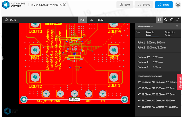

Reference Design and Layout
MPS provide Altium design files for the EVM which can be used as a sample schematic and layout. If you don't have an Altium license you can drag and drop the project files into the free online Altium viewer.
I wanted to know the drill hole spacing to mount a piece of perfboard to the EVM. We can simply take a distance measurement in the PCB viewer:
The EVM holes are 57.15mm center to center, too easy!
