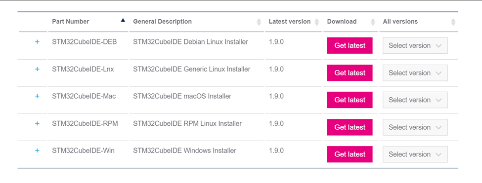

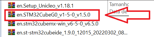

1. Download the software
The first software is:
  • STM32CubeIDE-Win - https://www.st.com/en/development-tools/stm32cubeide.html
- Going down the page you will find some options and you can choose the version compatible with your device.
After installing it will download an enZip folder, click to extract it and save it to a location. After extracting, run and install the program. After installing the program, install the following software:
  • STM32CubeG0 - https://www.st.com/en/embedded-software/stm32cubeg0.html#get-software
- Extract the folder in the same location as the previous item.

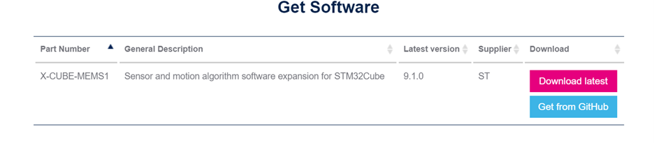

Right after we install this other software, you need to download the next files:
  • X-CUBE-AZRTOS-G0 - https://www.st.com/content/st_com/en/products/embedded-software/mcu-mpu-embedded-software/stm32-embedded-software/stm32cube-expansion-packages/x-cube-azrtos-g0.html
  • X-CUBE-MEMS1 - https://www.st.com/en/embedded-software/x-cube-mems1.html#overview

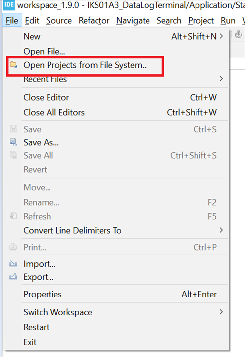

  • After installation, open the IDE and click "File", "Open File System Projects..." as shown in the image below.

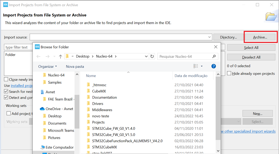

  • A window will open and you must click on "Archive..." there you select
  • Then look for the STM32CubeG0
After loading the folder load the project. To test go to "projects", "Nucle-G071RB", "examples", "GPIO". Now your LED will be blinking!!

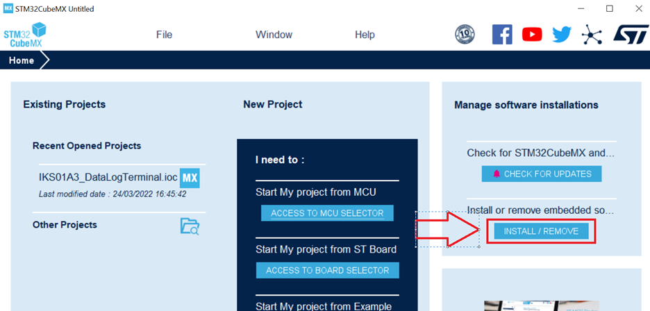

Let's install the MX program ( https://www.st.com/en/development-tools/stm32cubemx.html ) after installing it go to install/remove
We click on STMicroelectronics and look for the X-Cube-MEMS1 application and click on "Update", after loading select the square indicated in the figure below and click install
After installation click close and type "access to board selector"
Let's look for our board to configure it
configuring the board

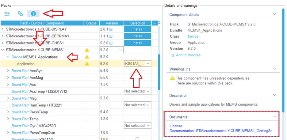

Then go to "Software Packages" --> "Select Components" We look for X-Cube-MEMS1 and dec until we find "MEMS1 device applications", install and enable "IKS01A3 DataLogTerminal". Go to the "I" at the top of the table to open the port configuration pdf.
In the pdf we will go to page 41 and start configuring our ports! Be careful to check if it is the configuration of your card, in our case we use the IKS01A3

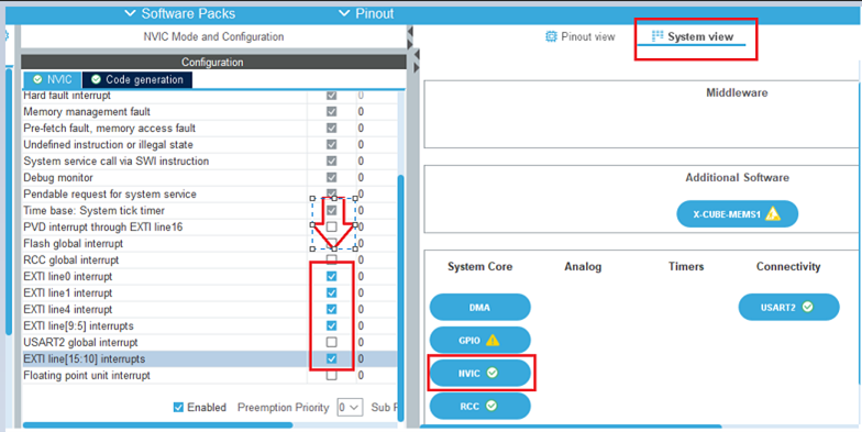

After the settings go to "System View", "INVIC" and enable the following options
Then go to "Project Manager" and create a project. Fill in the data, change the "Application Structure" to "Basic", the "Toolchain/IDE" to "STM32CubeIDE" and disable the "Generate Under Root" option. Once that's done, just click on "Generate Code", "Open Project" which will open your IDE with your project, so just put it to run!
