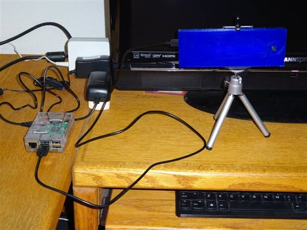

Here's my setup - just power and the HVC-P2 connected to the RPi3.

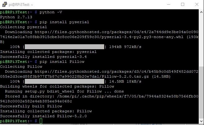

First step was to verify I'm using Python 2.7.  Then install the pyserial library for communication and the Pillow library for image processing.

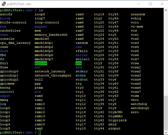

Then to verify that the HVC-P2 was recognized by the OS.  It shows up as ttyACM0 in /dev.

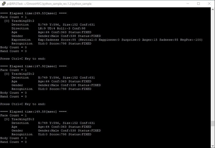

Then copy the python code and execute:
    Usage: execution.py <com_port> <baudrate> [use_stb=ON]
        com_port:  COM port
        baudrate: baudrate
        use_stb:   Using flag for STB Library (optional)
    python execution.py /dev/ttyACM0 921600 ON
So moving to the RPi was painless.  The STB library was written and tested with Raspbian Jessie, but it doesn't appear to have any issues with Stretch (using Release 9.4).
