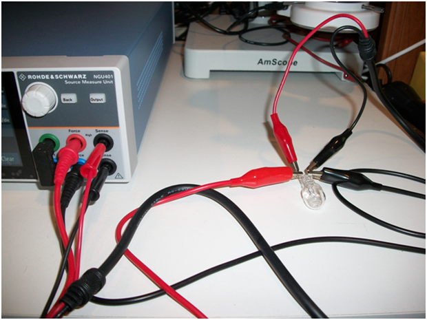

I have started with four simple measurements that have setup the R&S NGU401 SMU to operate into each of the four quadrants explained in the first section above.  Here are the details:
Quadrant 1
For operation in quadrant 1 I have setup the NGU401 to force a positive voltage, 1V, and I connected an external 2 Ohms resistor between the force high and force low connectors.  In this experiment intentionally I did not use the sense lines.  The displayed current was 0.388A while the calculated value was 1V/2Ohms = 0.5A.  The difference comes from the wires resistance, which we can roughly calculate here as 1V/0.388A – 2 Ohms = 0.57 Ohms for both wires, so 0.28 Ohms per each wire.
Quadrant 2
For operation in Quadrant 2 I have setup the NGU401 in current source mode (force 0V and clamping the current at +/-200mA) and I connected the force high and force low connectors to an external power supply programmed to 1V. The NGU401 goes into current limit mode and functions as a current source sinking 200mA from the external power supply.
Quadrant 3
The operation in Quadrant 3 is setup similarly to the operation in Quadrant 1 with the only difference that the programmed voltage has a negative value. Therefore, the current will also have a negative value, which makes the NGU401 operate in Quadrant 3.
Quadrant 4
The operation in Quadrant 4 is similar to the operation in Quadrant 2 with the difference that the external power supply is connected with opposite polarity, thus, making the NGU401 sourcing current through the force high terminal while the voltage between the force high and force low terminals has a negative value, which makes the NGU401 operate in Quadrant 4.

Next I wanted to measure the I-V curve of a Halogen type incandescent bulb (also of nominal voltage of 12V). So I have setup a similar experiment but this time using a Halogen bulb:
I have kept the same settings for the sweep in the NGx Sweep Tool control panel.  The measured I-V curve is shown on the right side of the screenshot below:
Here we can see that the I-V curve is also non-linear, which we have expected, but interestingly it has also a non-monotonic region.  That non monotonic region seems to be related to the moment the bulb starts to light up.
