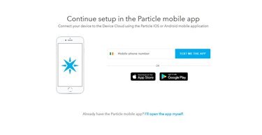

Aha, we are now provided with a check list and a big blue button saying, “NEXT”. As everything was ready, we could now click on "NEXT".
Oh! I was slightly taken aback here... We've been taken all this way just to be told that we now needed an app. This reminded me of hopping on a train only to be told a few stops later that we now had to change over to a bus... and we all know how that feels...
Oh well, a possible dead end on the website then. It just so happens that I did not have the app, but as my phone was pretty full, with my element14 videos and photo's, I decided that using the install-on-device-from-website option was for me. So, the only alternative offered on the website was either the logout option under my user name or this “I'll open the app myself” link.
Let's see what happens if we click on that link...
“Excellent! I cried”. “Elementary...” say you... here on the screen we are provided with a “See you back here in a bit!” message and beneath this message is a greyed out button (i.e. it's disabled - waiting for something) and tucked away below this button is some small grey italic text that says “Waiting for you to set up at least 1 device before continuing”.
Hmmm, I wonder how many people miss that one.
So, maybe we don't need to logout after all and thus we'll keep it open just to see if something does happen once we have the app loaded and the Argon device connected.
