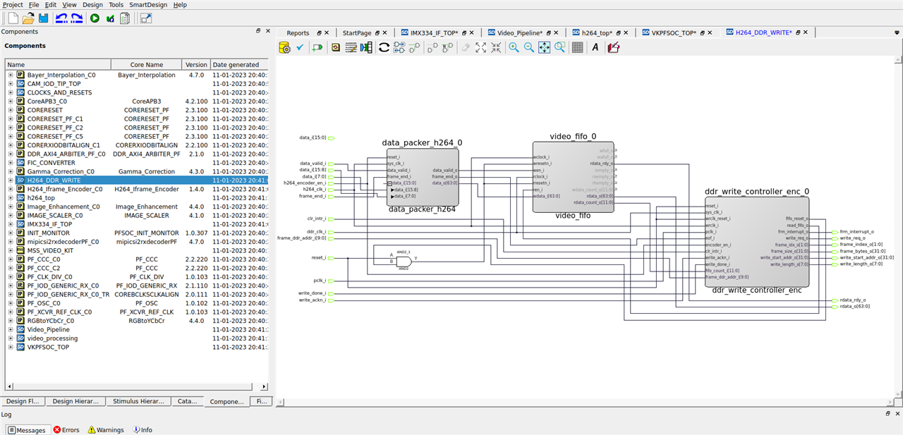

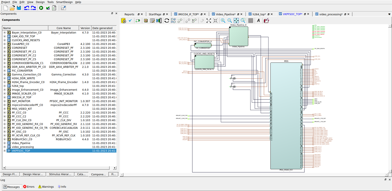

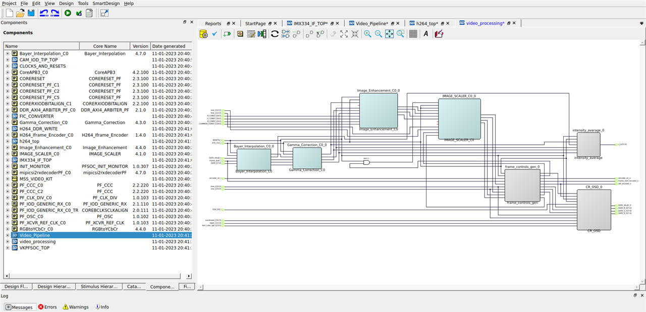

The reference design make use of only 1 camera (specifically the right camera) of the dual camera addon. The video pipeline is composed of the IMX334 MIPI camera block. The video stream then goes through a pre-processing block that contains bayer interpolation, gamma correction as well as image frame scaler and on-screen display IP blocks. The design makes use of a DDR frame writer.
One noticeable issue is that the graphic blocks are harder to follow compared to IDEs like Vivado or Quartus since the signal are not grouped. This makes the graphic design pretty tough to trace. Another observation is the single threaded nature of Libero 2023.1 (and 2023.2).
{gallery}FPGA design
Compiling this will take at least 1 hr depending on the single threaded performance.
Once the FPGA fabric is programmed , a browser was used to launch the embedded webserver that contains the H264 video decoder settings. VLC was used to test the RTSP video feed.
{gallery}H264
