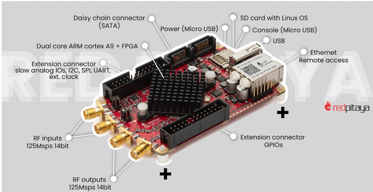

I've discovered that the documentation is significantly behind the product supplied for this RoadTest. I would have liked to provide the resource I discovered that my fellow RoadTester could use and not have to visit the dead end rabbit warrens that I have traveled.
It appears this is the unit used for the documentation. Notice next to the RJ45 connector the narrow silver case of a USB-A socket.

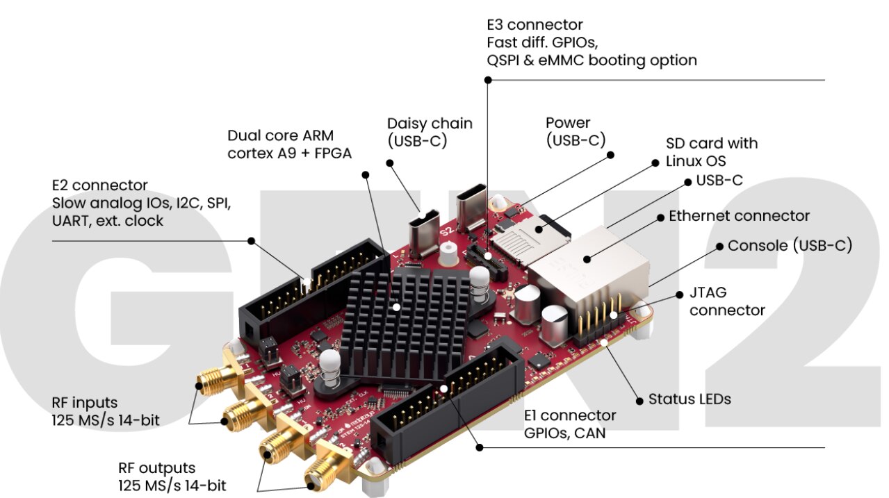

We are provided this unit. Note the USB is not present.

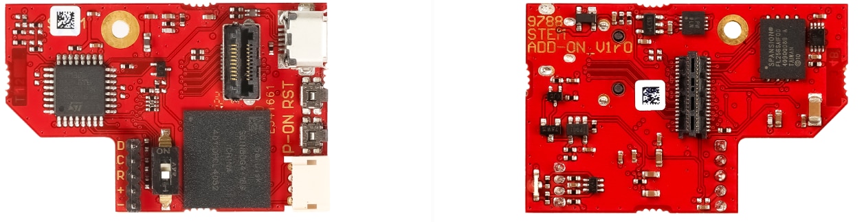

In addition, the kit comes with a QSPI eMCC module. It mates with the E3 connector on the board. This module promises to eliminate the need for the SD card, if it only worked!
I've discovered the firmware for this module has changed (as promised in documentation). I have been unsuccessful in trying to load the OS to this module in the current firmware version because of the watchdog timer. It reboots the OS when it fails to get a proper response. It has to be disabled to load the OS (through a USB port that doesn't exist) into the module. A github dev version I found appears to fix the issue.
The documentation is for the board I don't have so even if I solve the watchdog timer issue my board doesn't have the USB-A port to move the OS.

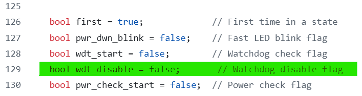

    I guess this is what they are referring to ?
    "...Modify the E3 module firmware source code to disable the watchdog timer check..."
    imagehttps://github.com/RedPitaya/RedPitaya-Examples/blob/main/E3_source_code/QSPI_eMMC_code.ino

    obones 1 month ago in reply to beacon_dave
    Ah boy, this documentation is a maze in and of itself.
    So, yes, connecting to the SSH console works (user/password are in yet another page deep down in the developer's guide)
    Then, sure, I can do that:
    root@rp-f0f9ca:~# e3_i2c_controller -r -v
    HW ID = 0x01
    Data = 0x02 - PWR_ON
    but that does not help much, and the documentation for the E3 module is not giving more information either about a watchdog so I guess it's not there yet.
